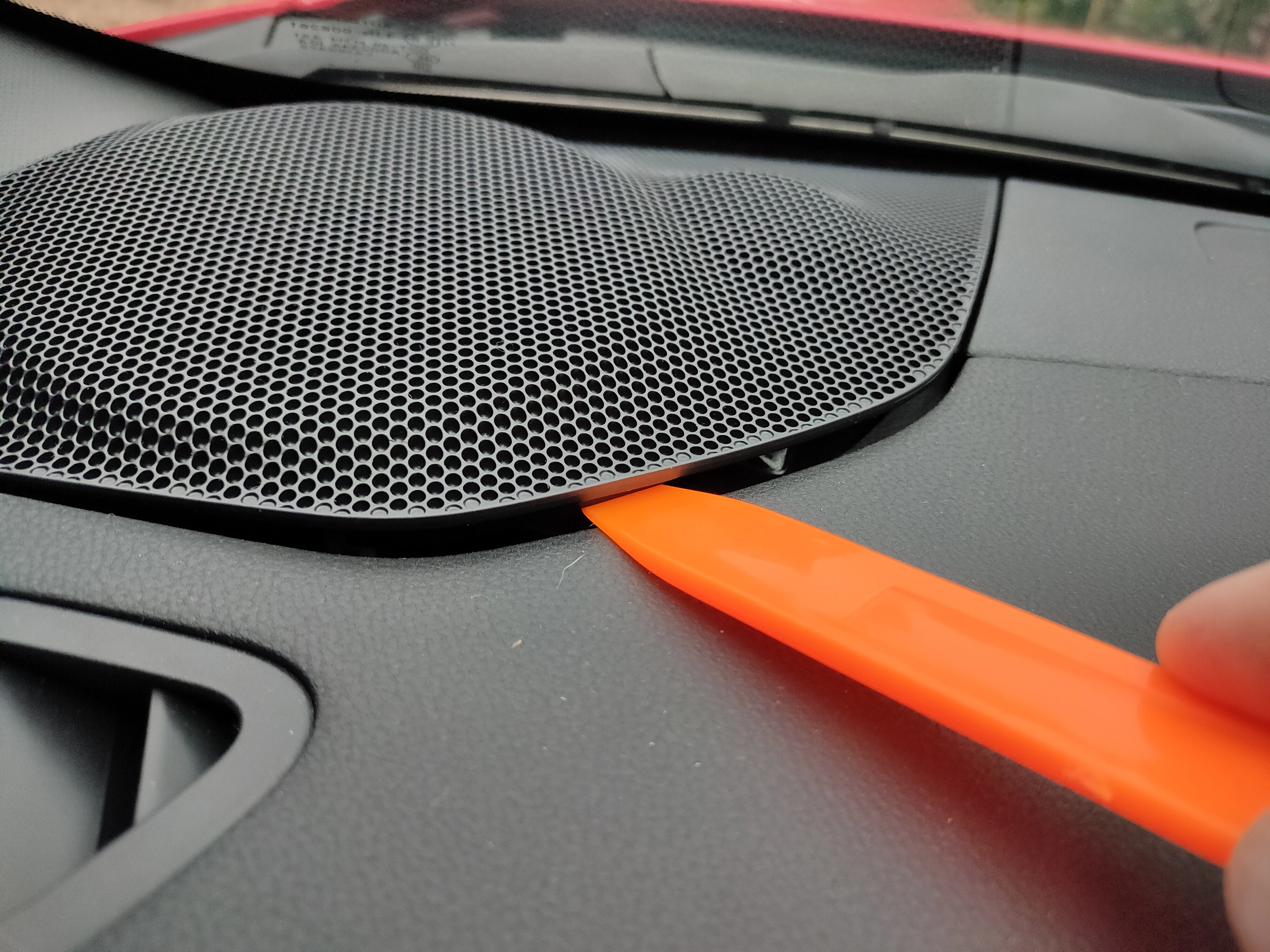

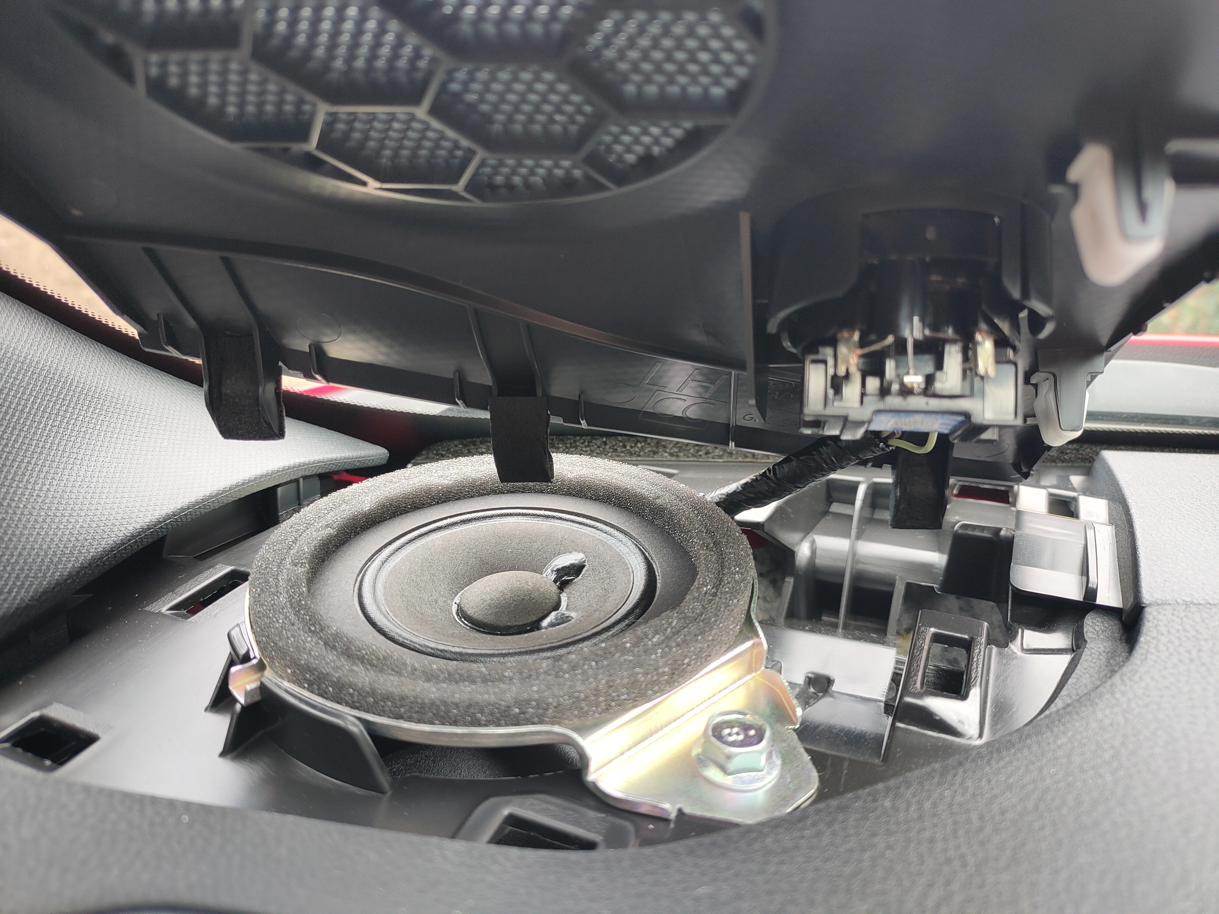

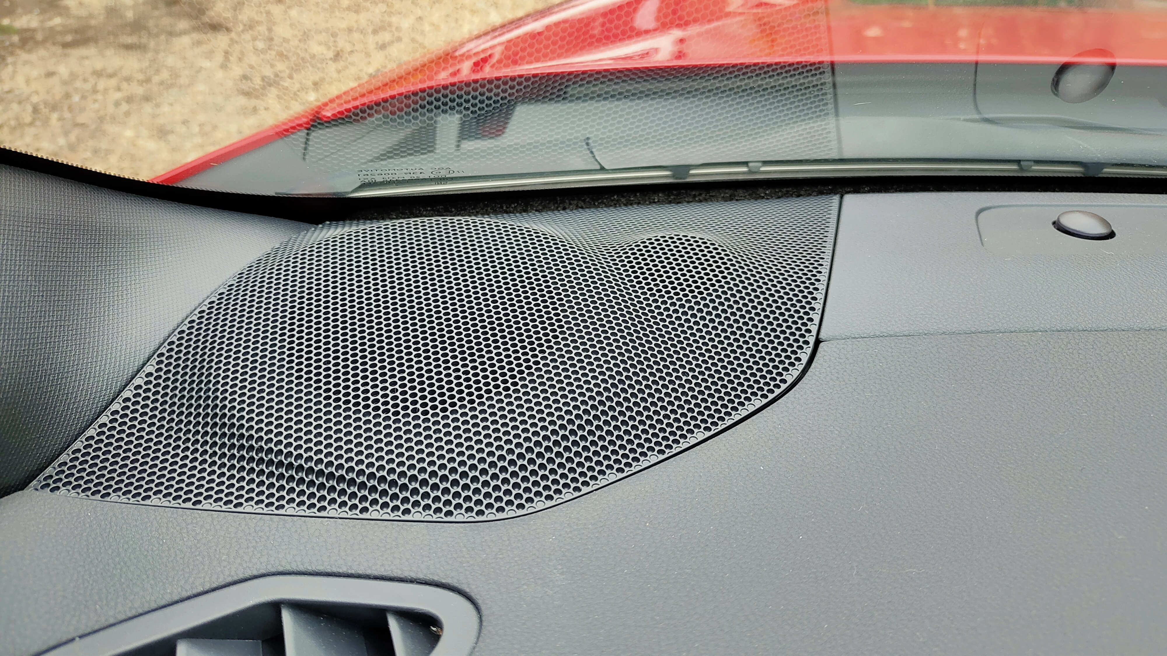

These are located behind the grilles at the top of the dashboard. The drivers side only has the tweeter, the passenger side also has the dedicated emergency system speaker that isn't part of the car's stereo so ignore it.
Pry up the grilles with a plastic pry tool so as to not damage the car - they grilles just pop off:

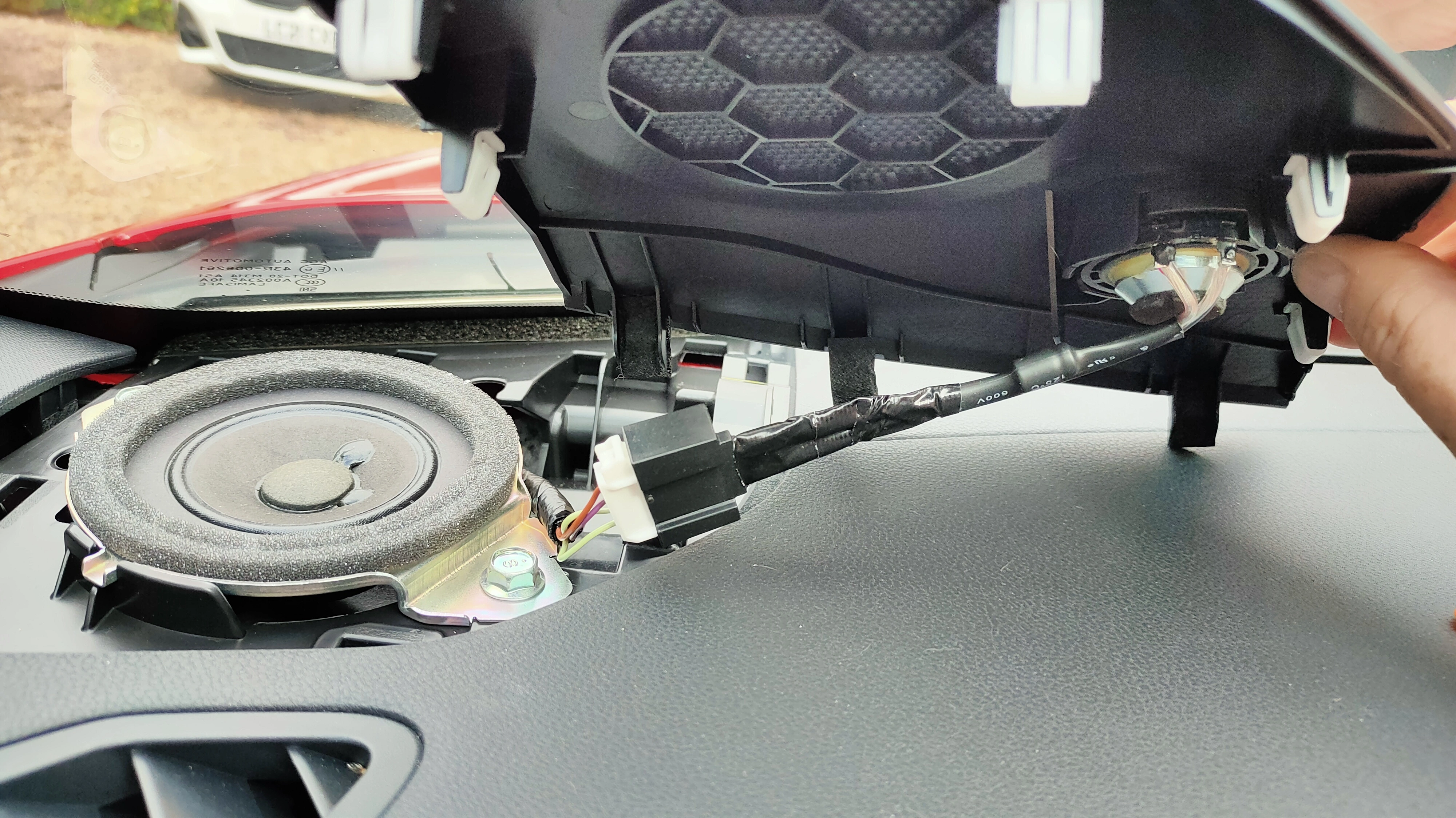

You can see the OEM tweeter here on the right:

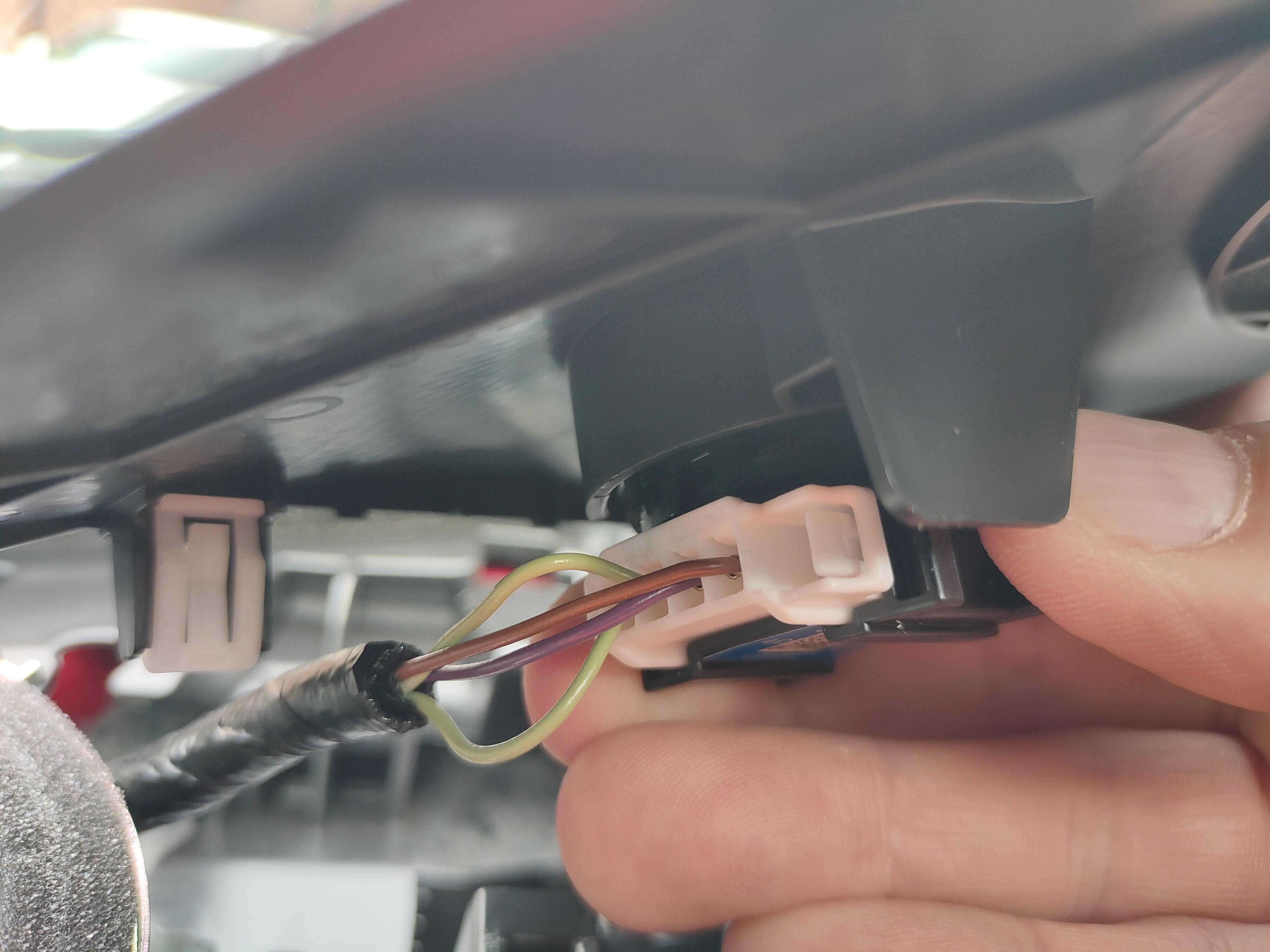

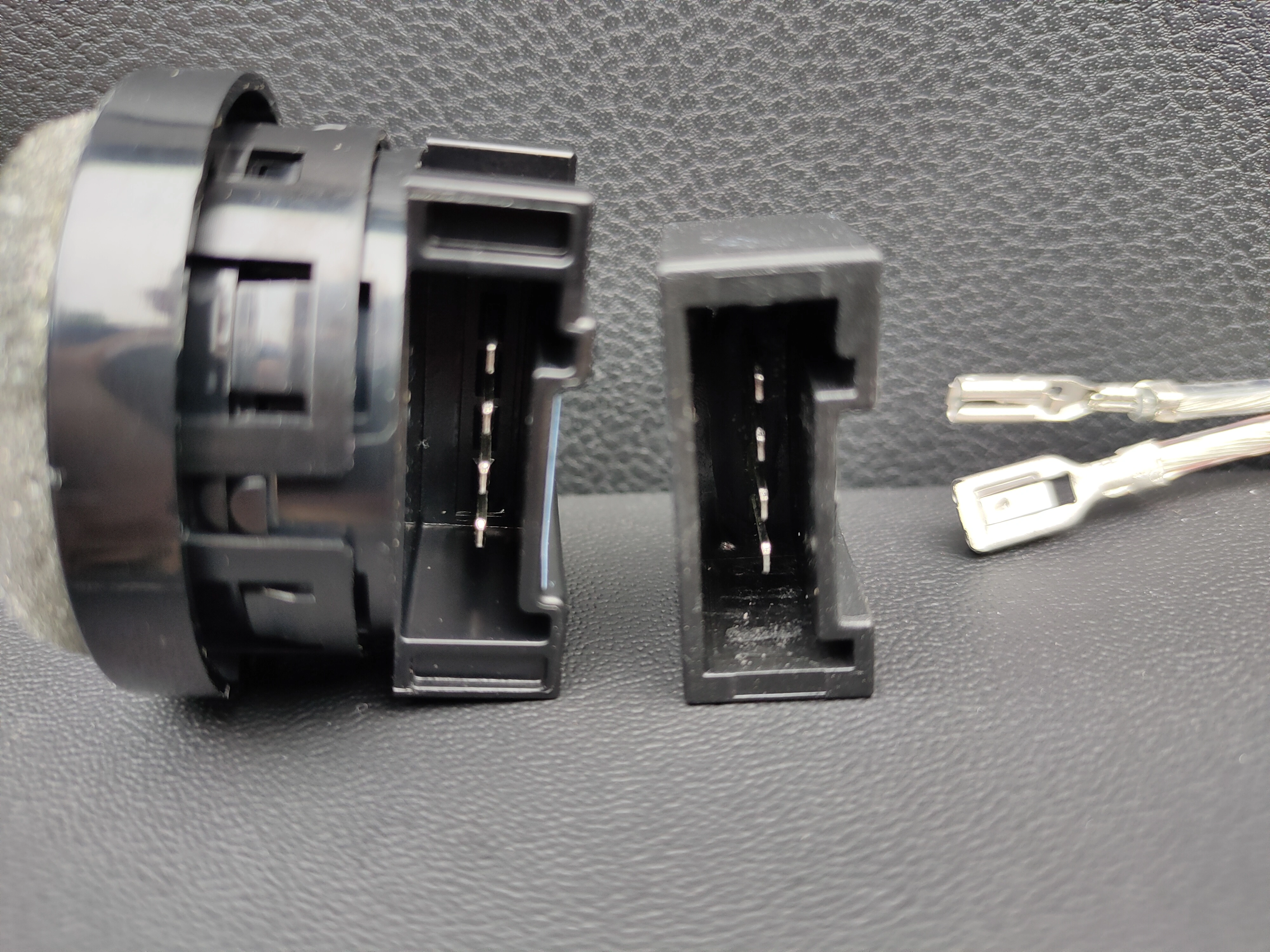

You need to push in the little white tab towards the wires to release the connector
Then you have your tweeter and grille to remove from the car

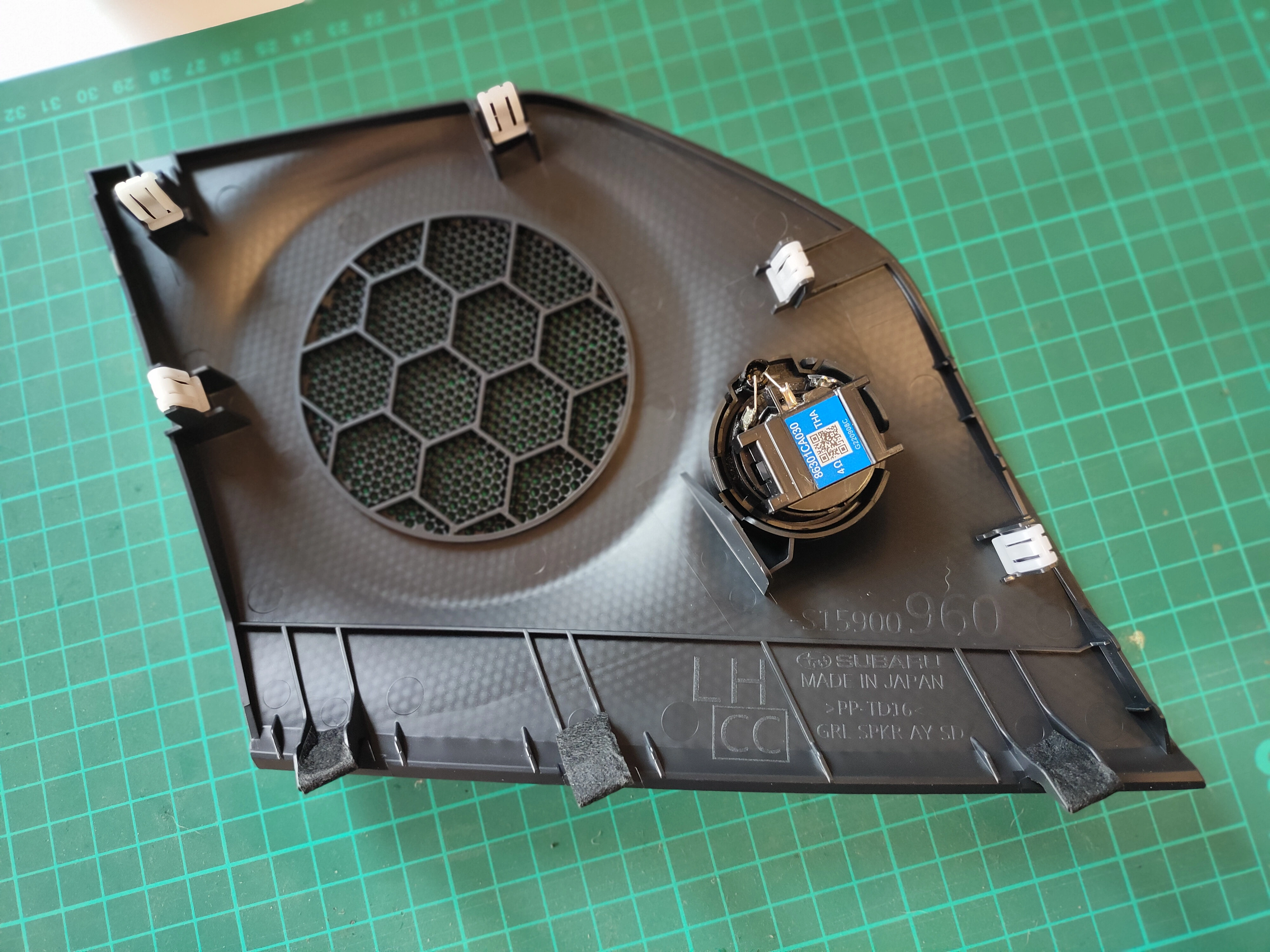

Just pop the tweeter out by pulling back the 2 tabs and it just falls out.

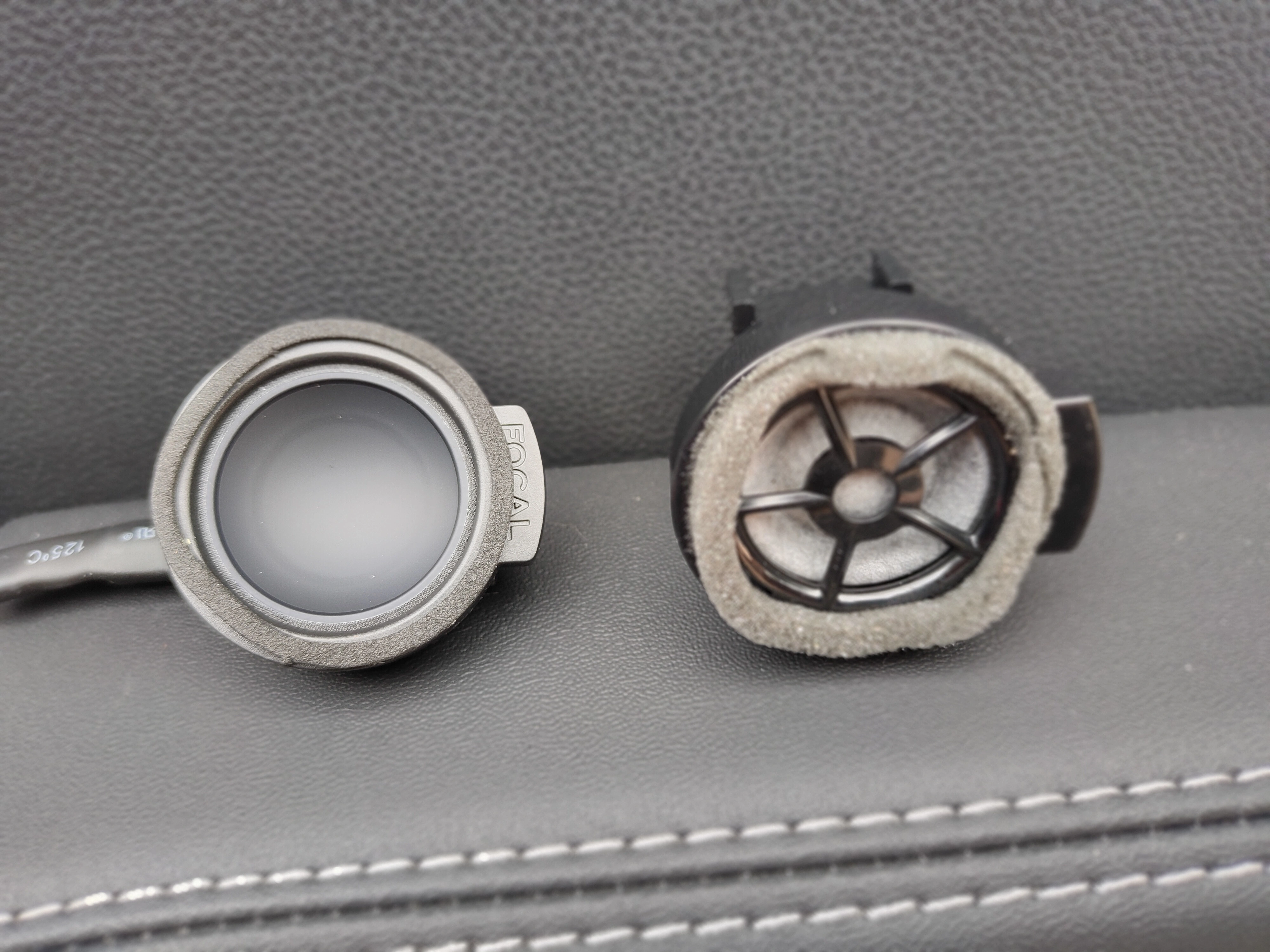

Side by side- Focal left, OEM right

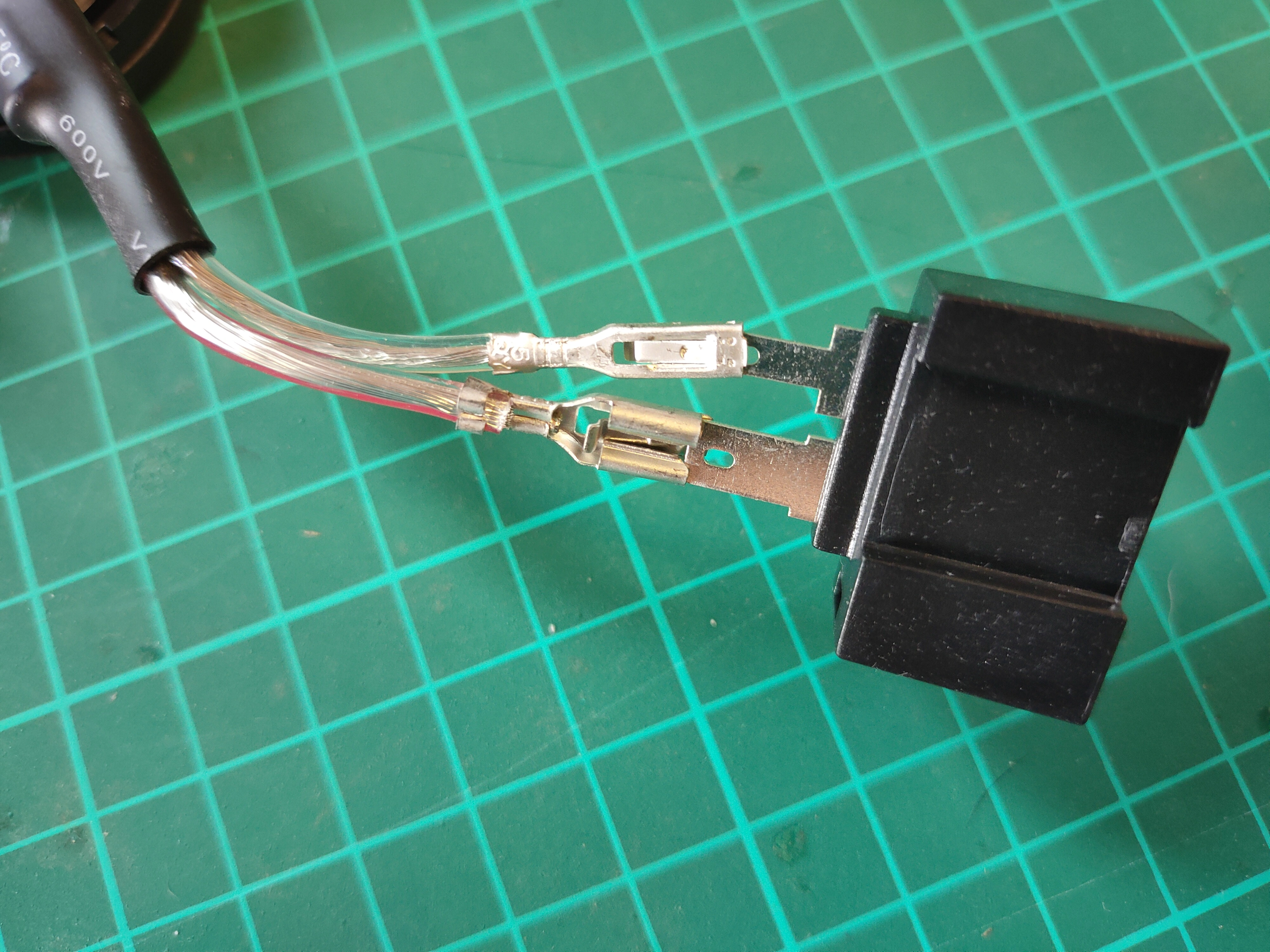

View attachment 20347The Focal tweeter is connected via the adaptor in the kit back to the cars harness so it's just a matter of connecting it up and isolating (should you wish) with your method of insulating tape / heat shrink etc)
Shown here before pushing home - it's quite obvious what adaptor to use and which spade connector goes on where
Original tweeter left - New tweeter with adaptor right
Then clip the new tweeter back into the grille cover (it's a bit deeper than the original so doesn't fully go over the end, but it felt secure enough to me as I think it located in some grooves on the side) You could blob a couple of bits of hot glue on if you felt the need.

Then relocate the grille at the bonnet end first and clip it back into place. Repeat for the drivers side
