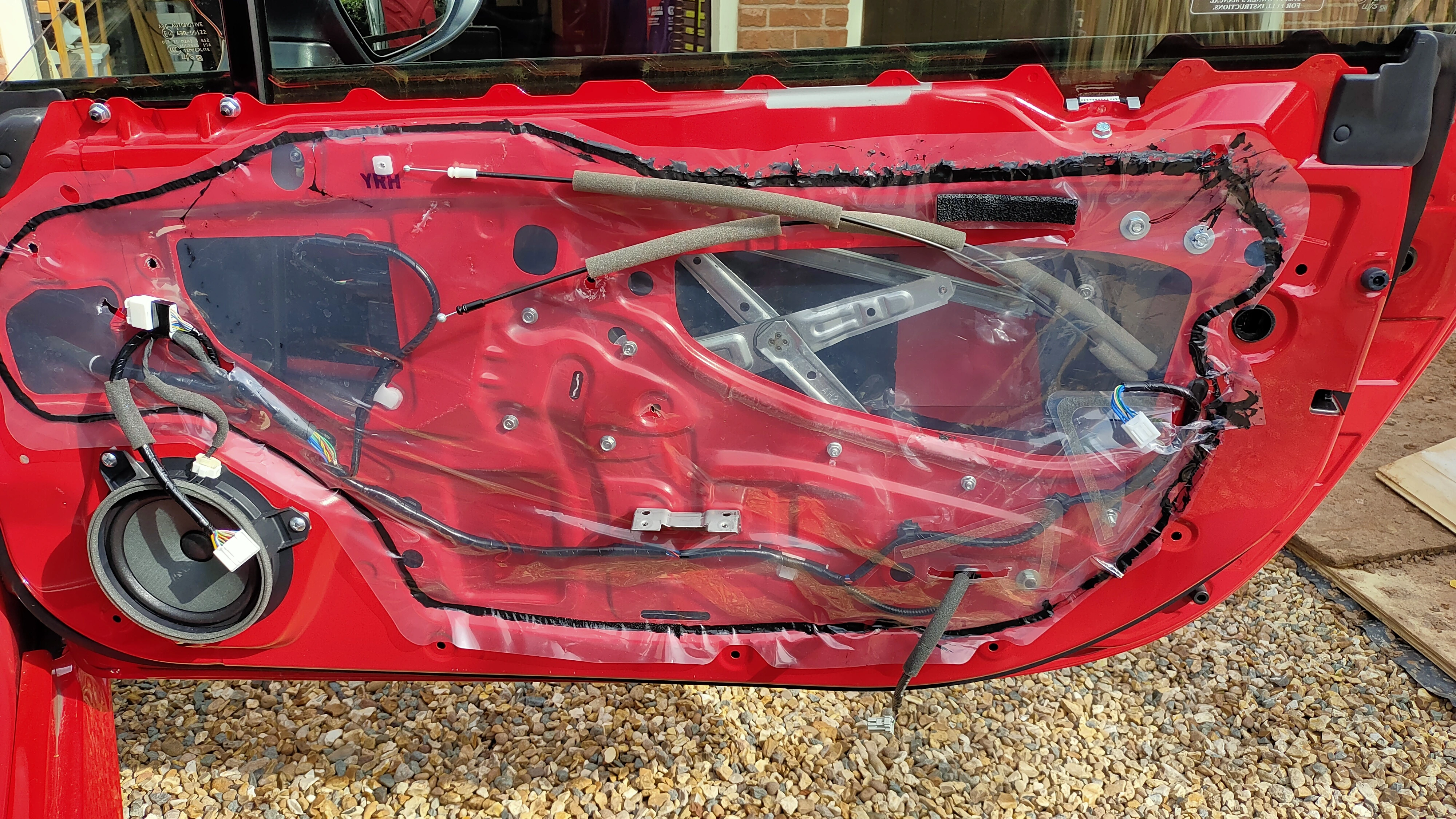

The only reason I left the white stuff is it was factory fitted, I didn't want to rip it out. Taking it out would have made it easier to fit the foam liner there, instead of sliding cut to shape foam pieces between the white liner and the trim panel. It would have been neater and a more complete job replacing the whole lot.

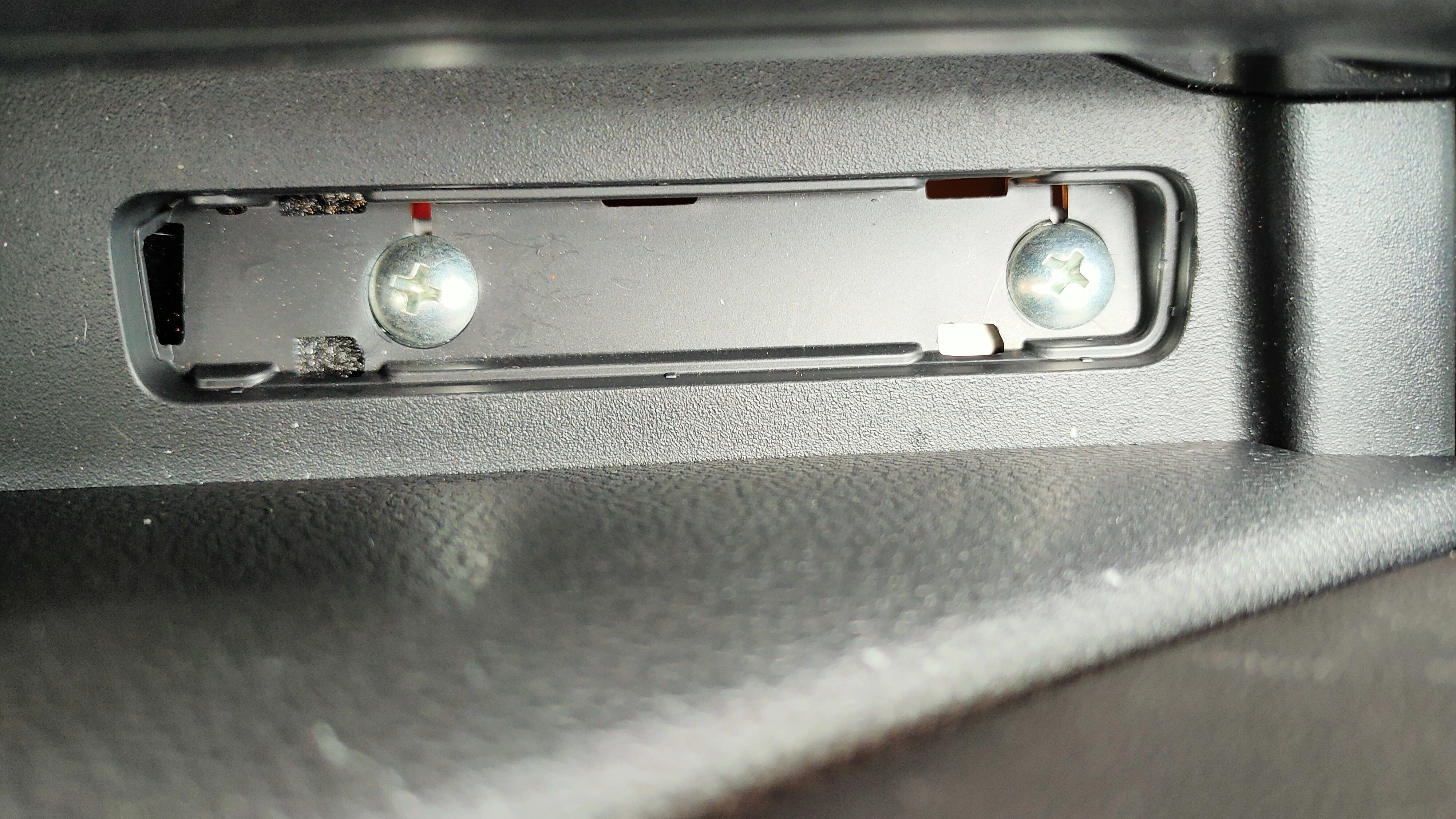

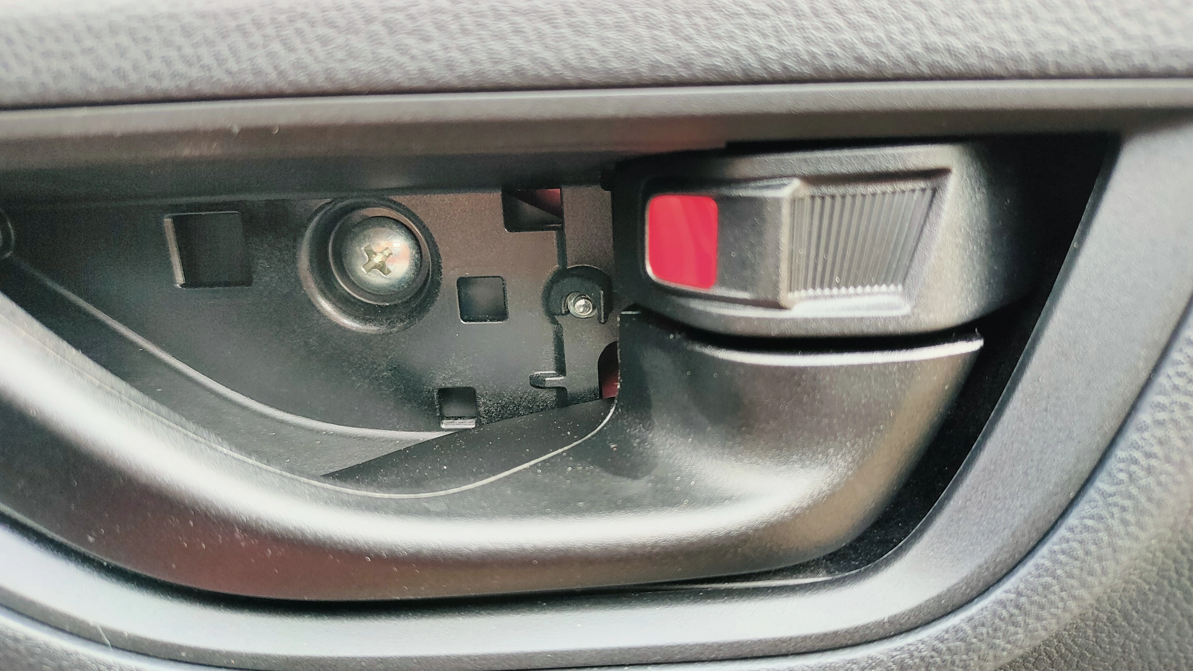

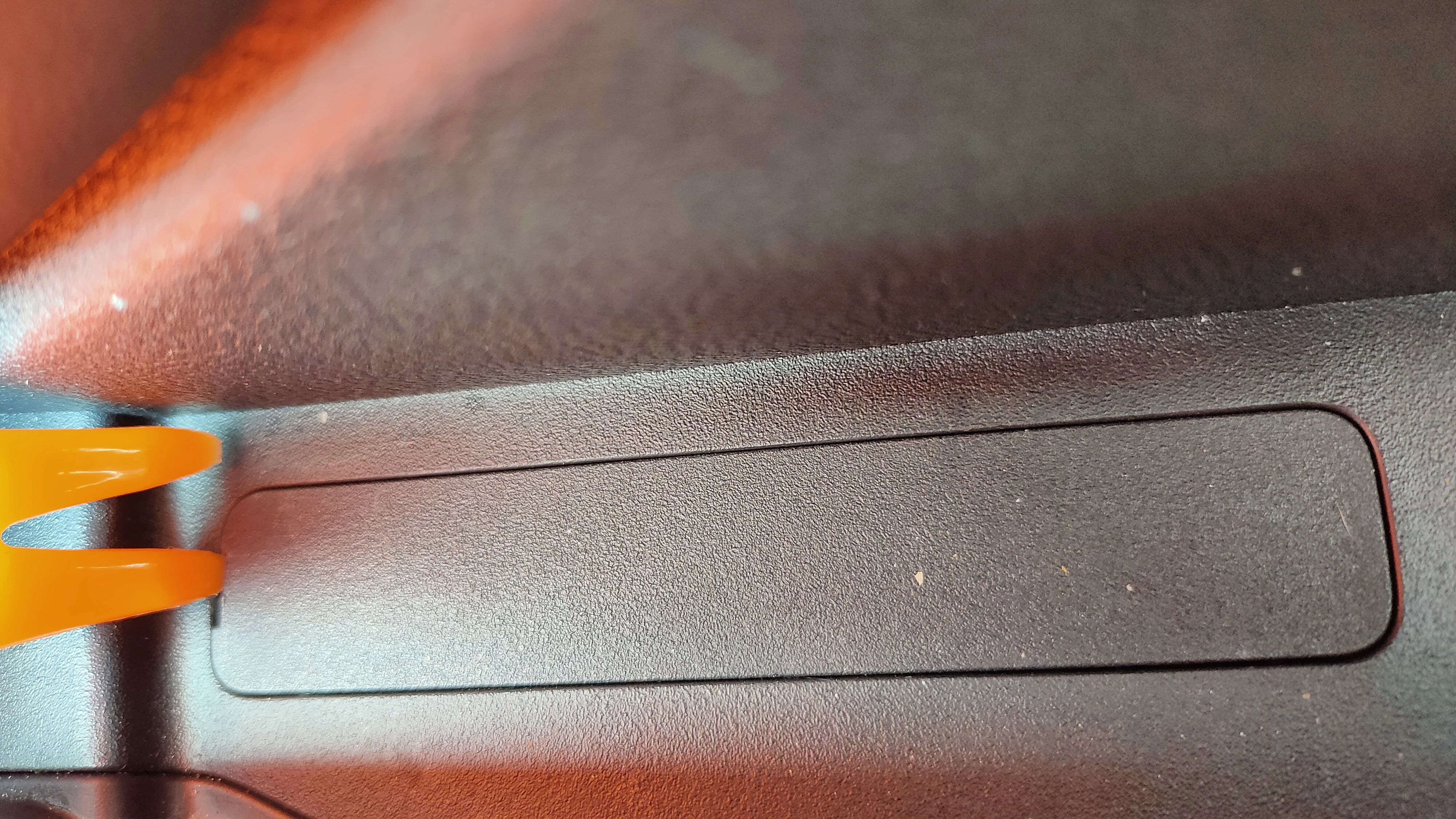

First you need to get the door panel off the car. There's 2 screws behind a little access panel by the arm rest and another by the lock / door release handle.
Undo those, then it's time for the brave bit.
I found it easier to grab the panel by the hinge and pull as you can get your fingers behind.. it does need a bit of a pull, but it just unclips. Then work your way around the left, bottom and right and pull it away. There are a couple in the middle at the front so make sure they're all popped.
You should then be able to pivot the door card from the top and just lift it off.

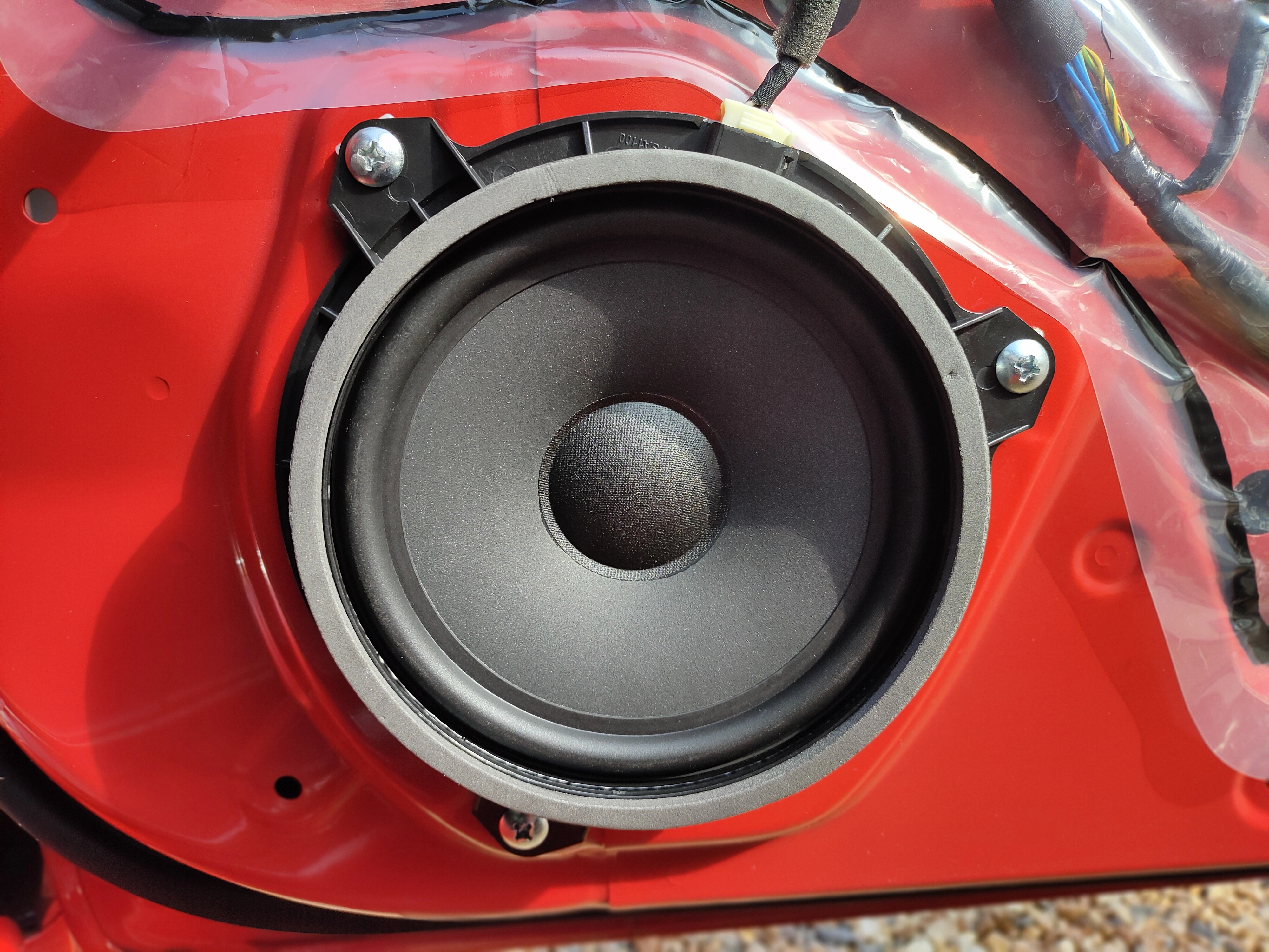

You can now get to the speaker. It's got a plug in the top which is easy to remove. Then unscrew the 3 screws and remove.

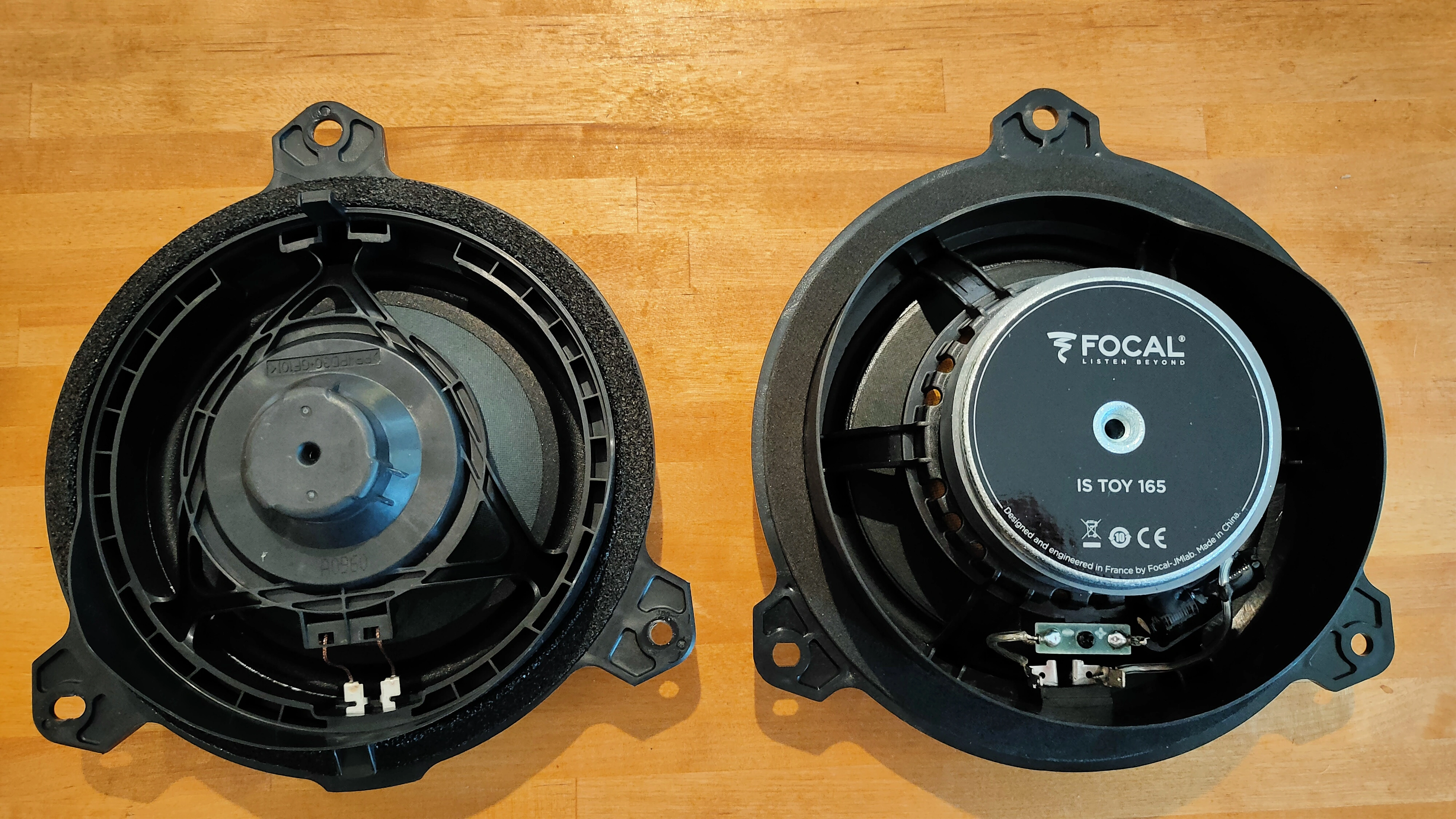

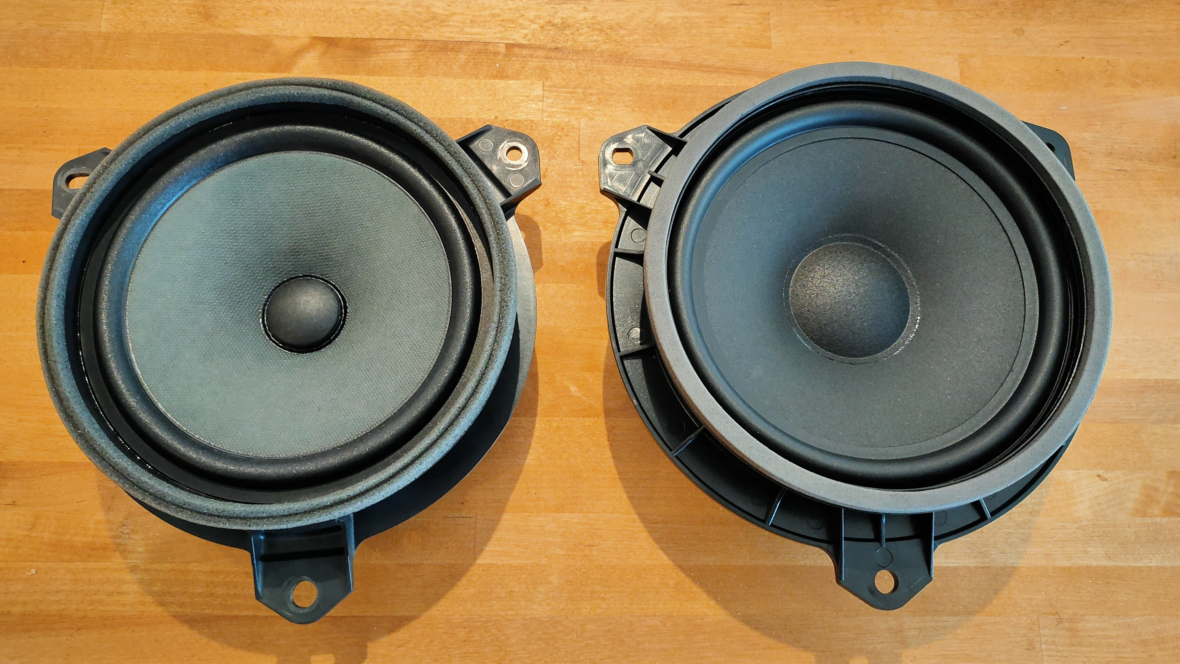

Oem left, Focal right
OEM weighs 180g, the Focal 950g as it's moving coil is much bigger.
The mounting positions are exactly the same, as are the connectors so you don't need any adaptors of any sort here, even though the kit has loads. The Focal's come with a foam mount that looks better than the OEM

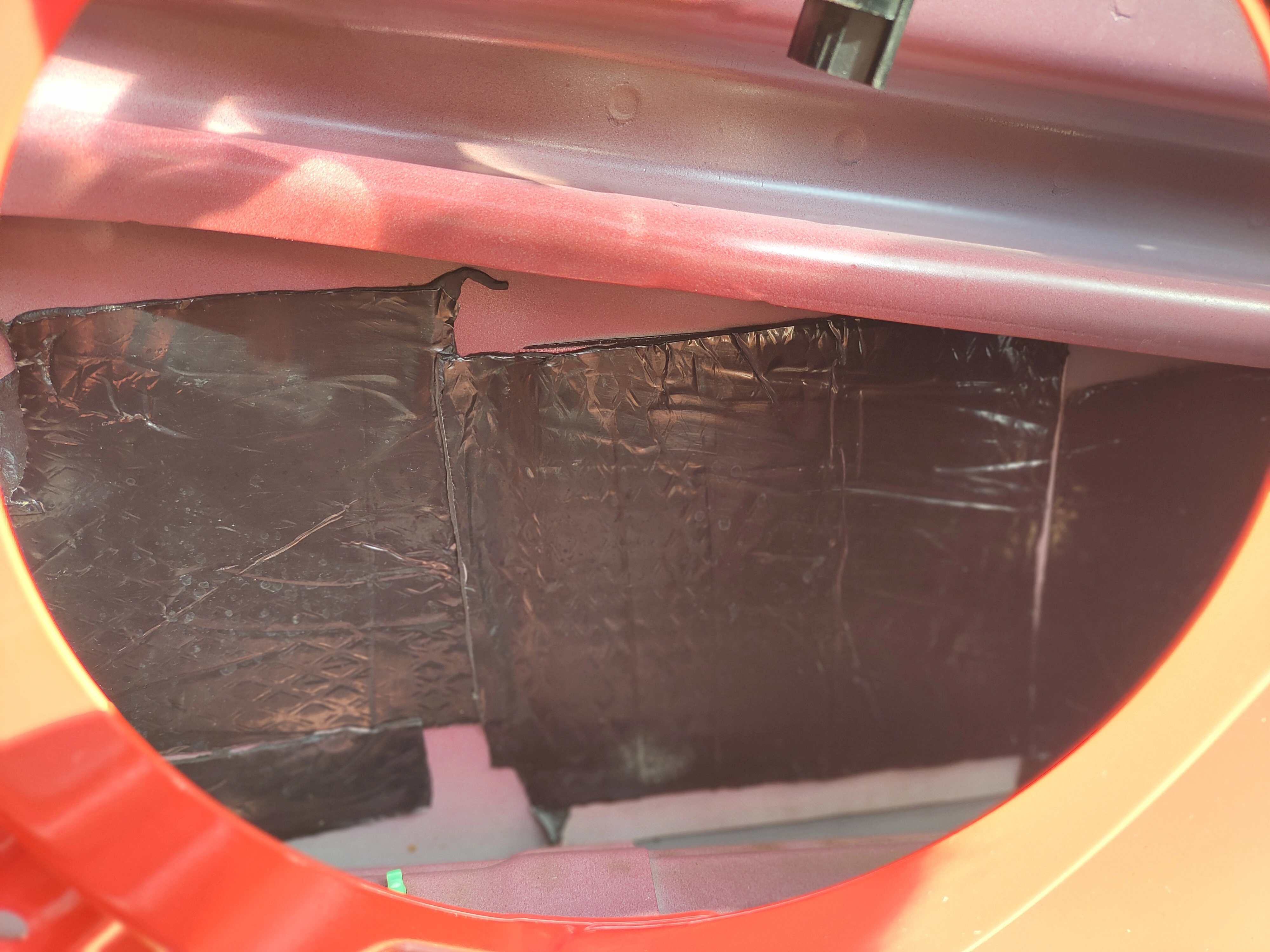

I'd recommend fitting at least some sound deadening behind the speaker as it's out.
Fit to the car using the original screws, plug it back in

Great guide thanks, just one question about the clear plastic - what’s its design purpose, and is it needed?
