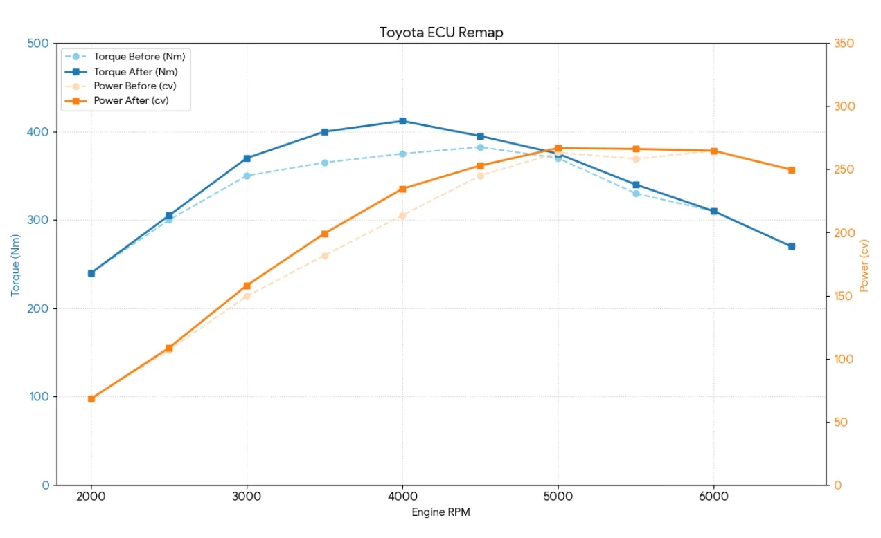

I did a non-scientific measurement, so this should at best be taken as some relative approximation of the Toyota ECU remap, not as absolute values...
It does pretty much align with the subjective feel, though... Actually I expected more power up the rev range
I did 2+2 measurements with PerfExpert and an Oneplus 15, on the exact same road, slightly uphill, then averaged the two measurements
EDIT: measurement done in 3rd speed

That boost from 2,500 to 4,500 makes it far more appealing than the original dyno pictures that Toyota originally shared which had a small upgrade from 3,200 to 4,000
