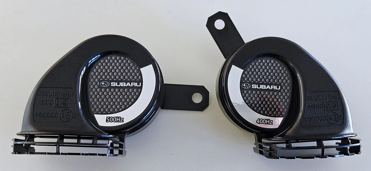

I installed the new horns today, the first decent sunny day this year. Goodness me, they're LOUD! No more meep!

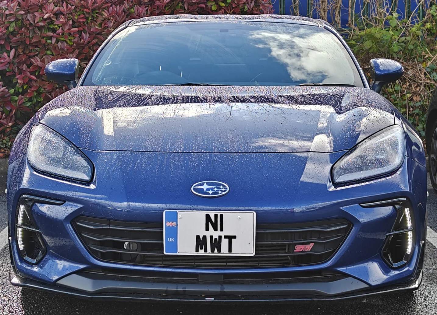

I finally got my vent-mounted DRLs/indicators installed and working. The bumper-off work was done last week and the wiring, using a long claw grabber to retrieve the cables (harder than it looked), finished today. It all works very well, but worth noting that you need an add-a-fuse adapter in low-profile micro size into the IGN2 circuit, and quite a lot of patience.
Photos later as it's raining!
