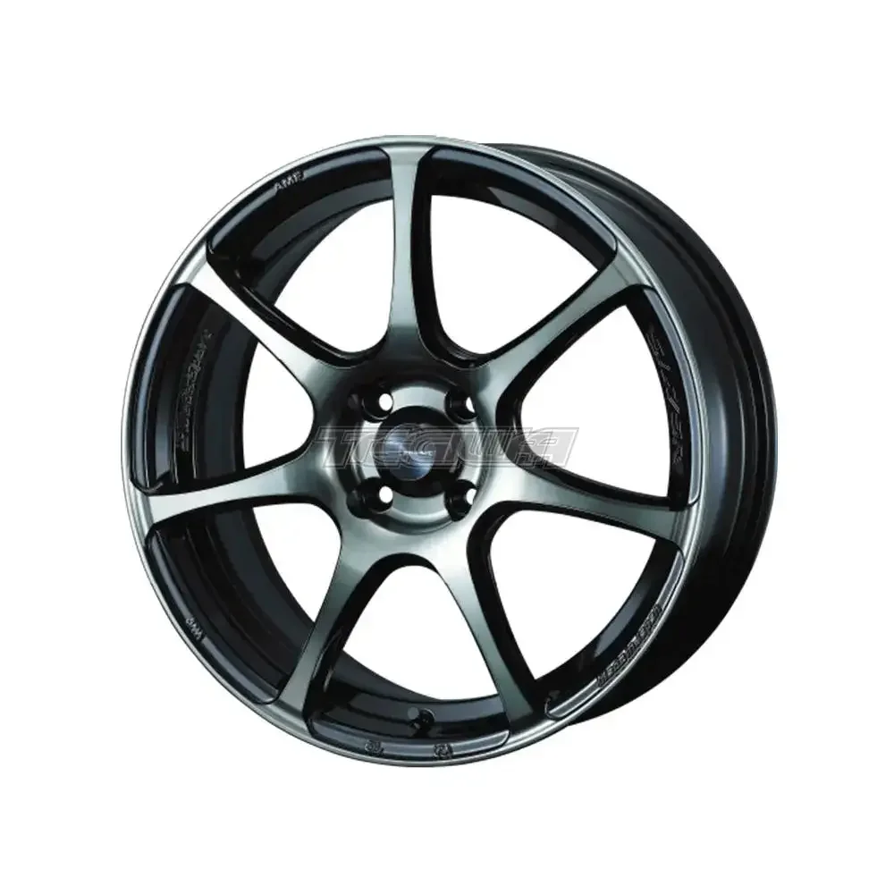

Nice Martin, good choice.Decision made - I have ordered a set of WedsSport SA-75R wheels in 18 x 8.5 ET45. They will ship from Japan so it'll be a wait, but I'm always patient with these things. They should look great on my Sapphire Blue BRZ.
I can transfer my nearly new 225/40 Goodyear F1 tyres (which are superb) and consider going up to 235/40 on the next change if I so wish.

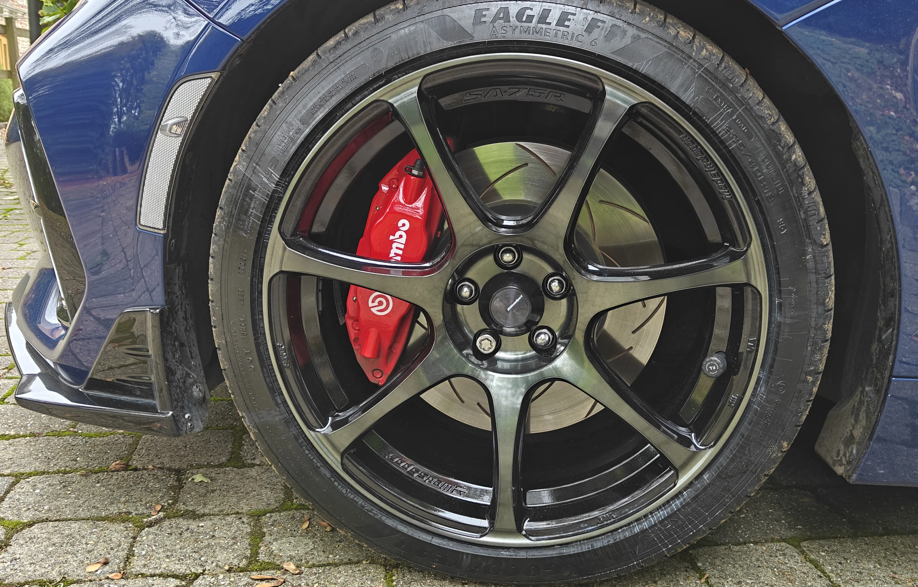

Excelent choice they will look GReatThanks. The 18 x 8.5 are 8.8kg. Compare with the stock BRZ 18 x 7.5 at 10.4kg plus 1kg for the 15mm Japspeed spacers. That's a weight saving of 2.6kg per corner.
my current setup and no complaint there , also ready for 235/40 next time i change themExciting. For your reference, an ex-owner with 225s on 8.5. He has a more aggressive 35 offset though, but you'll be able to see the tyre fit on the rims.
