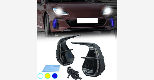

I have now received the LED DRL/Indicator vent kit. I will need a decent day to get this done on the drive (the garage is too cramped). Has anyone done these? Oops - silly me - the GR86 has a different vent design.
Reactions: sim86 and AEG86
I am interested! Which version / brand did you go for? I think there were a couple options when I last looked.
I made a start with the intention of installing the lights today, laying it all out to get the wiring running correctly. I had to stop, though, as it's a job for a sunny day that isn't blowy and with my back feeling better as a bit too much yoga put it out the other day. I shall return to it as soon as I have a better day.
