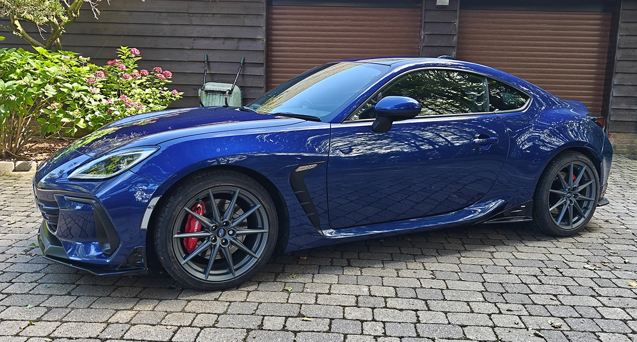

Cut to February 2025, and the great arrival. I had been tracking the Heogh Borealis on its journey from Japan using one of the commercial shipping tracking sites, and the closer it came the more excited I got. Finally, the big day arrived and it landed at Southampton.
Torque GT took some much nicer photos of the BRZ, which kept my appetite whetted until I could see it in the flesh.
Before I could get my hands on it, there was UK DVLA inspection (IVA) and registration (V5C) to perform. The only item required to pass the IVA was a speedo in MPH, which consisted of a neat dashtop GPS digital speedo requiring only power. No MoT is required as it's less than three years old.
Finally, Torque GT asked me what other work I wanted done before collection. I specified for them to change all the fluids - engine oil, coolant, gearbox oil and diff oil. This was to start off with a known base despite the car being young. I also asked them to ceramic coat it. Then it was ready for me to take the long train to Newton Abbott and be collected by Darren for the short drive to Torque GT.

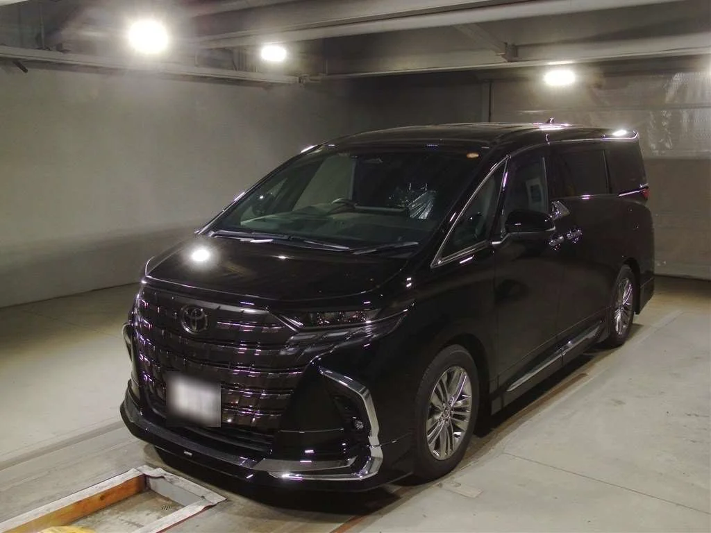

Are you sure it didn't need MOT? I've been told that because its an Import you need SVA and MOT for first reg purposes. I'm importing a 2025 Alphard at present, will sail from Kansai 1st Sep.
