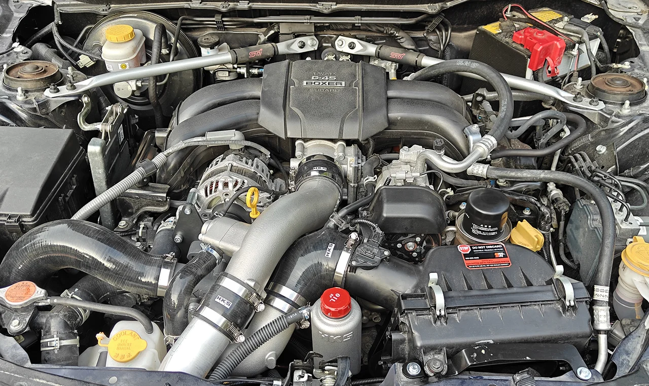

Interim report from Fensport
They have opened up the restrictor hole to 44mm, giving 276g/s airflow with the injectors running at 66% duty cycle. This is producing 0.7 bar of boost, or 10.1 psi. They need a bit more dry road tomorrow and will eke out some more airflow and duty cycle before I collect it in the afternoon. To be honest, that's even more boost than I'd hoped for already. The good news is that the car is responding to it well, so all the exhaust mods were worth it.
Now i know why everyone was nagging me for an update an hour after i got my car tuned. C'mon, spill the beans!
The HKS supercharger installation is complete. Fensport did a superb job of installation and tuning.
Tuning Essentials
Final restrictor hole size 45mm
304g/s peak airflow
Injectors running at 70% duty cycle max
Boost 0.72 bar = 10.4 psi
Power 380bhp, 323whp (approx.)
Driving Notes
The immediate driving experience is exactly as with my previous two superchargers (Sprintex, Harrop), essentially feels like a 'bigger engine'.
From just under 3000rpm, pickup is strong and continuous in a virtual straight line ramping up to the red line. There are no dips or glitches, just continuous pull.
On the road, it drives as before when taking it easy in suburban areas. On the open road, it's a different entity as soon as the pedal is pressed further, revving keenly and pulling strongly in any gear, even in 6th and utterly animal-like in 3rd. I've set my rev warning at 6500rpm so that I just have time to change gear before hitting the limiter.
The sound is a whoosh of air quite like the Harrop, with the overrun making a different tone of whoosh (possibly the bypass).
It's a beautiful installation, OEM-like in quality and running in an OEM-like manner without any idiosyncrasies that I have noticed.

That sounds great, I was not expecting that much whp from it. I bet it feels much faster.
Did they say anything about the clutch? Are you going to get wider tires? Did they remove the cold start?
Neither was I. Yes, it feels a whole lot faster (and it wasn't slow before).
They said the clutch should be ok but if it fails I will have an Exedy stage 1 installed, the same as in my old BRZ with the Harrop supercharger. No, I think the 225/40 Goodyear F1 on the stock 18" wheels have a good level of grip and I'm trying to retain the balance between handling and ride quality. The MCA traction mod definitely gives me more rear wheel grip and the STi springs are just right for the car. The cold start is minimised and only lasts about 20s.
