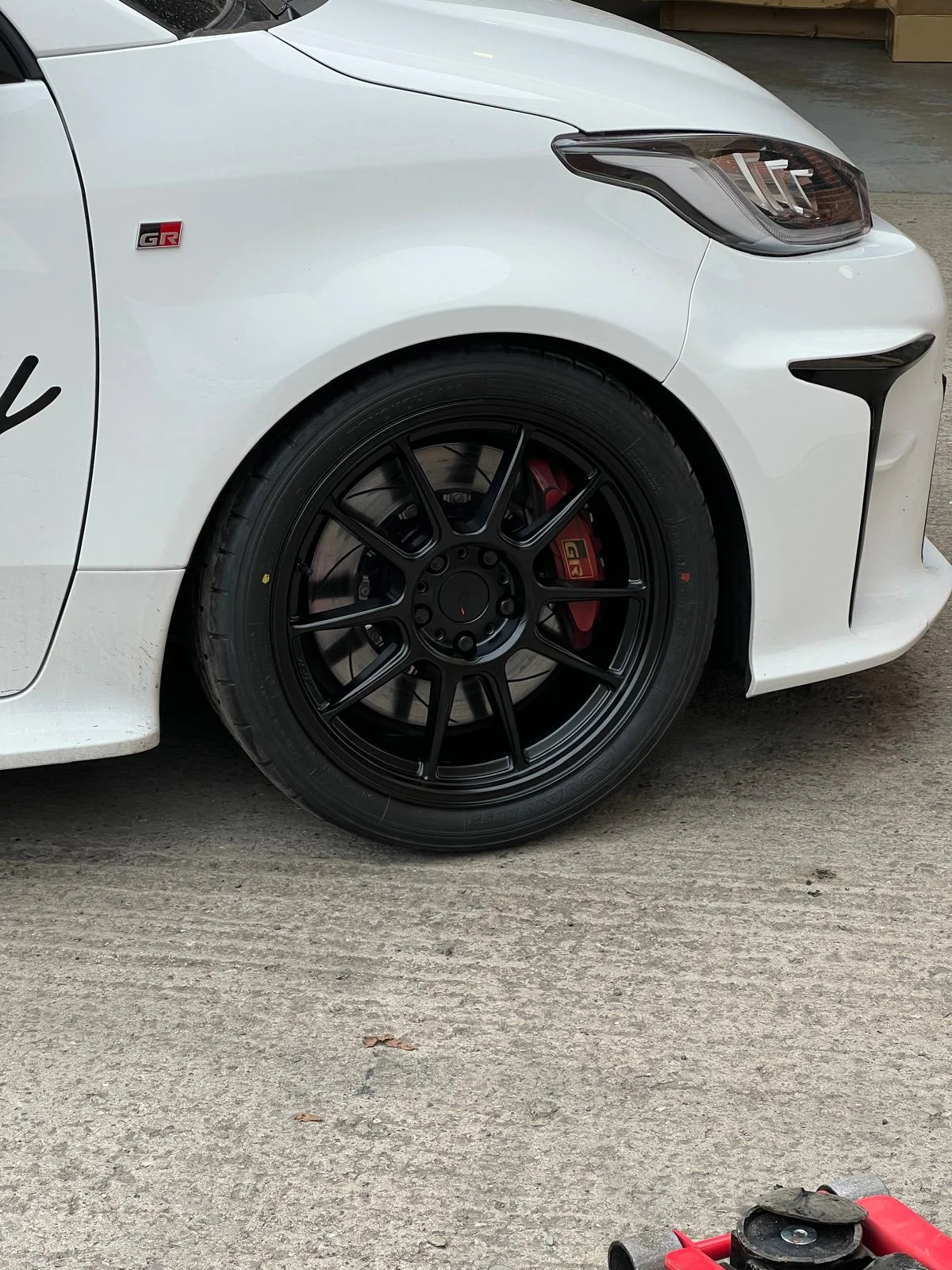

Intermediate stage with 18 GramLights 57DR
Hi everyone, I’m planning to switch to Enkei T6R 18x8J ET40. They don’t come with wheel nuts, so I’m looking at getting Rays 17 Hex ones. Would 31mm length be enough? and how about the spigot rings seems Enkei doesn't have 72.6mm to 60.1mm?

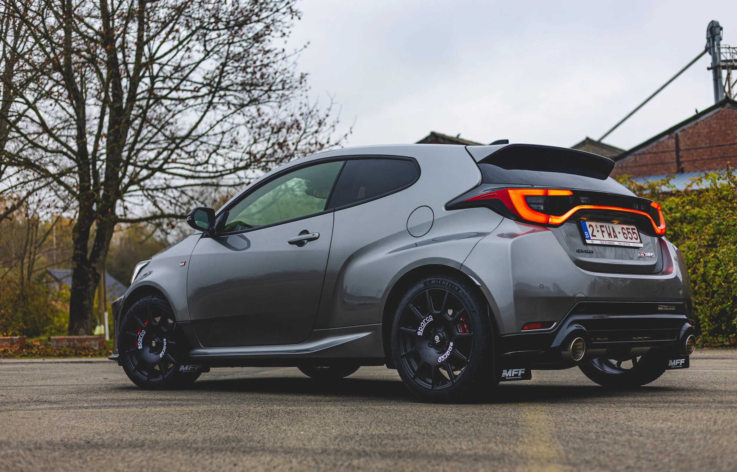

18 x 9" ET35, Laced with Yokohama AO52 255/35R18

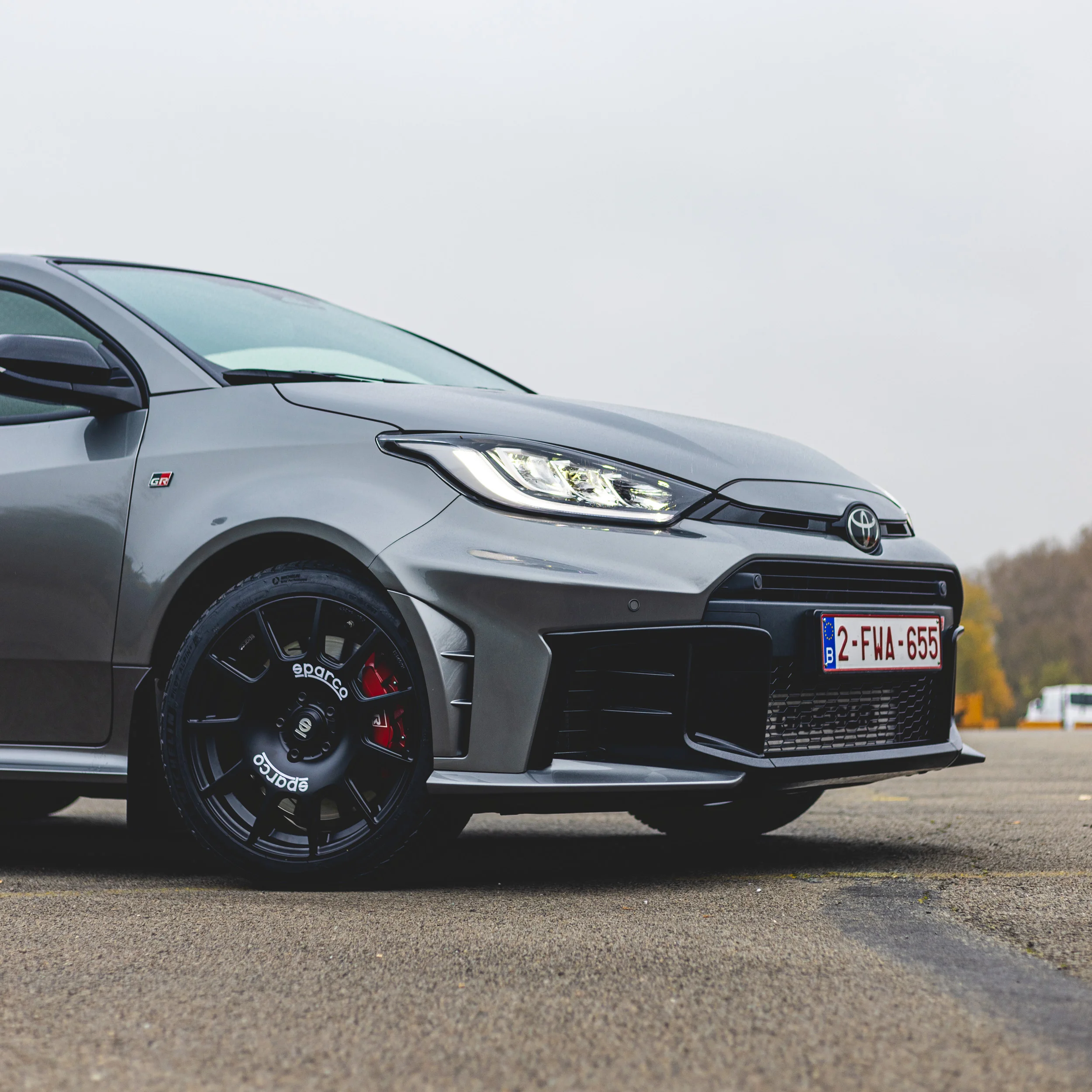

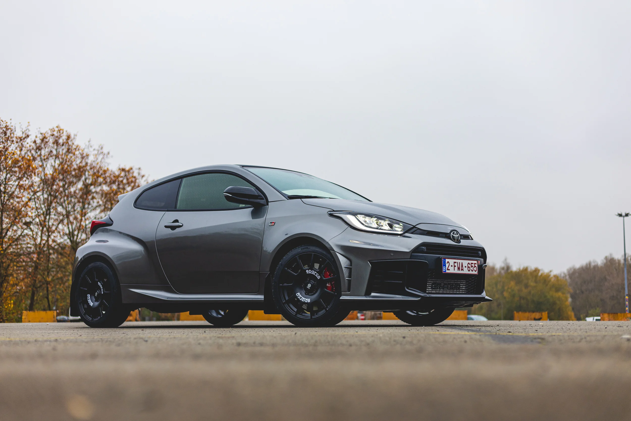

Evo Corse offer plenty of rally style wheels as well, we have previously had MonteCorse and SanremoCorse fitted to our car.

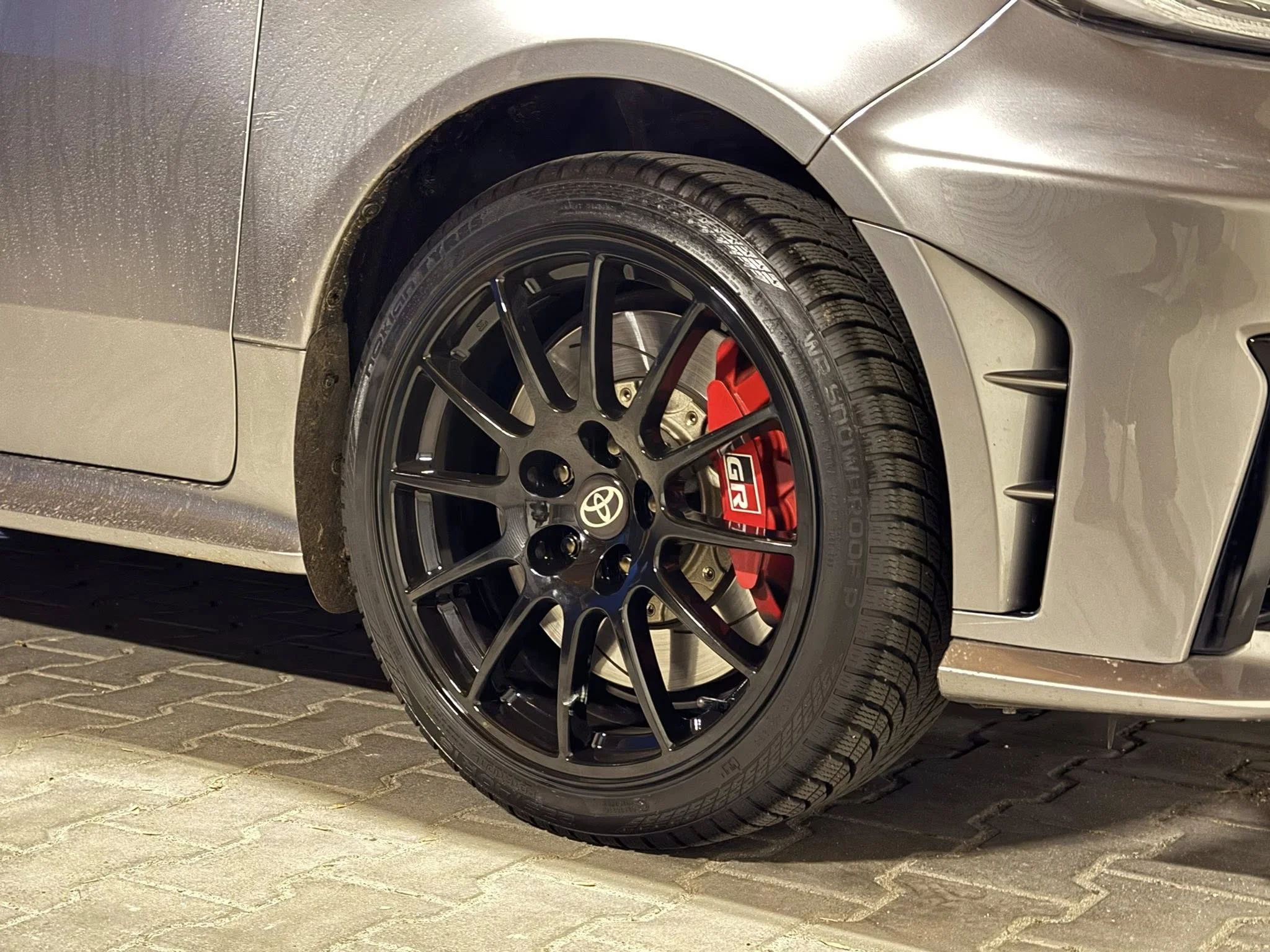

18x8.5 +38 EVO X Enkei painted black - lovely fitment on stock suspension and ton of brake caliper clearance + you can use oem high quality nuts which is a huge bonus for me. Tire is Nokian WR 225/40 18

Thanks ! I've always wanted EVO IX MR wheels or X wheels for my GR Yaris. I've sold my set of Arcasting ZAR this year and started hunt for those - It was kind of bucket list mod for me for a long time and I'm glad I did it - they came out great :)
