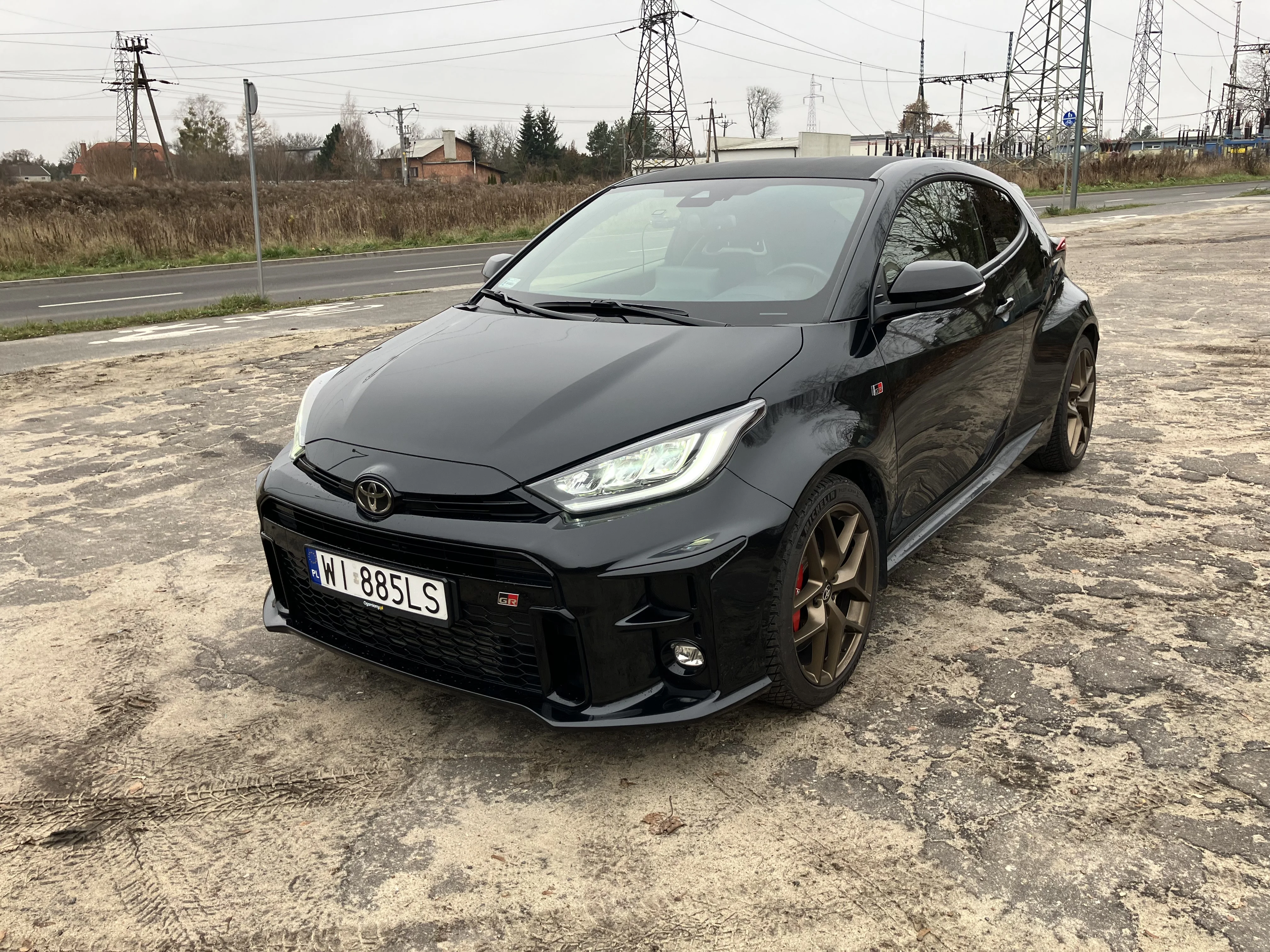

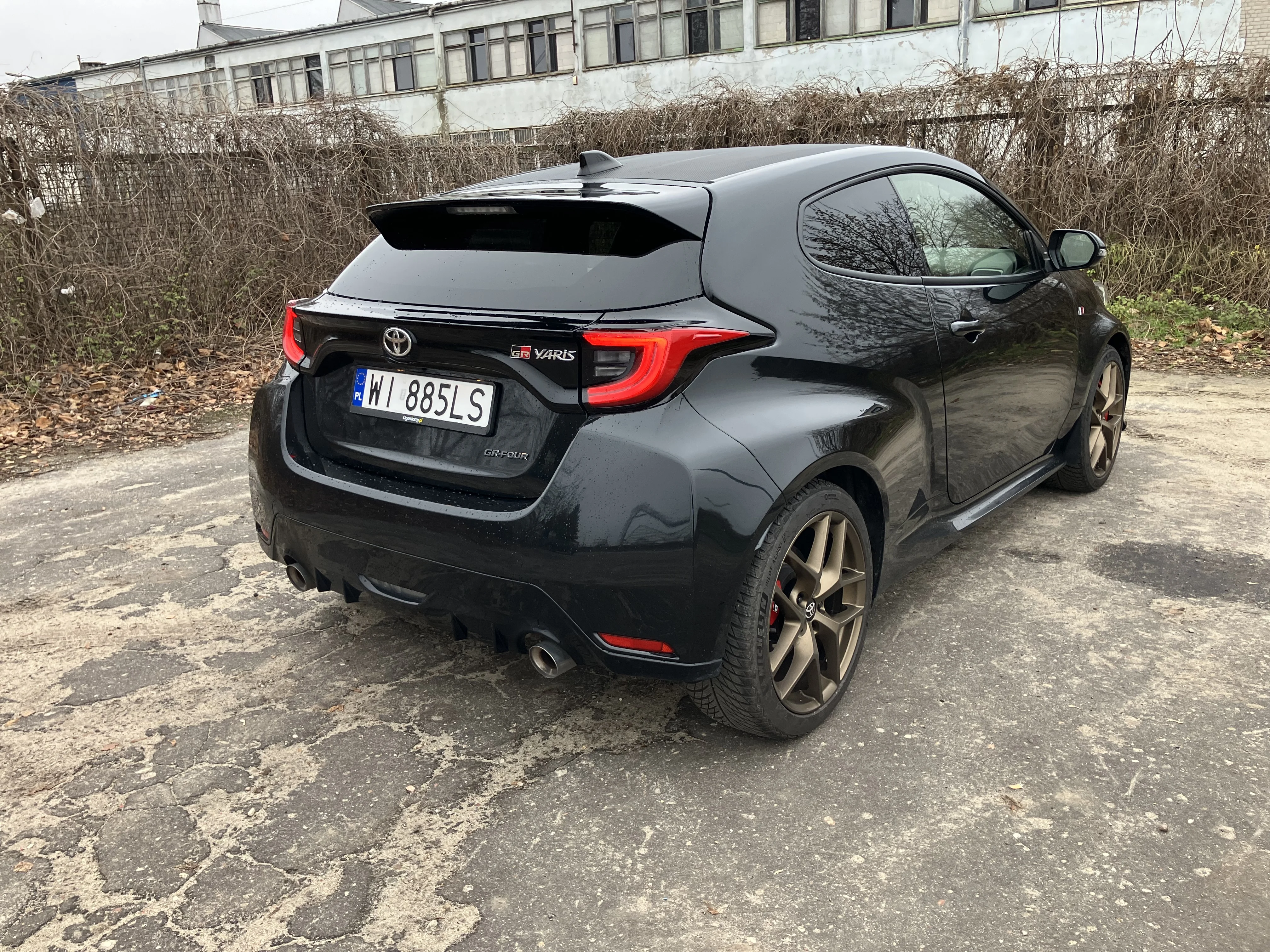

It was important to me that the rims and the 255 tyres were lighter than the original ones, and after a long search, I finally found something that suited me.

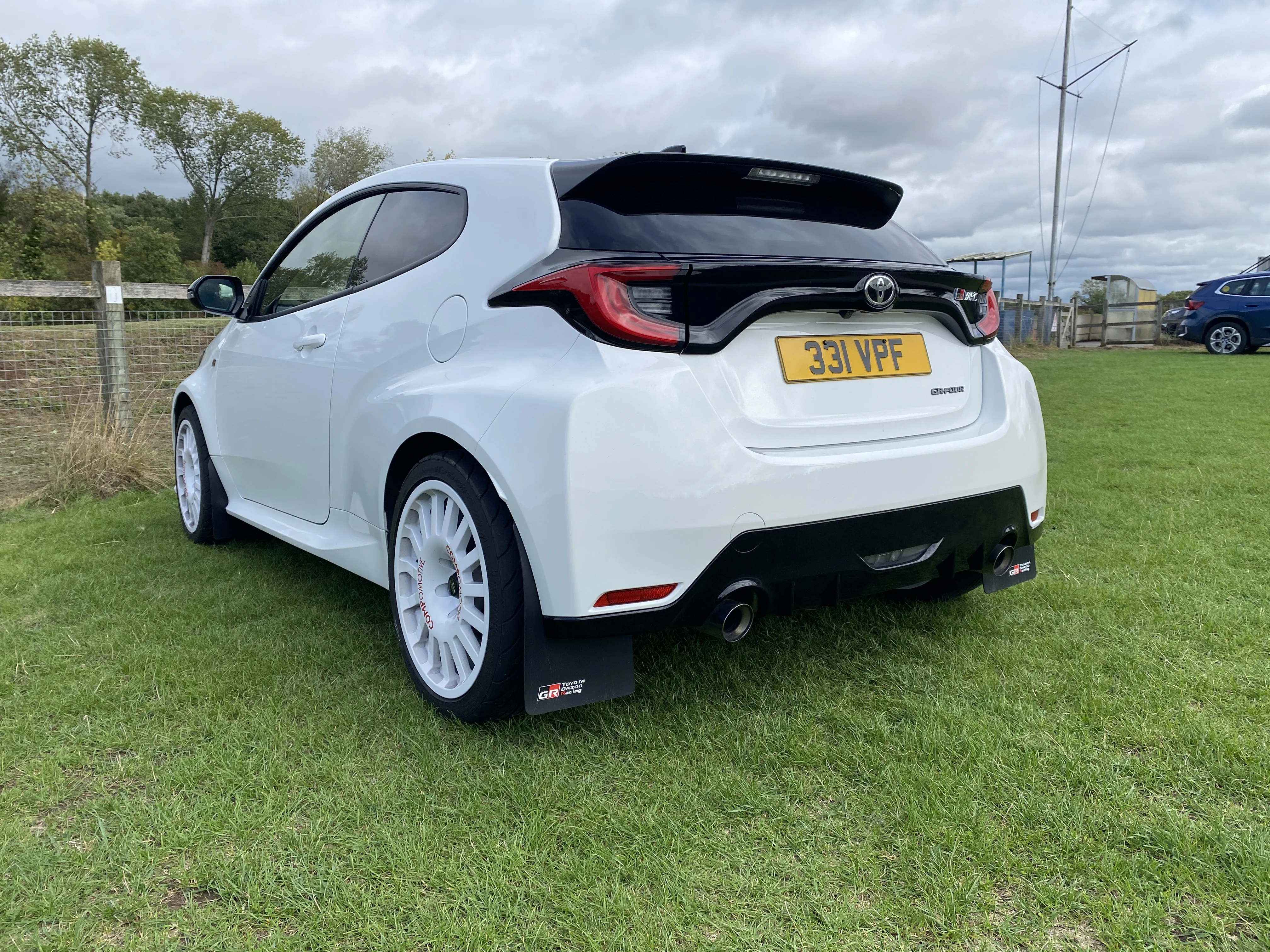

Depends on your needs really. I went a little heavier and don't regret it. My decision was taken on the b-roads over here and the harsh winter. So went with a durable but slightly heavier proper Rally wheel that's significantly cheaper to replace than the eye watering cost of one of the OEM BBS forged ones. If I was using the car for Track work I would look for a lighter/similar weighted rim mind.

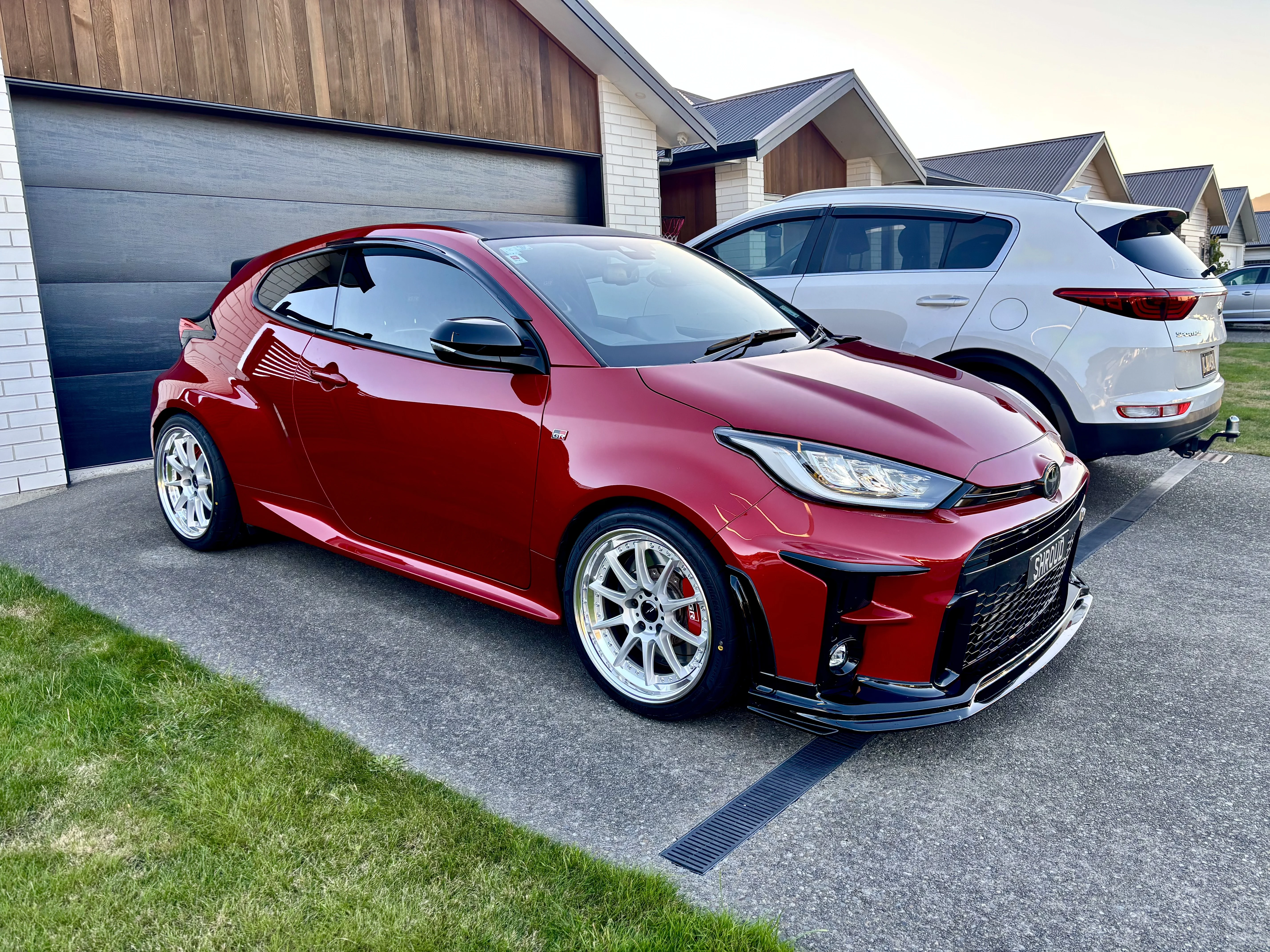

Advan R6 , 18” 9.5J Off 45
Paired with Advan Ad09, 255/35/18
With eibach lowering springs, zero rub lock to lock

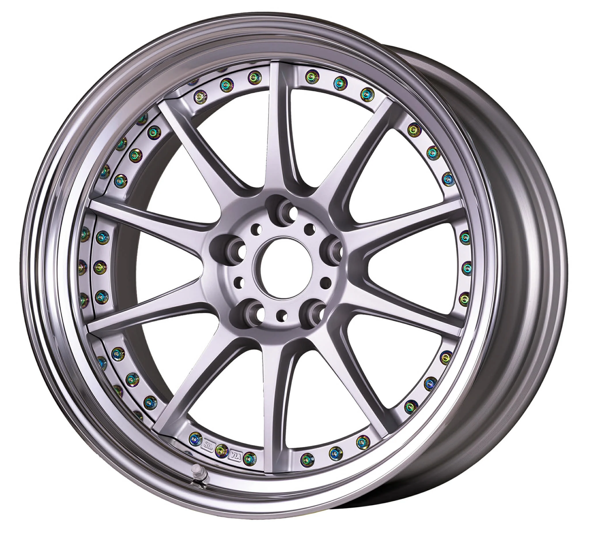

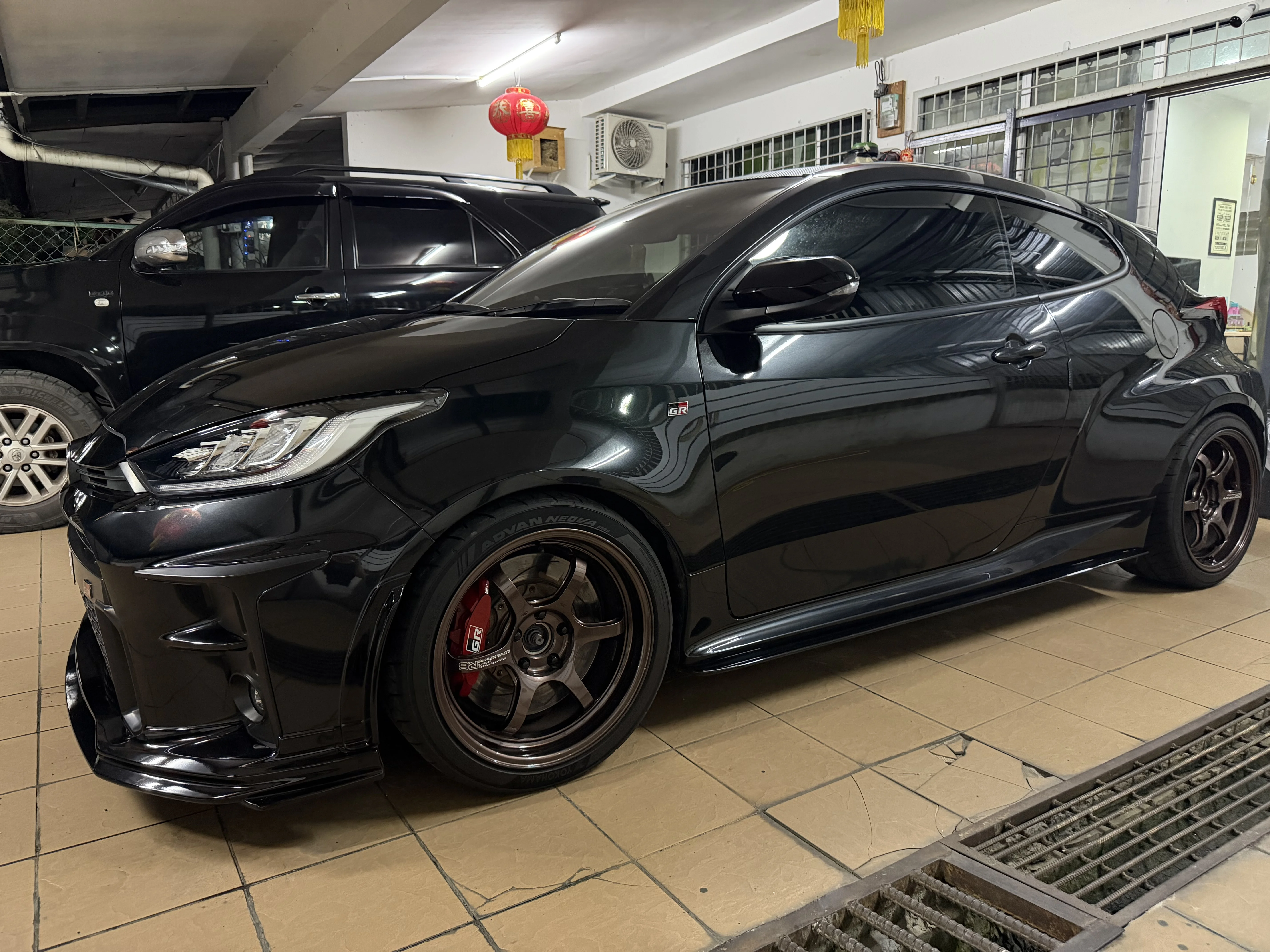

My new wheels, 18x9.5 +37 Work x JDMC GTX. Should be here in a couple of weeks hopefully.
Going from 18x9 +30 Work CR Kiwami.
