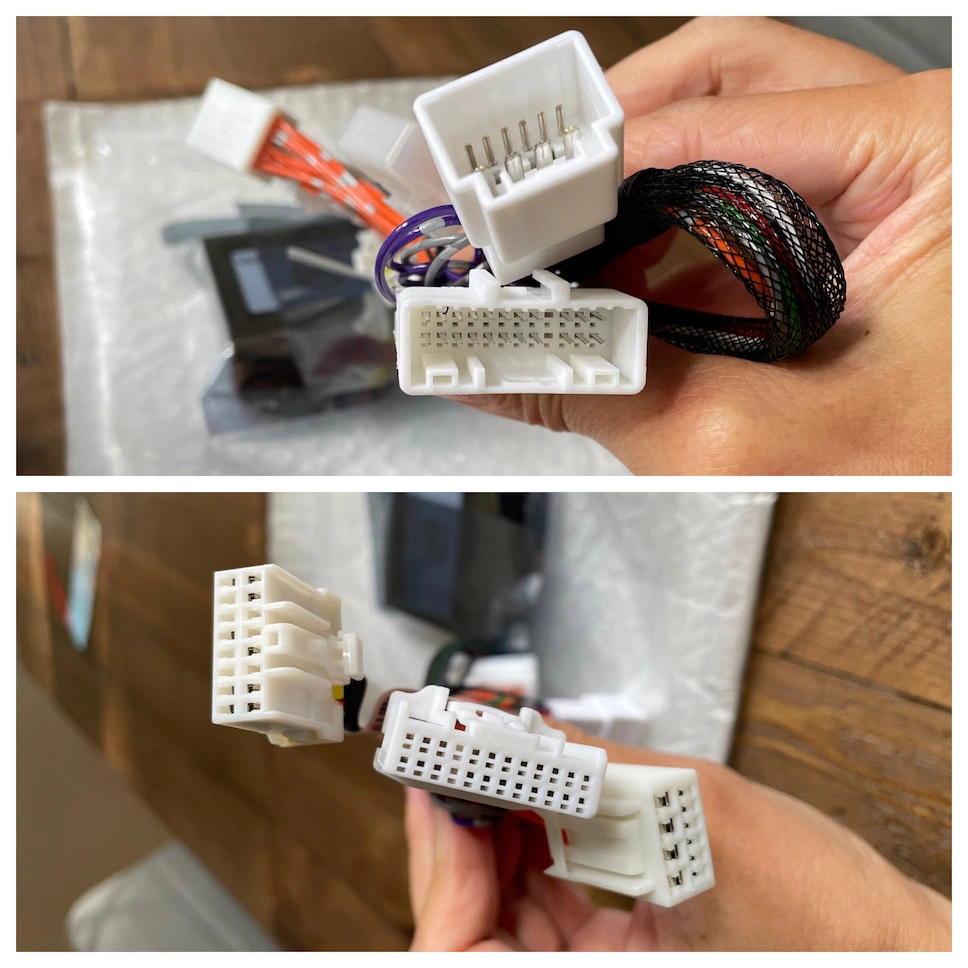

Here's the connectors for anyone who knows.
They look right for the connectors, but misquote Eric Morecambe, they're all the right pins, just not necessarily in the right order.
Good luck, really hope it works
Can you send pics of the loom, so I can compare the wire positions to the AliX one I got.
Did it work at all or just a dud? All the AliX one done was click a couple of times, which to me meant the unit was supplying power to do the window closure.

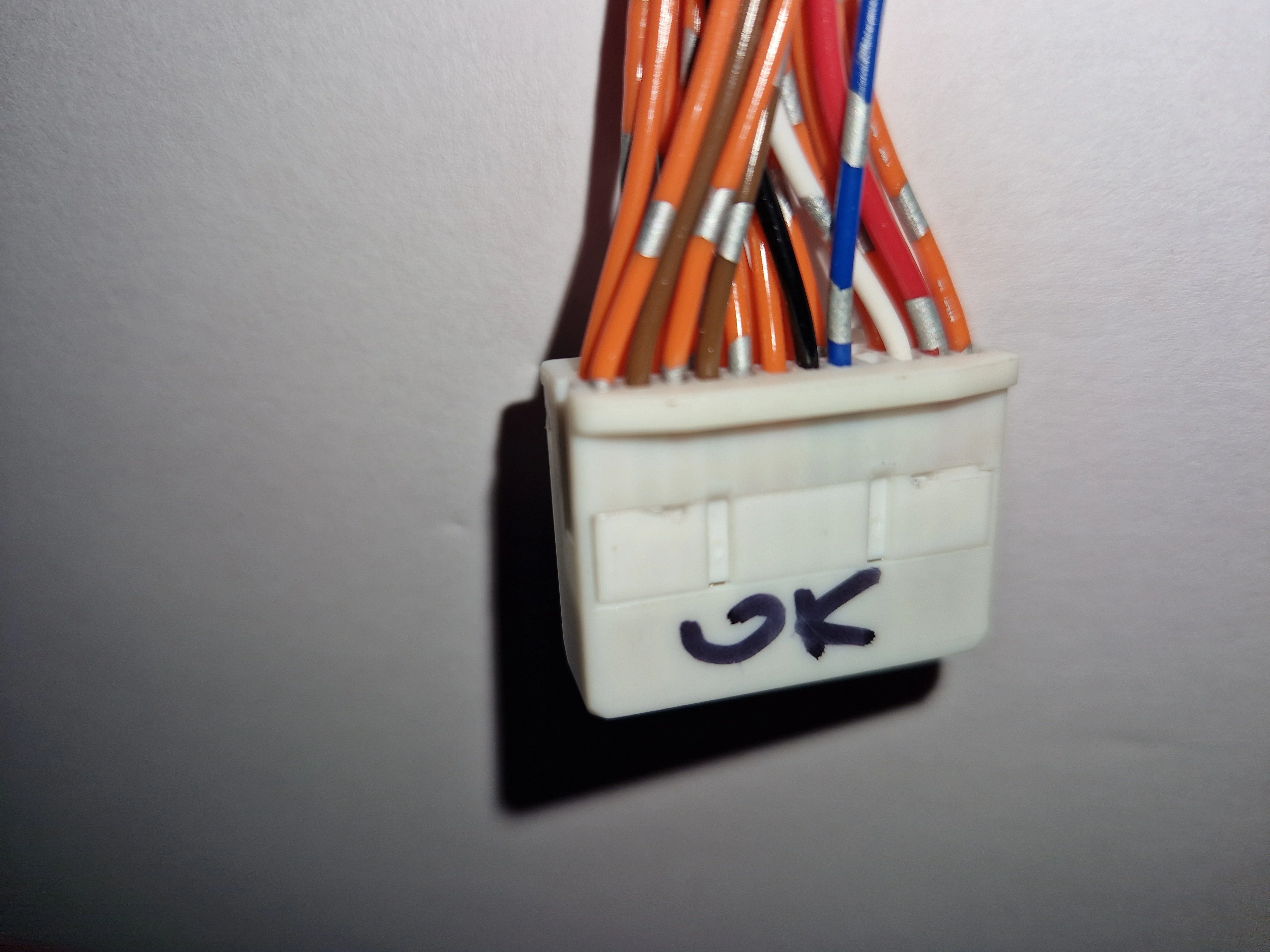

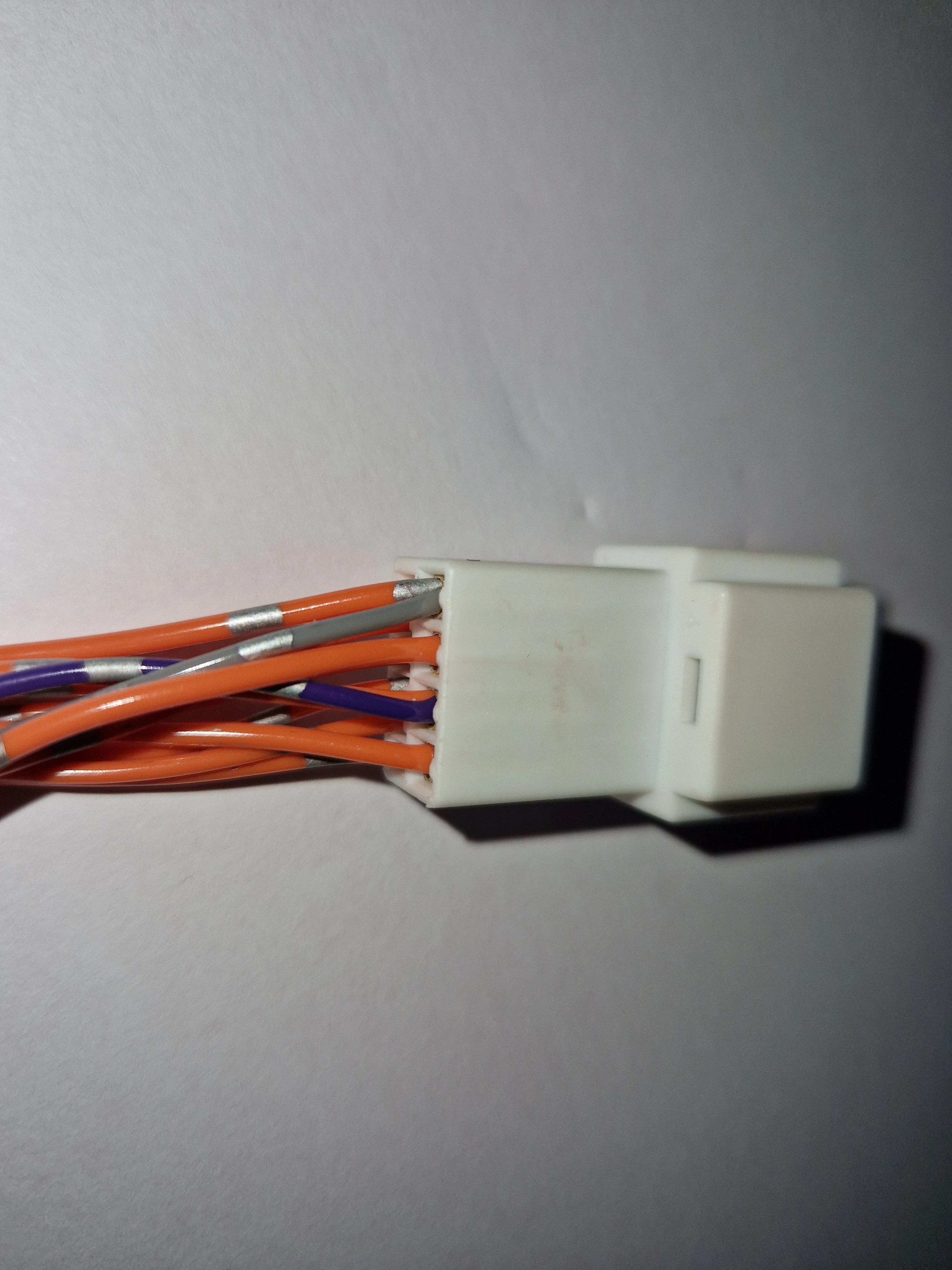

As promised:
This was the one I was asked to swap pins around if the grey wire is position 1, moving down the connector, I swapped 2 & 3 over (orange and purple) after testing for voltage pulse on locking and unlocking - with consultation with TRAC, I'm way too thick to have just thought of it.
This is the other main one, specific to the UK market (if that helps)
Happy to take any others - still disappointed it didn't work
hope that helps
Thanks for the pics. Would you be kind enough to take this a stage further and trace back the wires on each plug. At the moment, some of the wires are the same colour so can't work out pin position.
You can label each plug A B C etc and number the pin outs. Then follow the wire to the other plug and note the position.
E.G. Plug A position 1 goes to Plug B position 3
Thanks in advance!

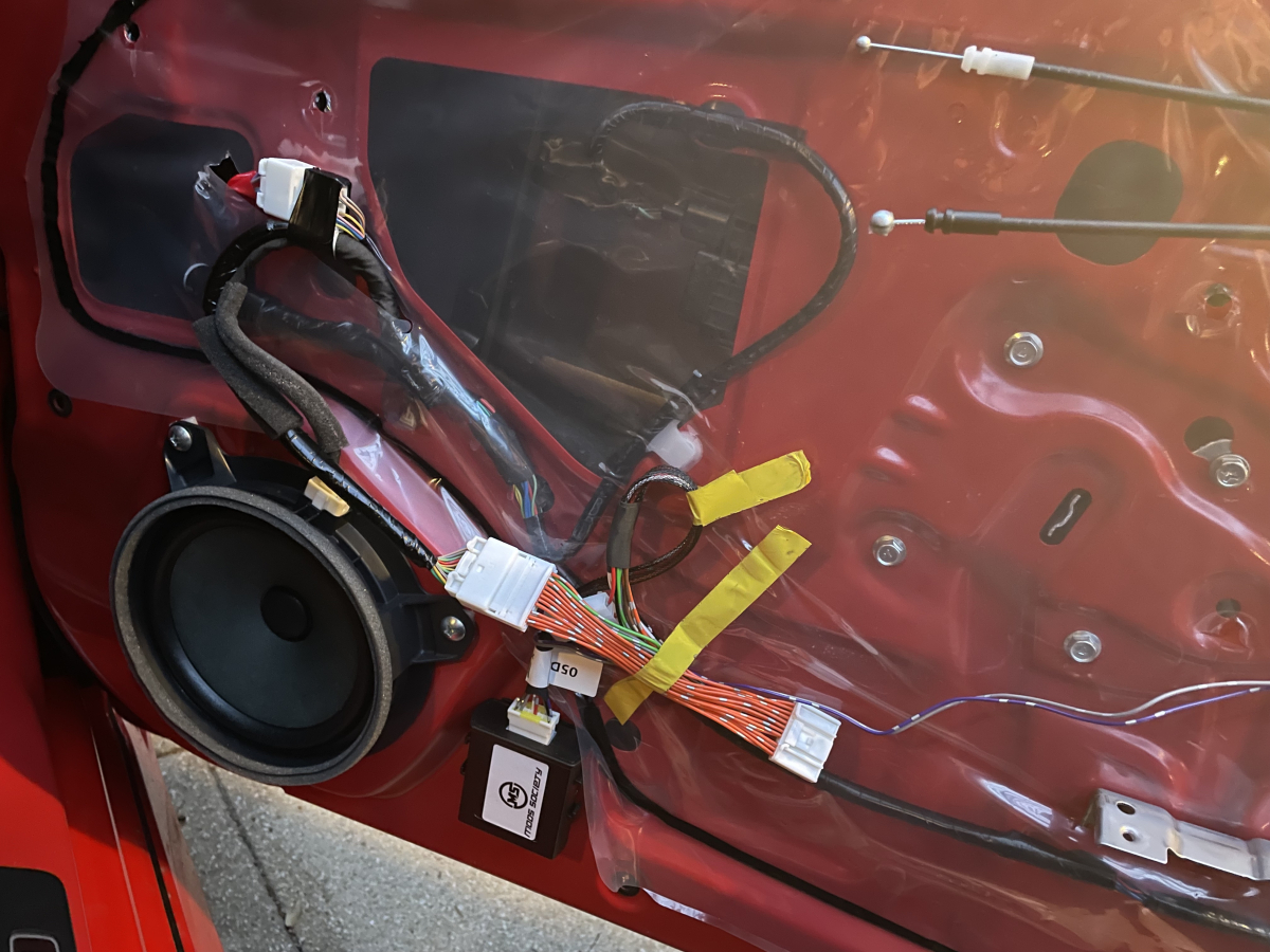

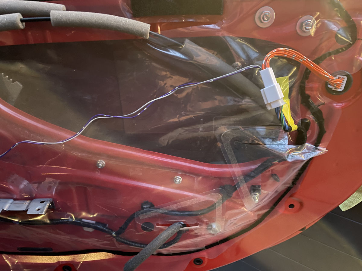

I’ve just fitted the Mods Society kit and very happy with it. Works perfectly, and the instructions on the video linked by wilster888 made it very simple to fit. With a bit of perseverance and a long prodding tool, the harness can be fitted behind the clear plastic without removing it. Didn’t get any photos of the install, but it was my first time getting the car in my newly fitted out garage 😊. I definitely recommend laying something soft down if you’re doing it on the drive - need to put that door card down somewhere.
Thank you to wilster888 for taking the chance on this and reporting back.
Toyota now smelling like a software company that charges for a “full” game and has additional DLC content in the can a month after release. 👎🏻
Anyone apprehensive about fitting this, don't be. You need to be aggressive pulling off the door card, after you have undone the 3 screws. The plugs are all different shapes so you can't get it wrong. You don't need to disconnect the cables. Whole thing can easily be done in less than half an hour.
