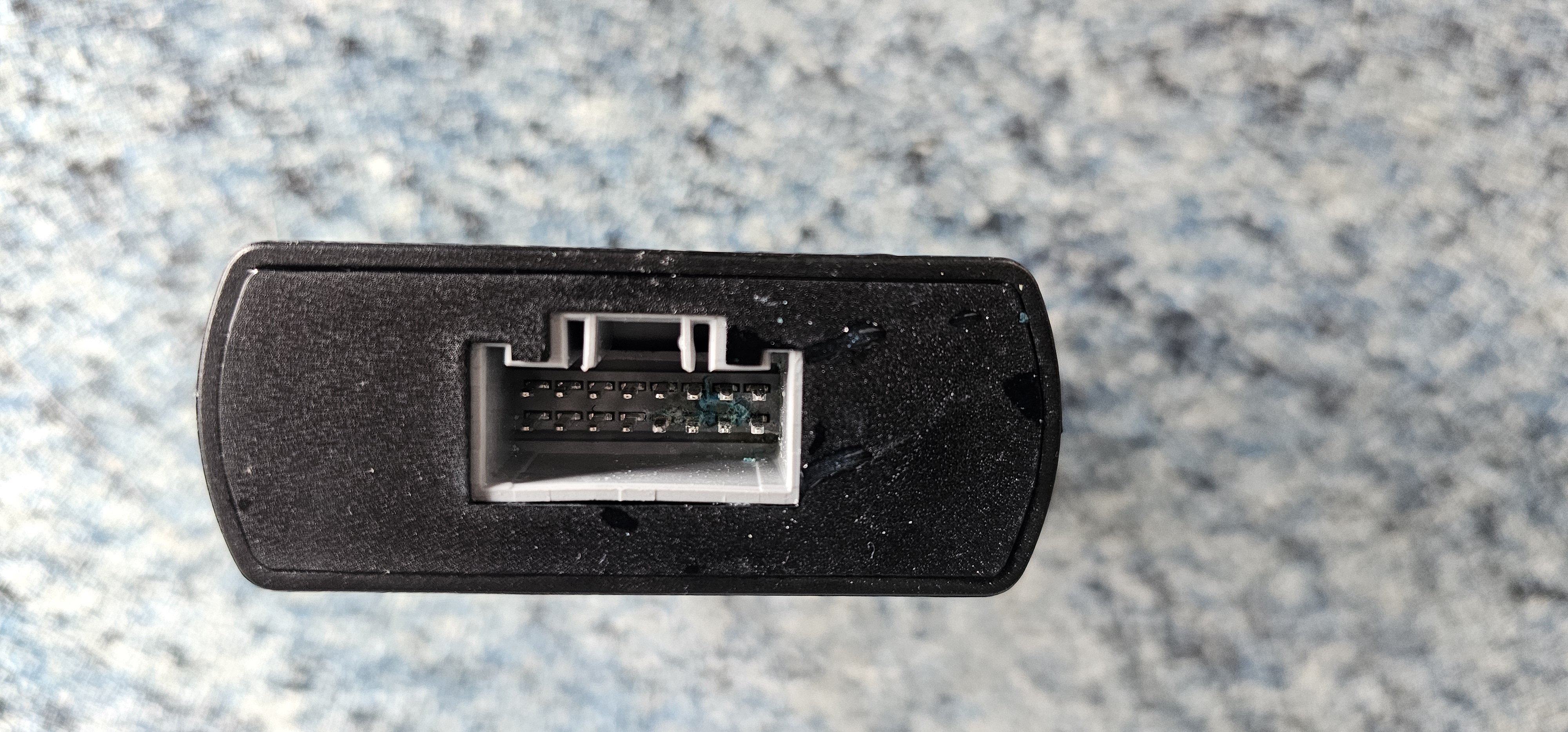

I've just taken the door card off to have a look and the Mod Society box has water in it and some corrosion on the connectors . I had it in the same location of wilster888 photos in post 110. 🤷‍♂️
Mirror switch works fine without it fitted.
Any idea of how the water got in? Any water marks on the door card or the clear plastic? In the position you fixed it was on the inner part of the door. Do you think the water followed the wiring down to the unit?
No idea, no water marks anywhere. The wiring was taped to the outside of the plastic sheet.
I’m stating the obvious here but there really shouldn’t be any water there - could get in the speakers too. Has the plastic membrane been compromised at all? Also, how long has the mod been fitted for?
Plastic membrane is fine. Fitted it late December last year.
It could be but would need the right conditions. Is the car garaged?
No.
No.
Oh right - so hasn’t lasted long at all. Have you noticed any excessive moisture on the inside of the windows on cold nights?
Nope, I've never had any moisture on the inside of the windows.
It’s a strange one then. Could be down to just really cheap metal/components in the mod I guess (making it susceptible to rusting quick). The water is a mystery though - definitely getting in somehow). Be interesting to see how others mods hold up. Mines only been in about a month 🙄
I’m very tempted to pop the door card off and have a look at mine. I’d rather catch any ingress now before either the module or the car itself gets damaged.
Does anyone have any suggestions to stop ingress? Current thought is insulating tape to try to create a weatherproof “boot” from the cable, over the connector, and to the module. Will likely look a bit of a mess but I guess it doesn’t really matter.
You will always get some moisture in the door card (hence the vapour barrier) but it shouldn't be excessive. I would get a roll of self amalgamating tape and mummify the module and connector.
