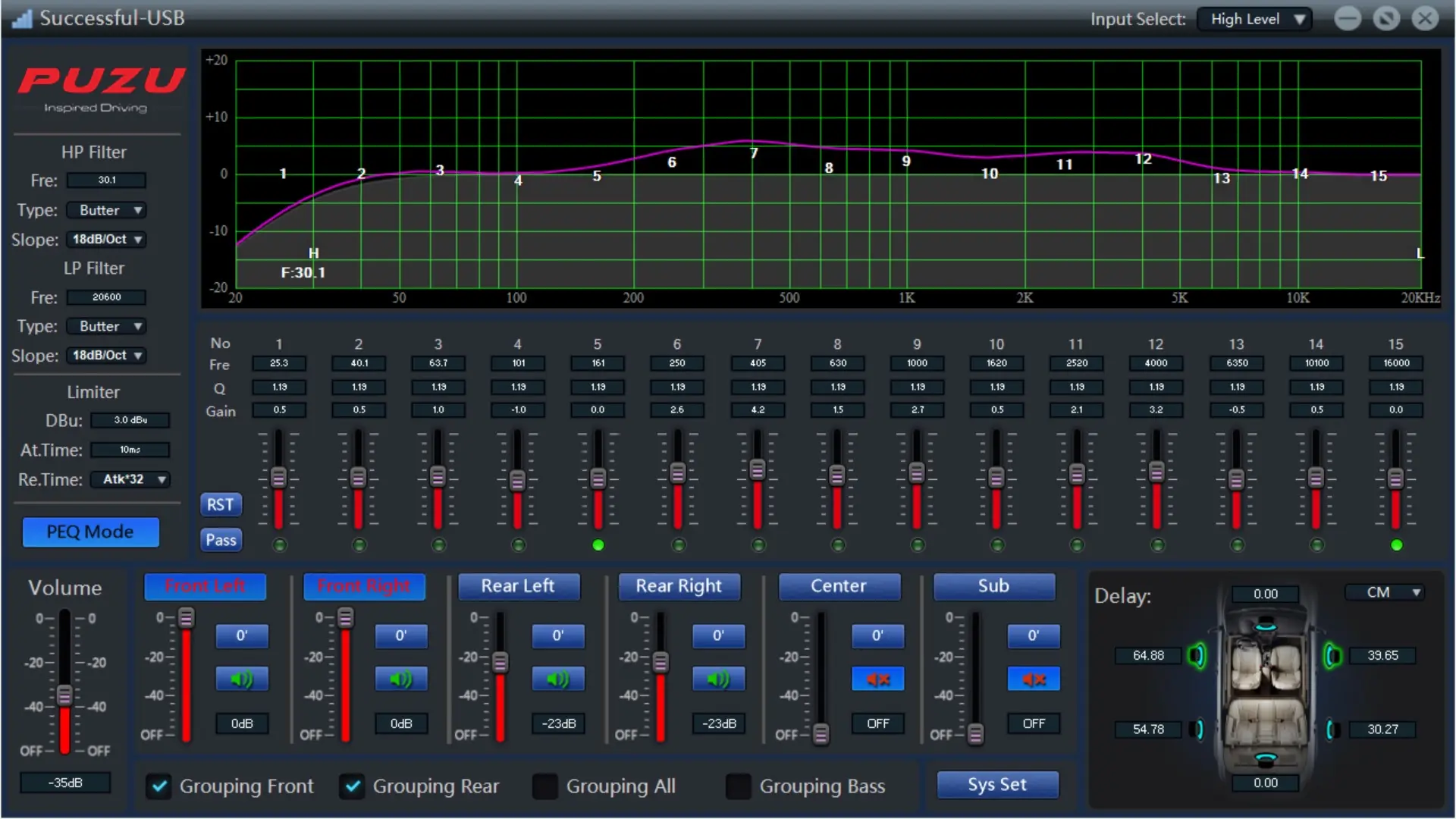

Did think about doing it now but I'll wait for light tomorrow. Sort of hoping even on base settings it should be better. What I'm reading from this picture is you've dropped volume down a bit and the rears? And grouping ticked.
Grouping makes any settings you make apply to that group. So I usually group front and group rear.
There is adjustment to the eq, the screen cap is for front settings.
Rear settings don't make much difference as it's got a low pass filter on the factory speaker already. But I put a 300hz lowpass on the PUZU for the rears.
The front speakers most important I think is the HP filter slope. I think 30hz with 18db slope gives the front speakers a chance to play what they can but without taking away too much lows.
