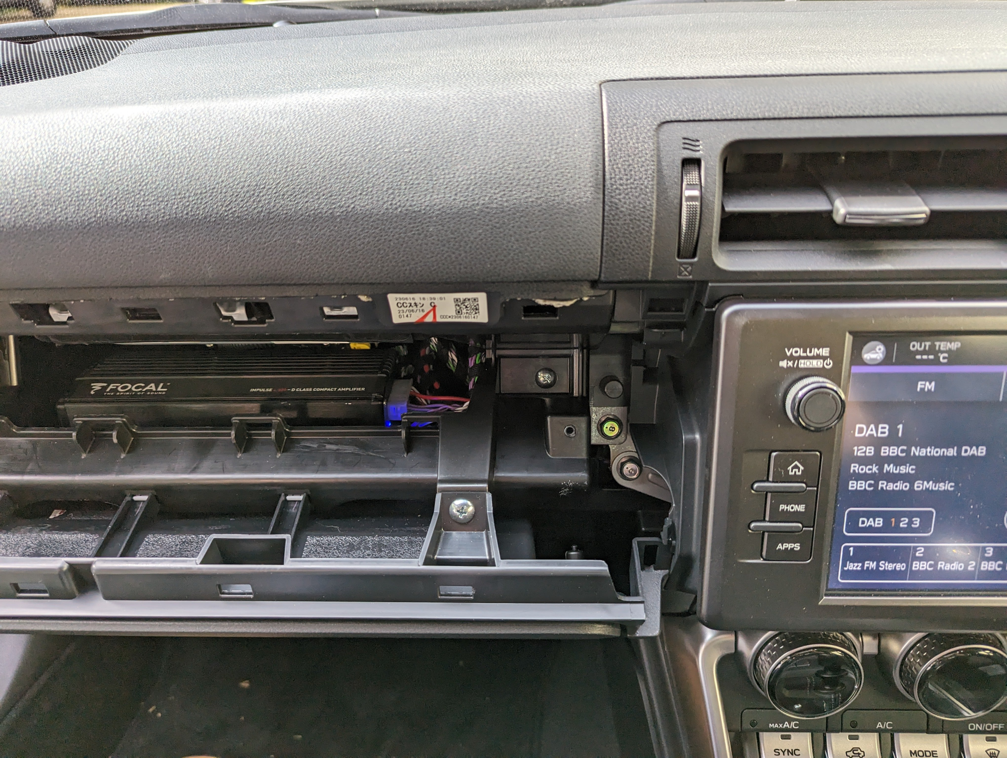

I fitted the focal speakers, then added a Focal 4.320 amp I picked up new on eBay for £100.
The amp JUST squeezes in to the gap above the glove box.
To wire it in without faffing about, you will also need:
Focal IW-TOY-YISO
And
Focal IW-IMP-EXT150

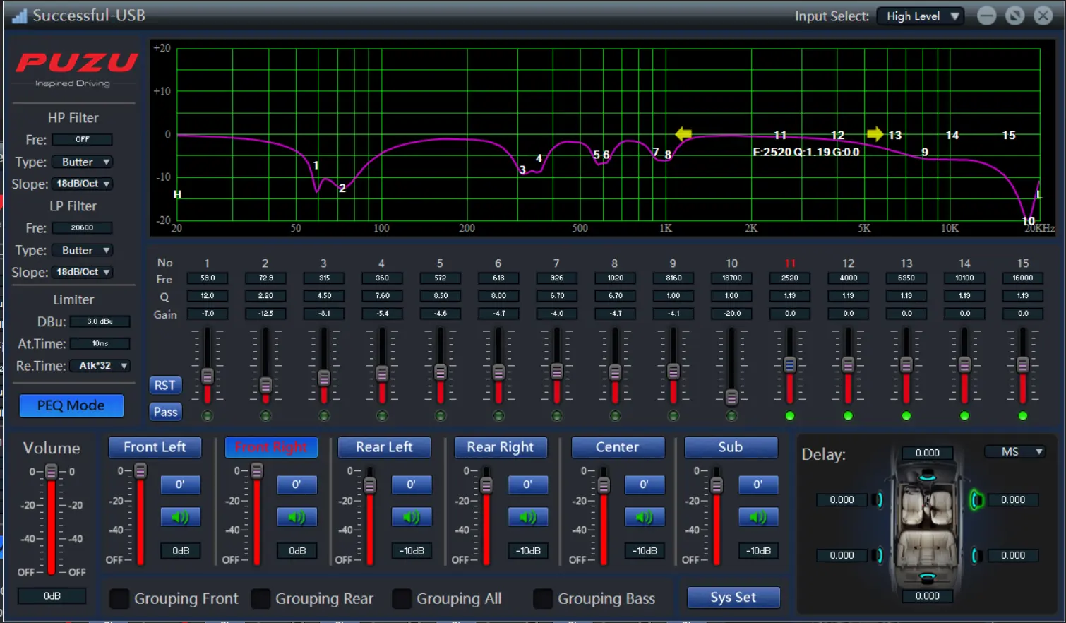

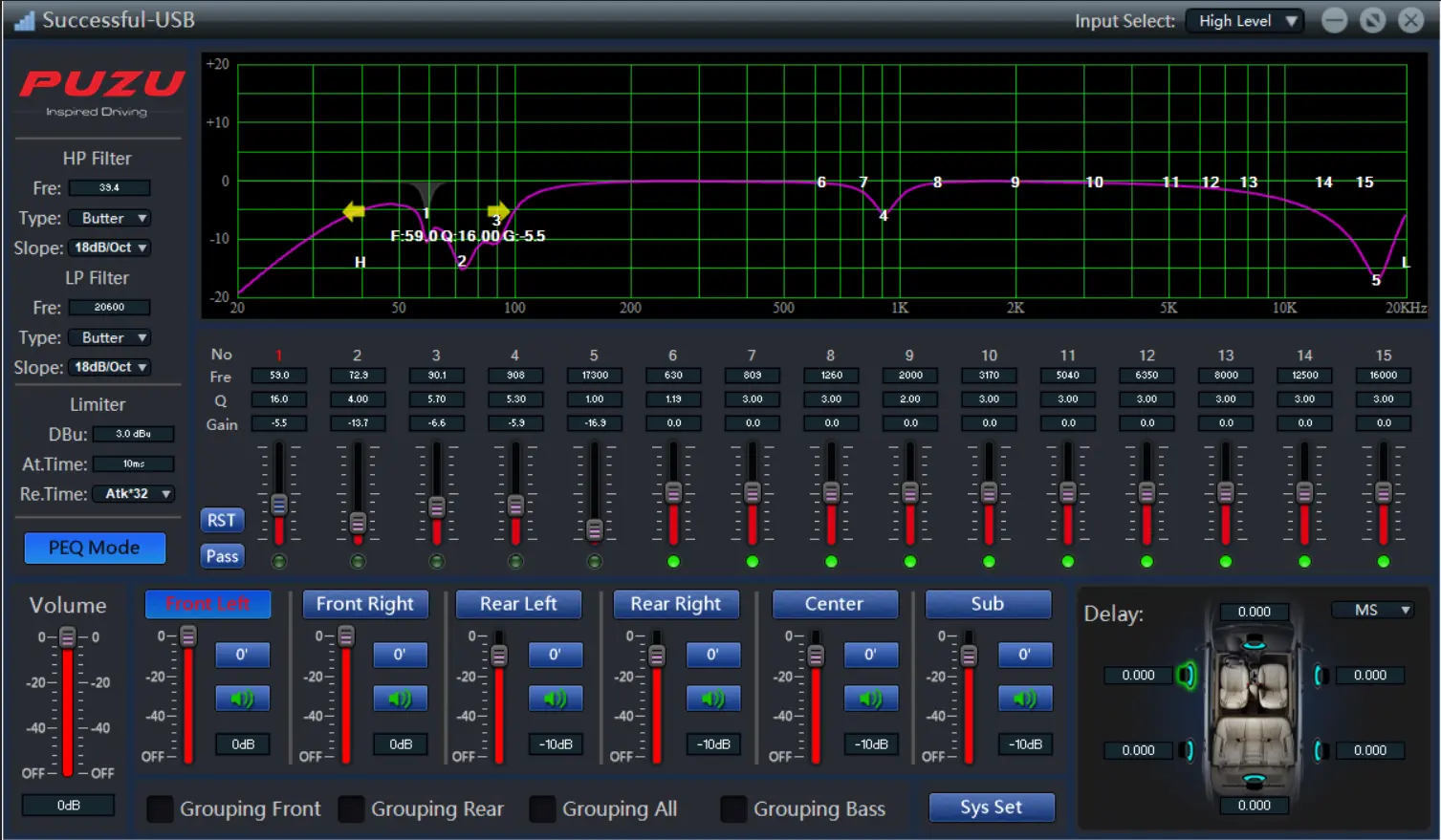

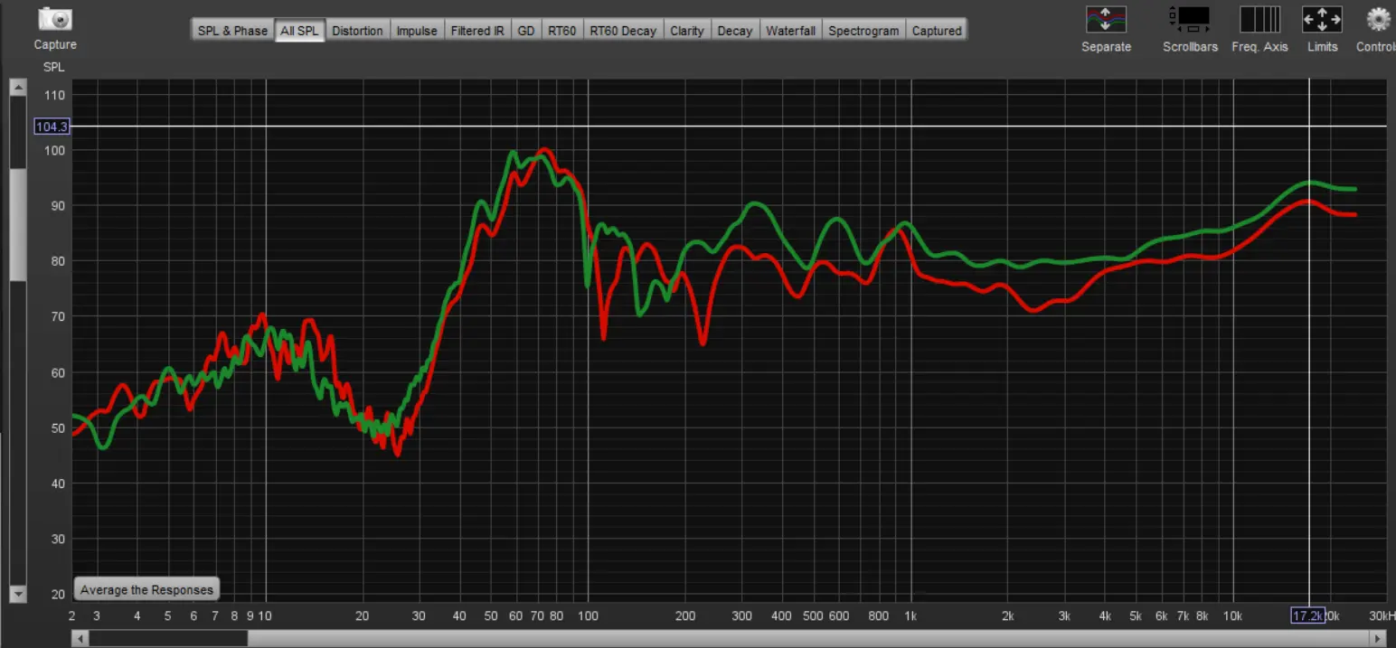

Took some measurements and knocked up an initial set of filters. The attached screenshots show the smoothed response at the drivers head position and my C7 settings, targeting a Harman curve from 20 - 20kHz. Interestingly the C7 PEQ settings won't accept arbitrary values - they self adjust to the nearest 'allowed' values so I couldn't quite replicate exactly the filters from REW but close enough.
Already sounding great to these ears!

Excellent stuff, thanks for publishing your work!
What do you use, a Umik or similar?

Yep Umik-1 and REW 👍
