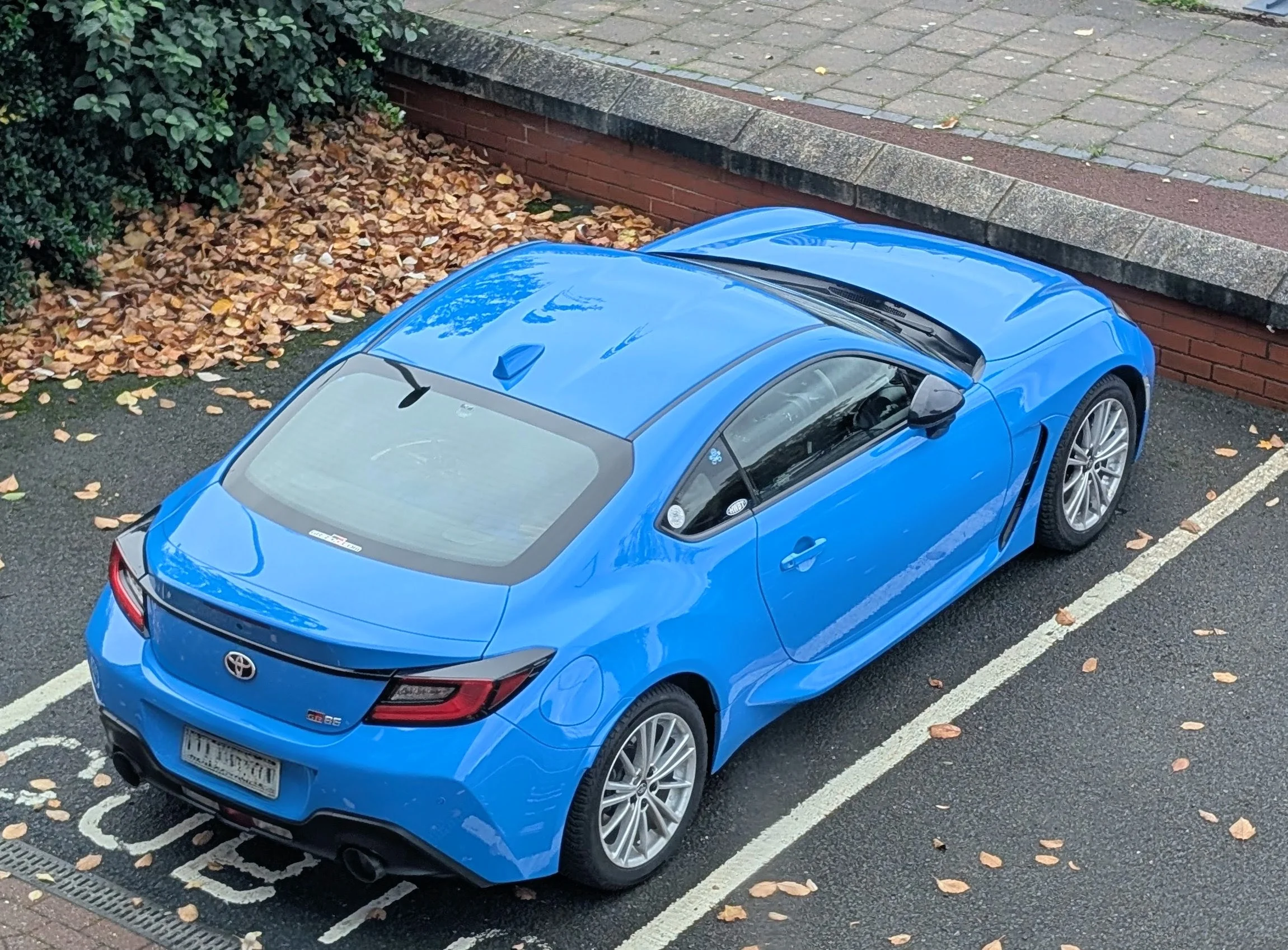

Window crack has been fixed by fitting a washer, cold weather wheels fitted, and my Autel TPMS tool arrived so I've added the sensors in as a second set too.
Summer wheels swapped out this lunchtime by my local trusted tyre place - FOC
Bought a new camera today, so used the GR as a test subject for the first few shots.
My old camera (Canon 450D DSLR) went missing from my hold luggage one the way home from South Africa earlier this year. I'd been meaning to upgrade it anyway, but it was still a PITA as I lost the SD card within it. But the new one (Canon R7, mirrorless) is a noticeable improvement in image quality. Pleased. Will make sure to bring it with me for any sunrise drives :)
