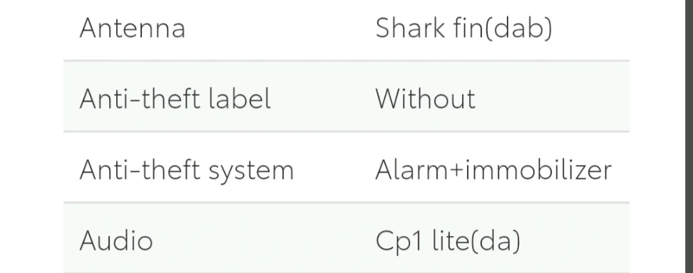

I've just looked up my official specifications from the VIN. That shows both alarm and immobiliser in the factory build sheet.

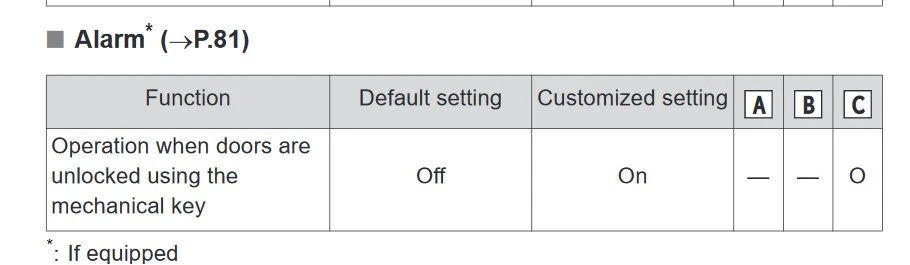

EDIT: The only thing I could find in the User Manual shows that the Alarm system is OFF when using the key (by default) and is a Dealer/Techstream customised setting (C). Maybe if it is set to ON and the key is used (not the fob) the Alarm will sound?
When we took ours on the ferry to Le Mans there was no point locking it with the key so the alarm wasn't on then?
