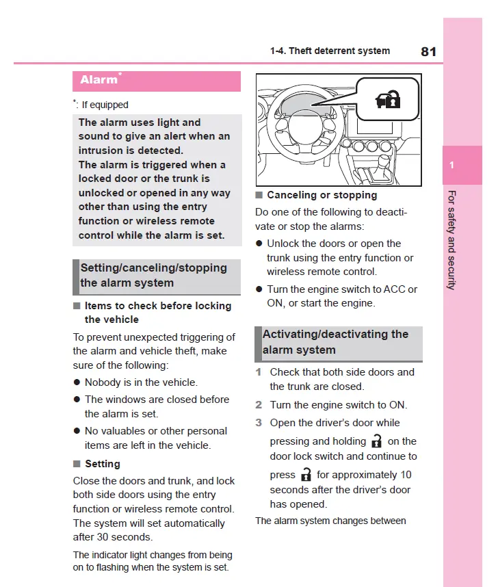

Hmm. I guess we'll have to take their word for it. The manual does seem to back that up; but I'm surprised that operating the door handle from inside the car doesn't set it off....
Also, I tried the the procedure to activate the alarm but there was no feedback as to whether it turned it off or on. If what they say is true, no real way to check, either.
EDIT: posted this before seeing the video above. Might be worth someone trying that with a UK car then.
