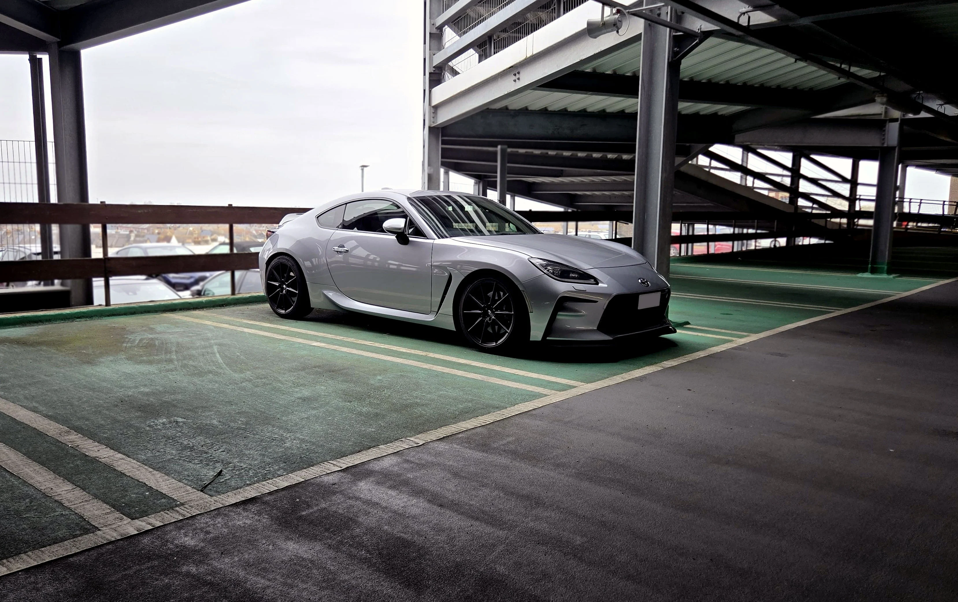

Great stance. How much have you spaced the stock wheels?

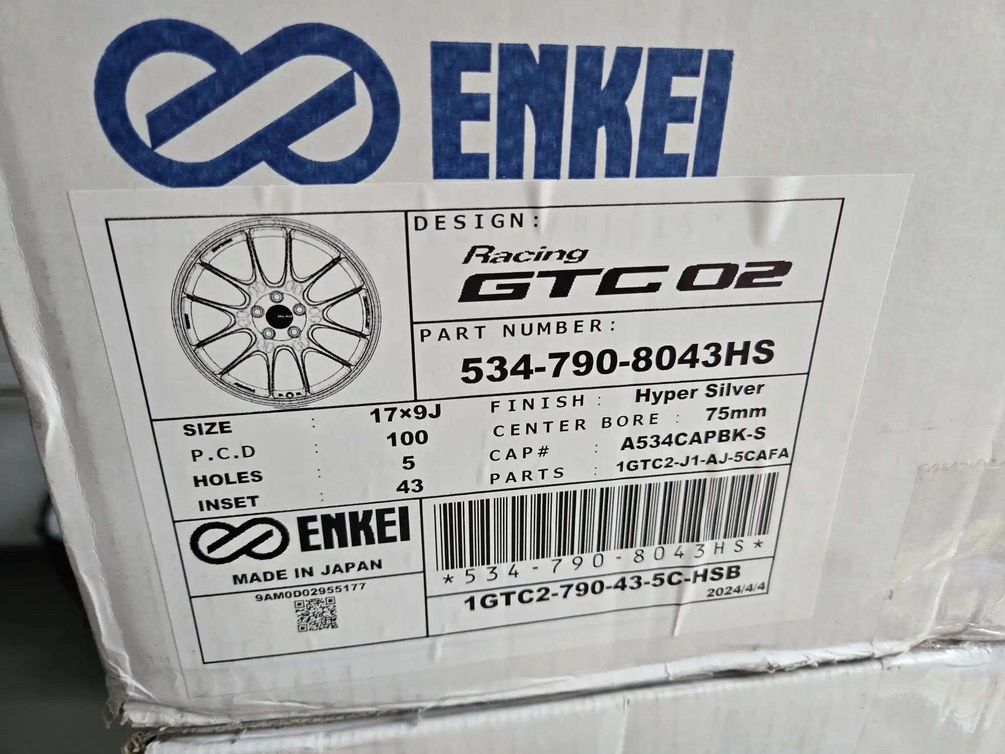

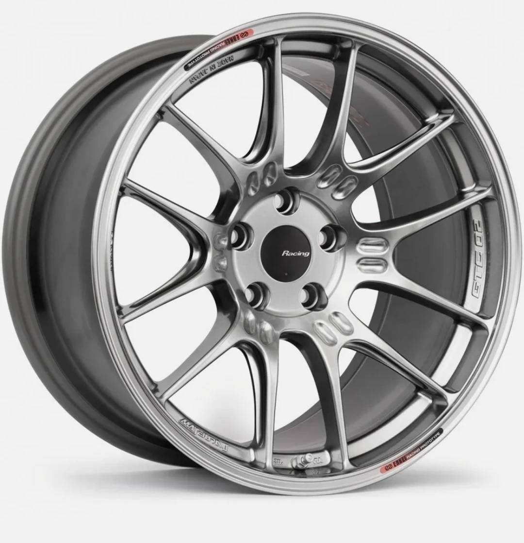

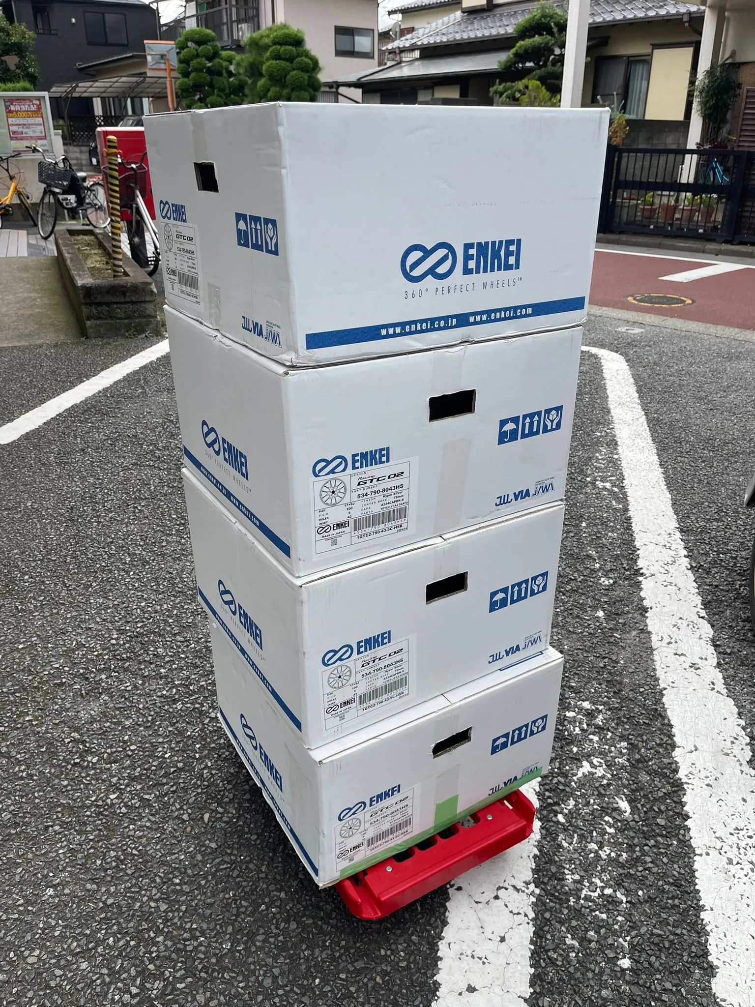

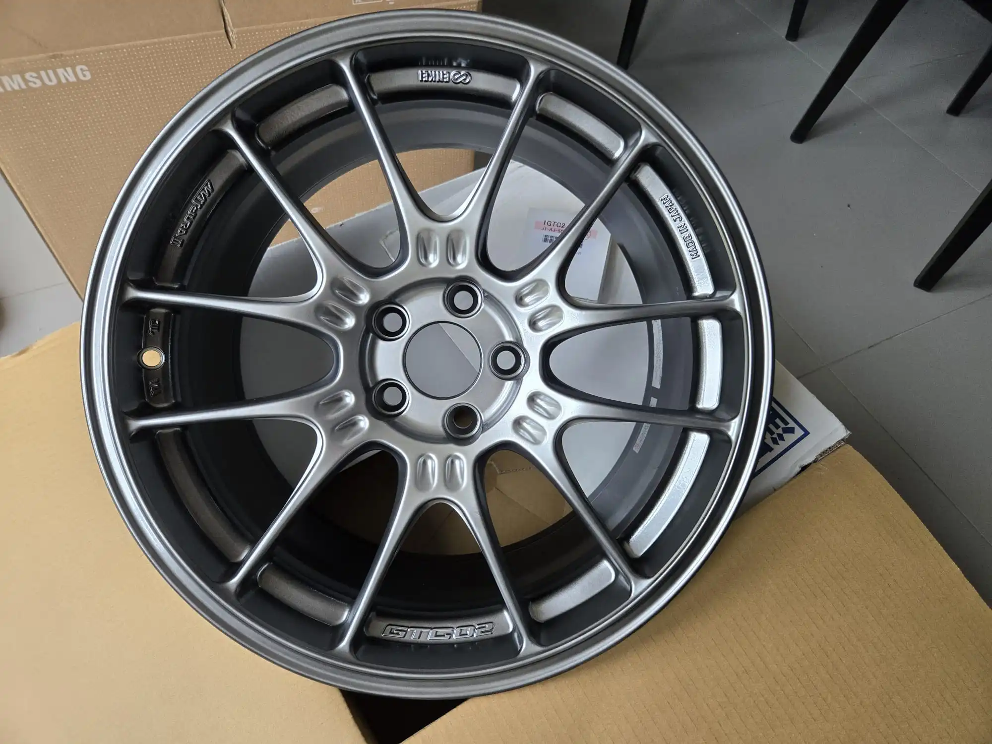

That’s surprising given the vast amount of clearance the AP CP9200 kit I have on has with both stock and wider, more dished aftermarket 8.5” wheels (all while keeping the stock dust shield too - the disk is not more inset than stock).Got round to doing some work on the car today.... I had a gut feeling and it is true. The new 17x9 Enkei's wont clear the front Brembos. Got some 3mm spacers coming, hopefully its enough or will have to run 5mm.

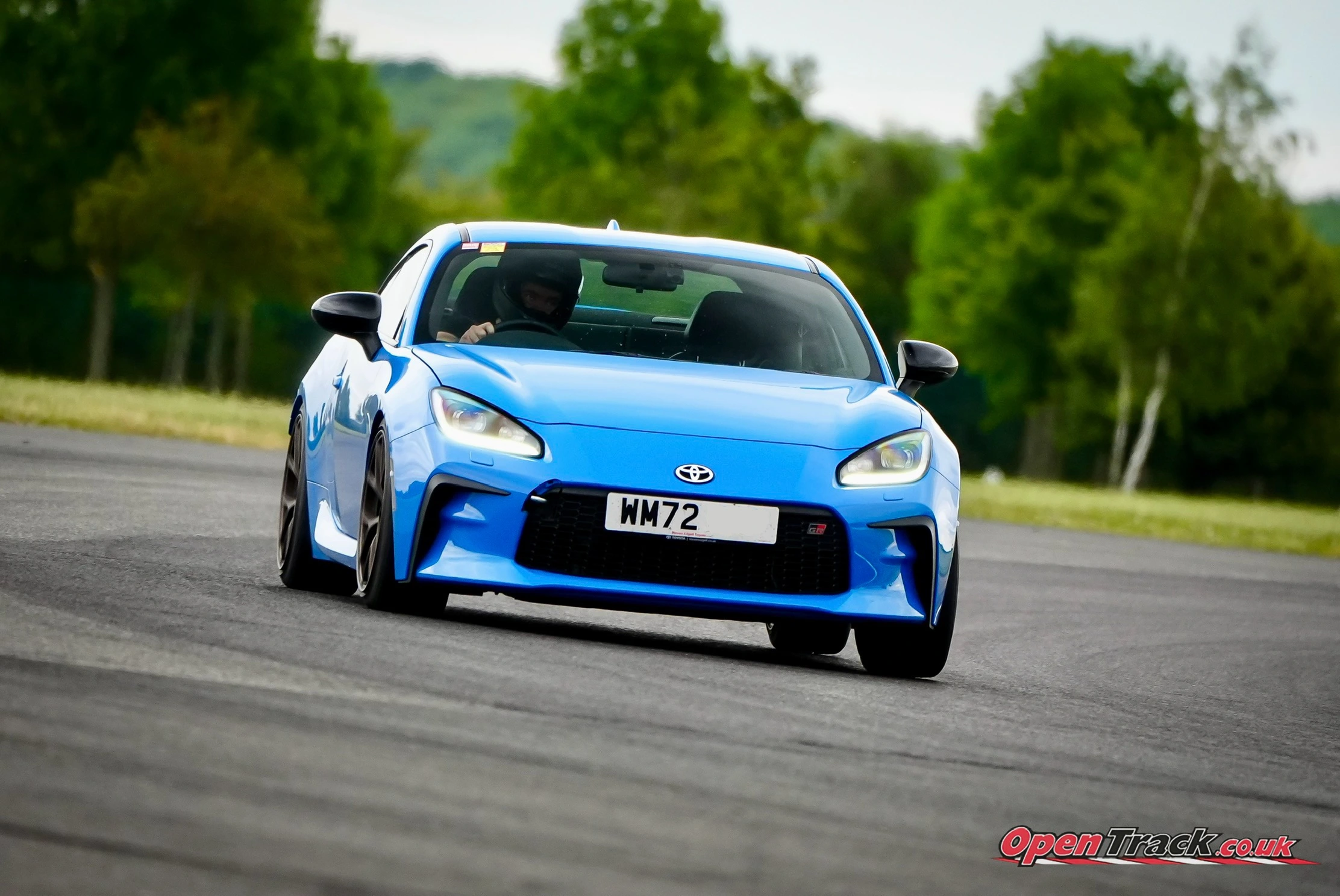

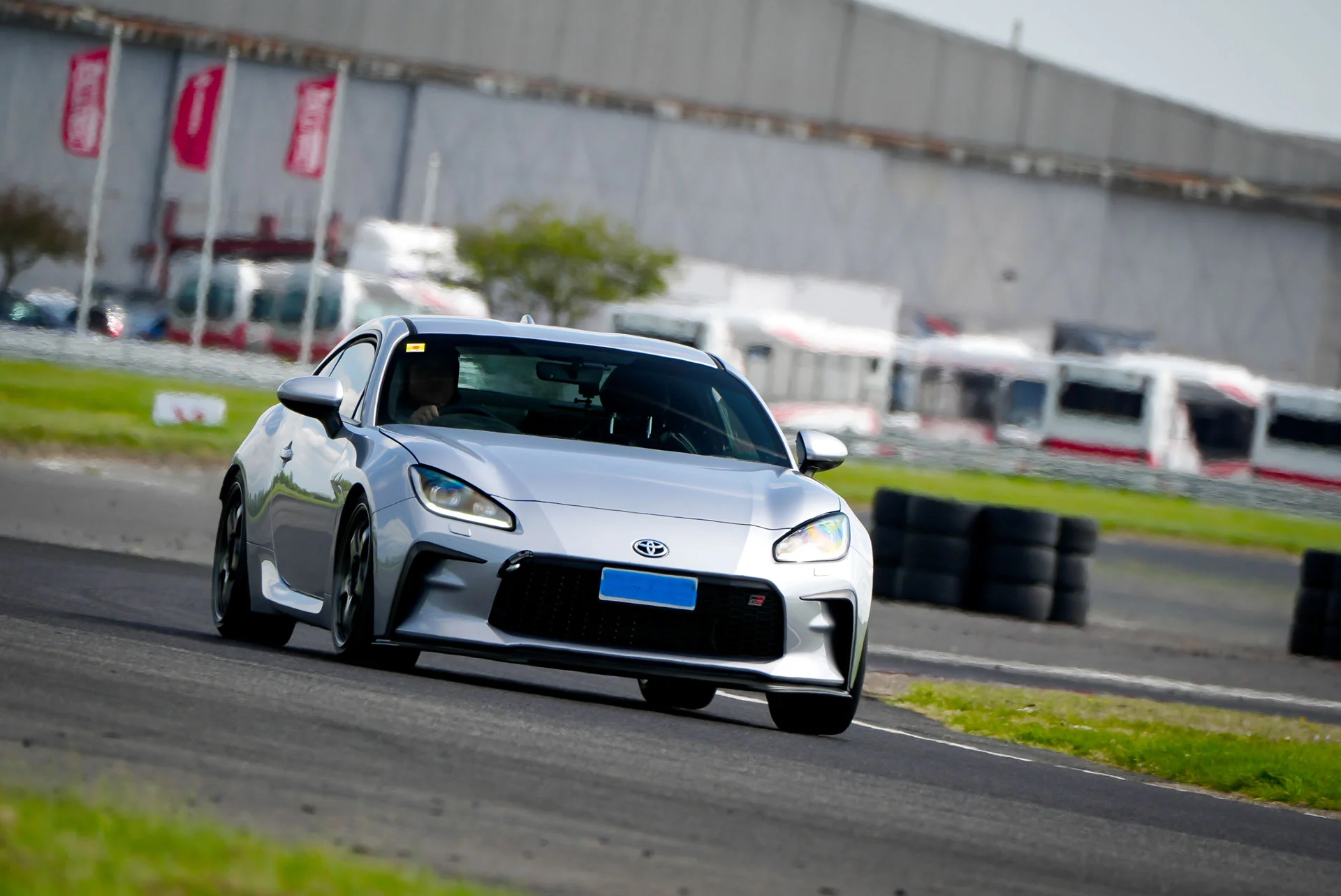

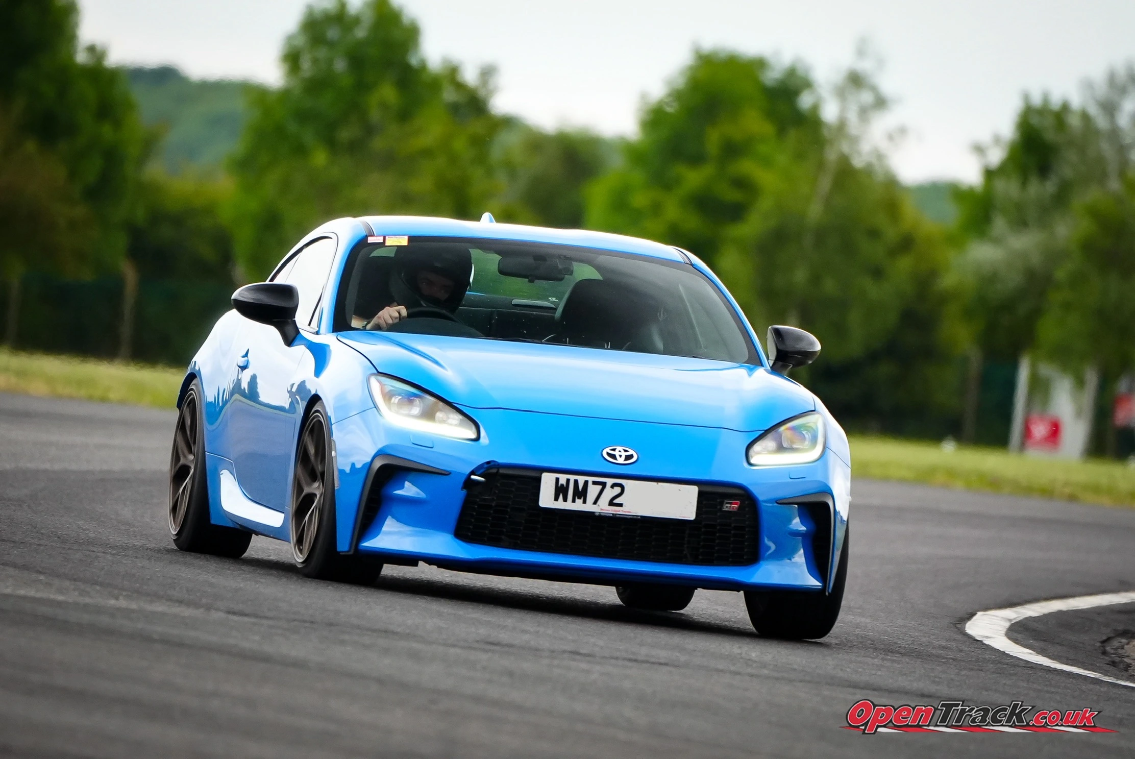

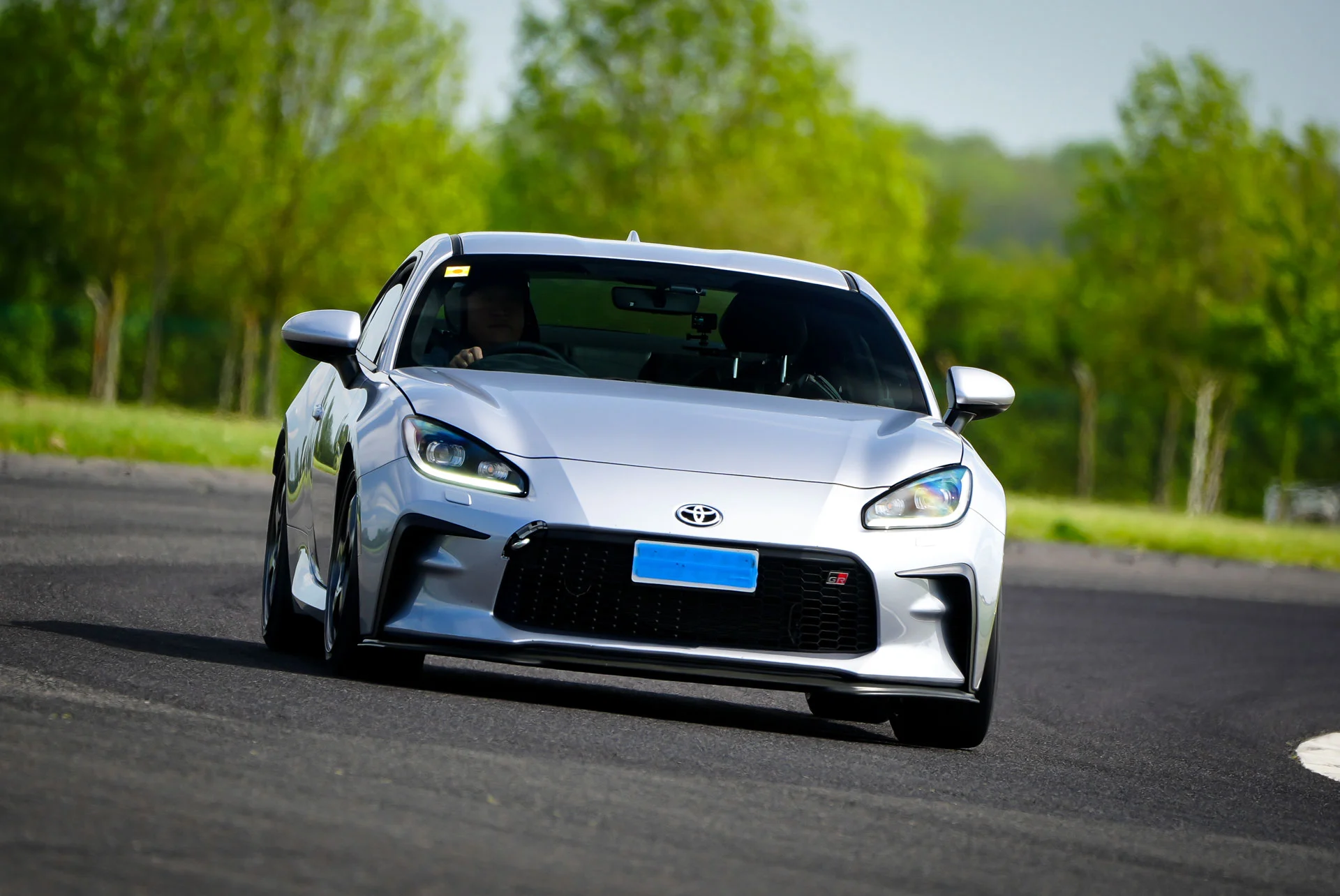

Also, I meant to share these shots a while back as they’re almost exactly the same angles. Running HKS Hipermax S with untouched road damper settings just to see what it was like. Next time I’ll try full stiff to see if it’ll reduce roll a tad.Some pics from the day at Bedford.
