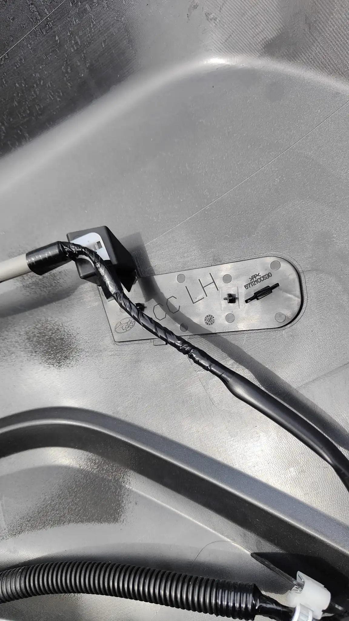

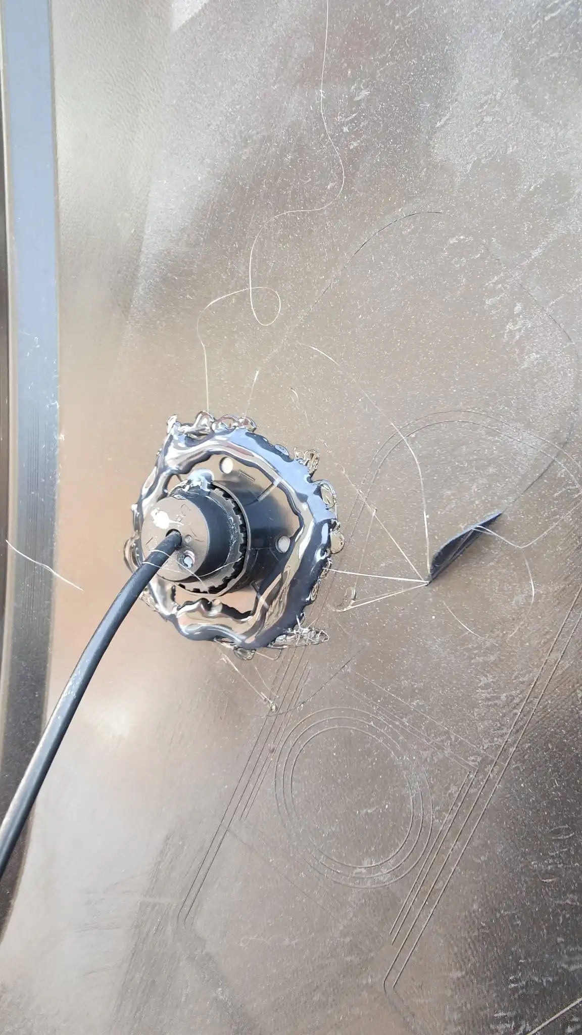

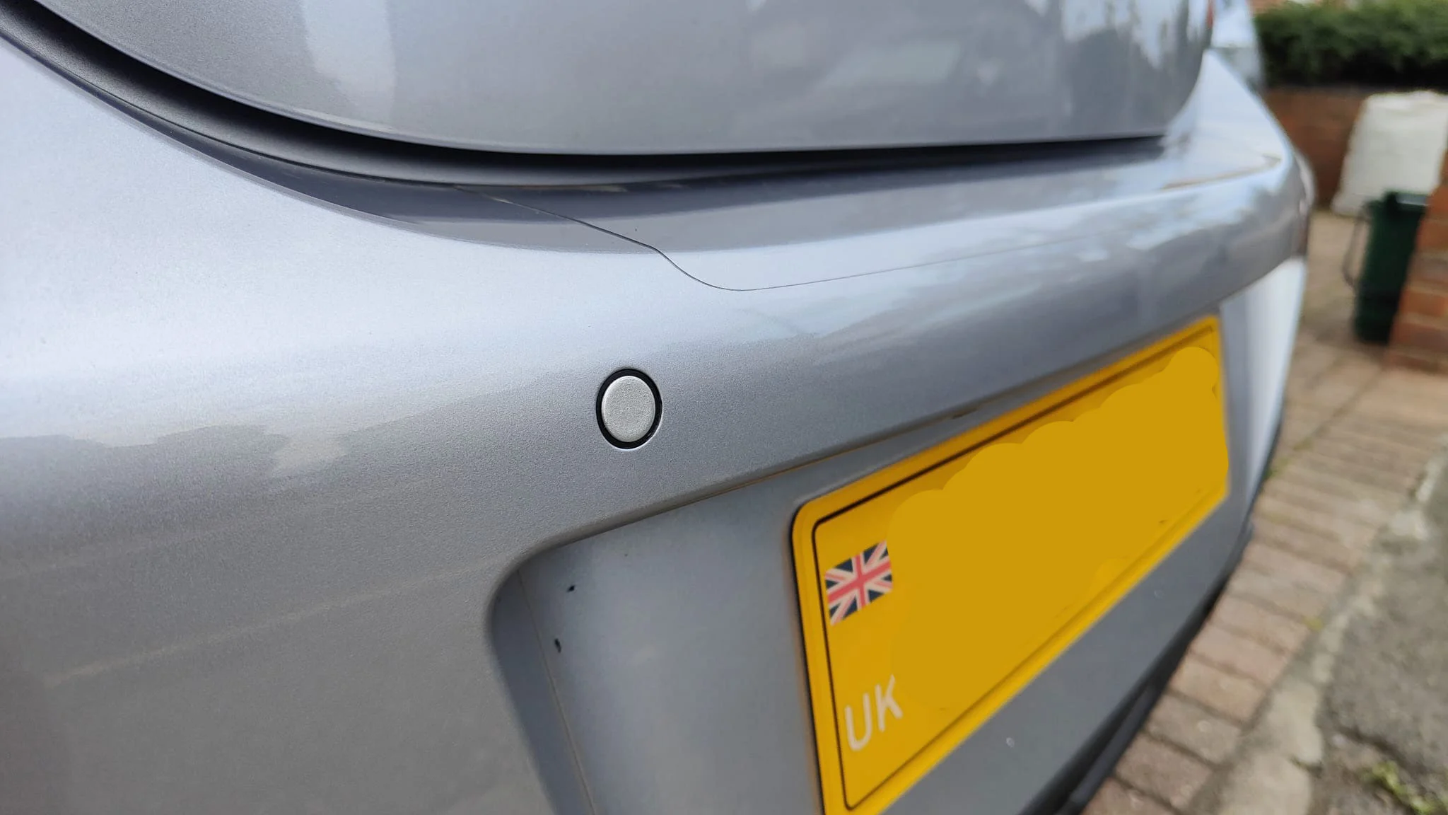

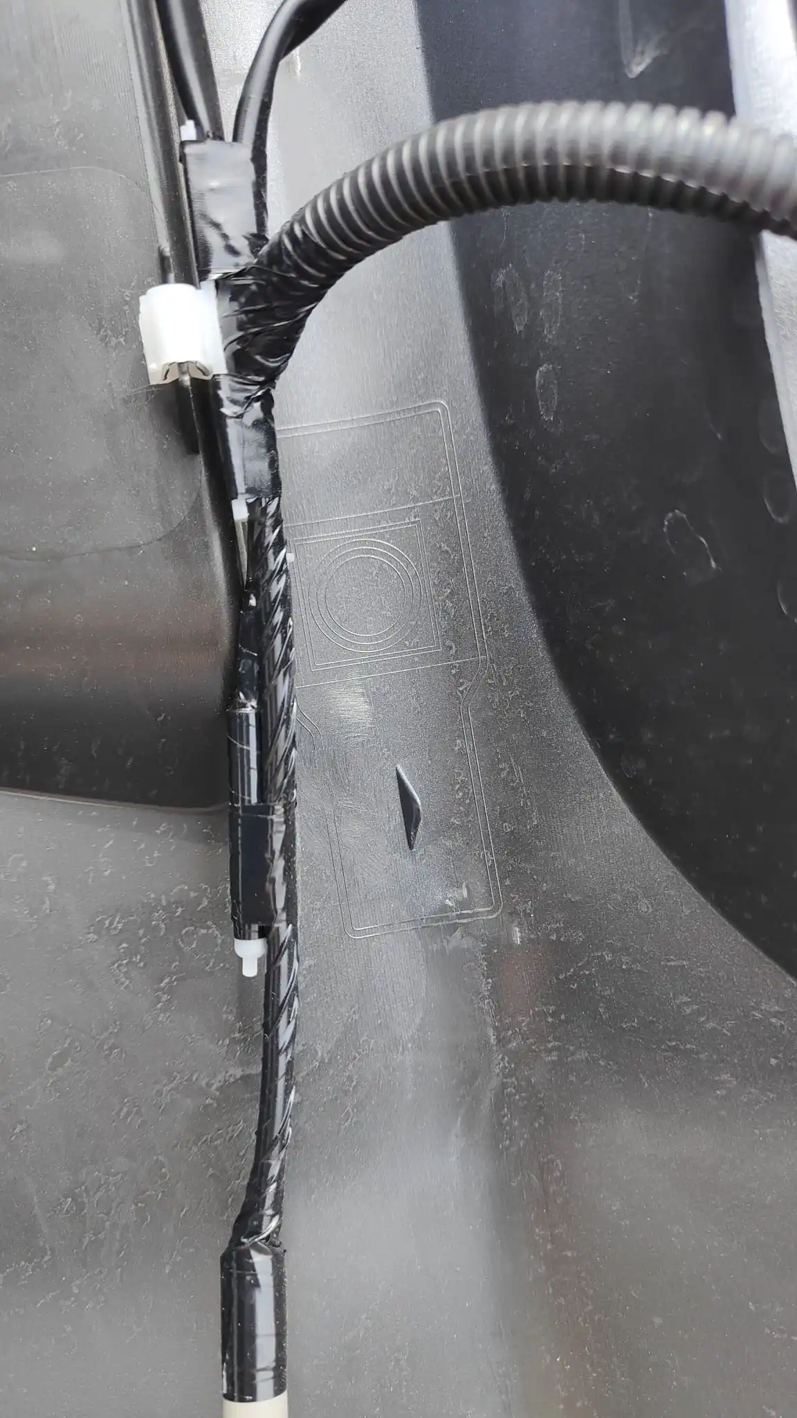

Just completed the GR86 install. Very straightforward, wiring is easy. The bumper is pre-marked on the back side so not need to work out positions. Only issue, is on one side, the bullseye is blocked by a cable bracket. I just made it as close as I could and mirrored the other side.
The rattle can I got doesn't match perfectly (annoyed) and it's the second rattle can, the first was way off.
I used some hot glue to double hold the mounts as due to curve of the bumper, they weren't 100% stuck down flush.

How did you manage to drill those holes so cleanly? I want to get some fitted but my body shop guy is nervous about drilling the holes (which may not turn out as cleanly as yours appear).
you don't drill them out. They are sort of pressed out with a die cutting tool. If the person fitting them is not using this tool then run a mile! There is no longer the need to use cone cutters or heaven forbid the included saw cutter that comes with the kits! :LOL:
A die cutter like this below will cut cleanly, as it presses out the hole and also rounds the edge every so slightly, just like factory OEM holes.

It is straight forward. You drill a pilot hole in the bumper. Then just tighten the punch tool to punch/cut out your sensor hole with the rounded edge that is required for a clean sensor install.
