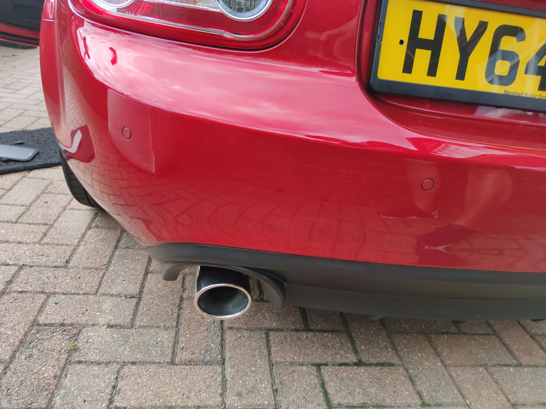

I've fitted these on many cars. Get the closest colour, then get a rattle can with the correct colour paint and paint them. You have to disassemble them to mask off the rubber surround. Also, do not use the cutter they supply!!! You need to get a correct 16.5mm die cutter.

I've got a set ready painted and just waiting for a break in work to allow me time to fit them.
For the meantime, here is a set I fitted to my 25th Anniversary MX5.
Looks a smooth install
