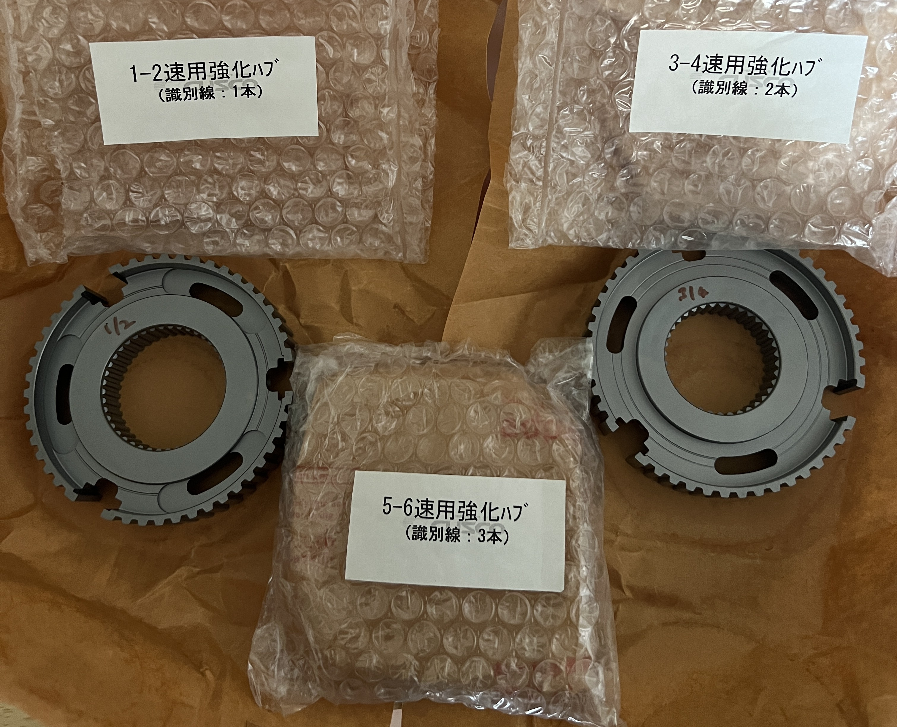

Some more surface treatments I found for gear
Take cusco to metal lab
Waiting for final report, but to tell from bare eye Cusco get very even surface finish unlike stock one
And if Cusco is dare enough to cut 2 slot
That mean Cusco is very confident about tensions strength of this Syncro hub
One of guy at my country tell me they are supplier for ZF transmission
And this type of hub generally made from Powder Metallurgy
Is cheap and fast to make
That tend to fill with micro air pockets
With knowledge of flex fuel is not Suprise

I feel Aisin transmission in Gr Yaris is hopeless if u are serious track guy
My transmission hub fail again despite reduce TQ and all the treatment I done
And not using 5th gear at all at track
This is what happened today when
I finish my track testing , I think with all the treatment and reduce TQ output , this time hub did not fail as dramatically
