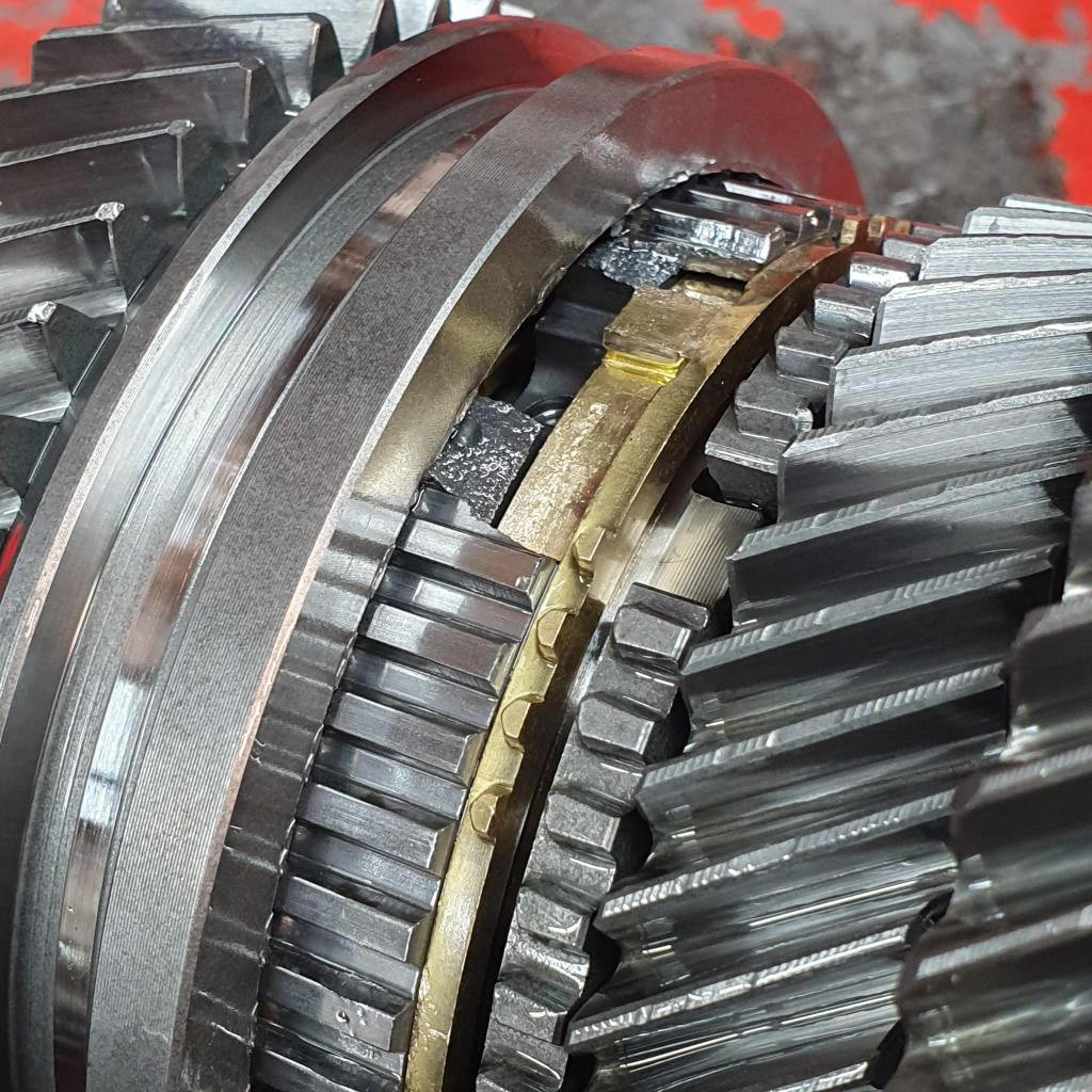

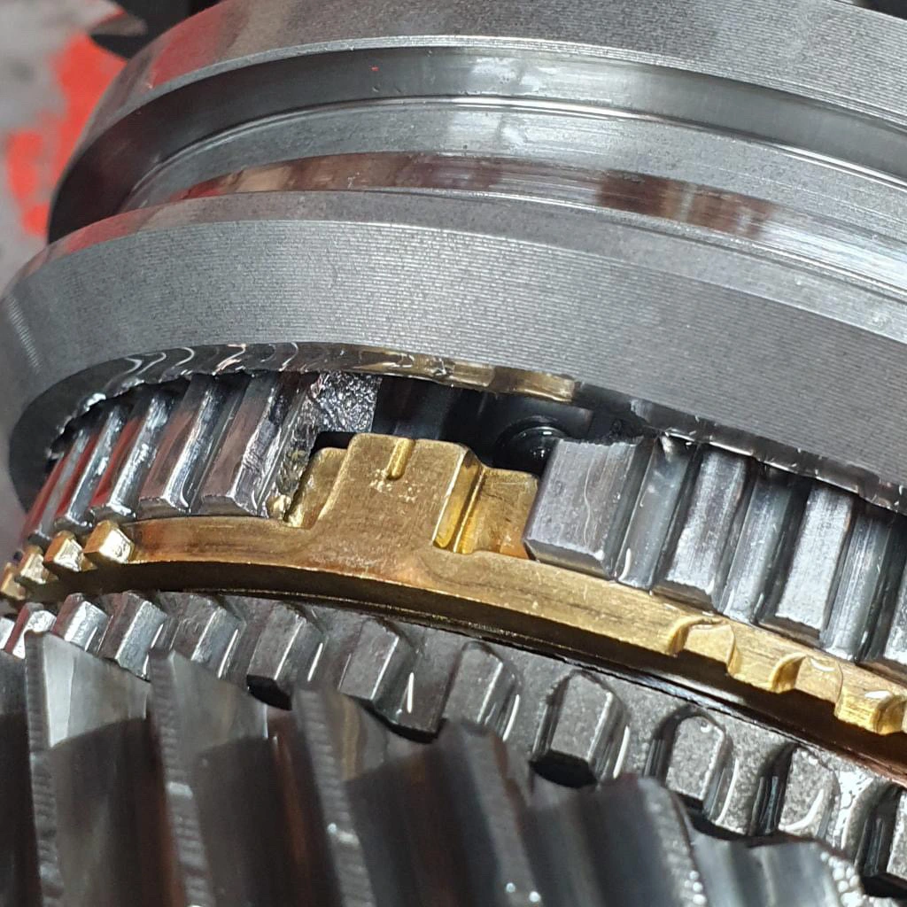

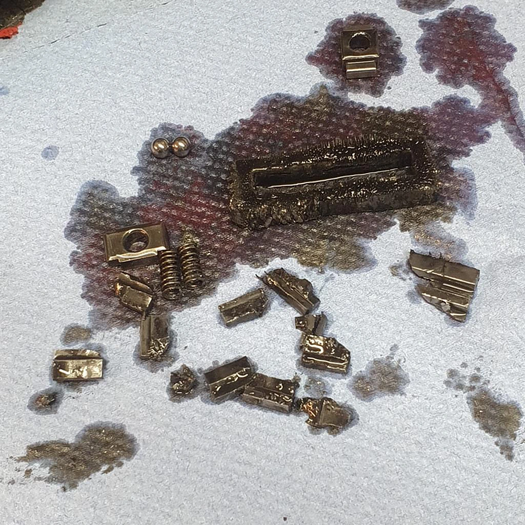

GR Yaris I Broke my third Transmission at track 。this time GRMN close gear set

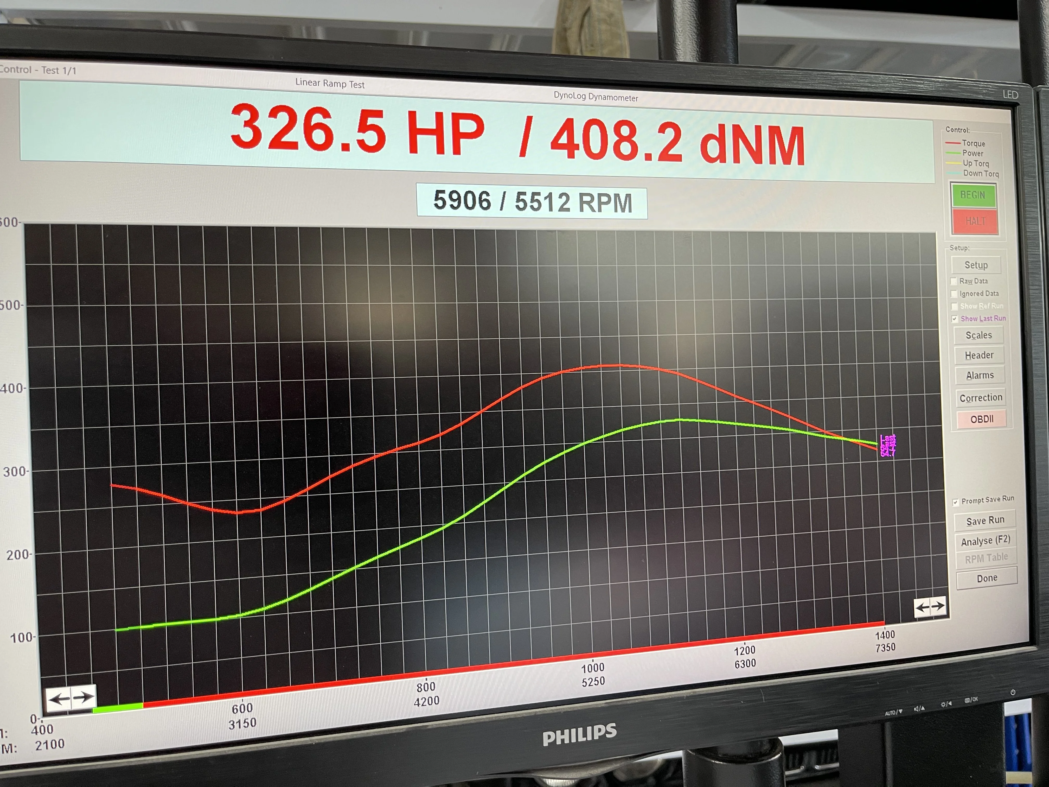

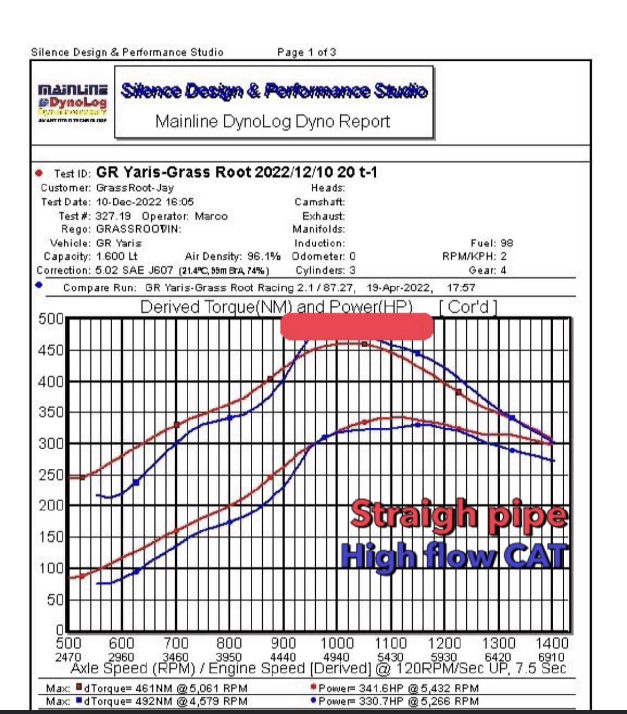

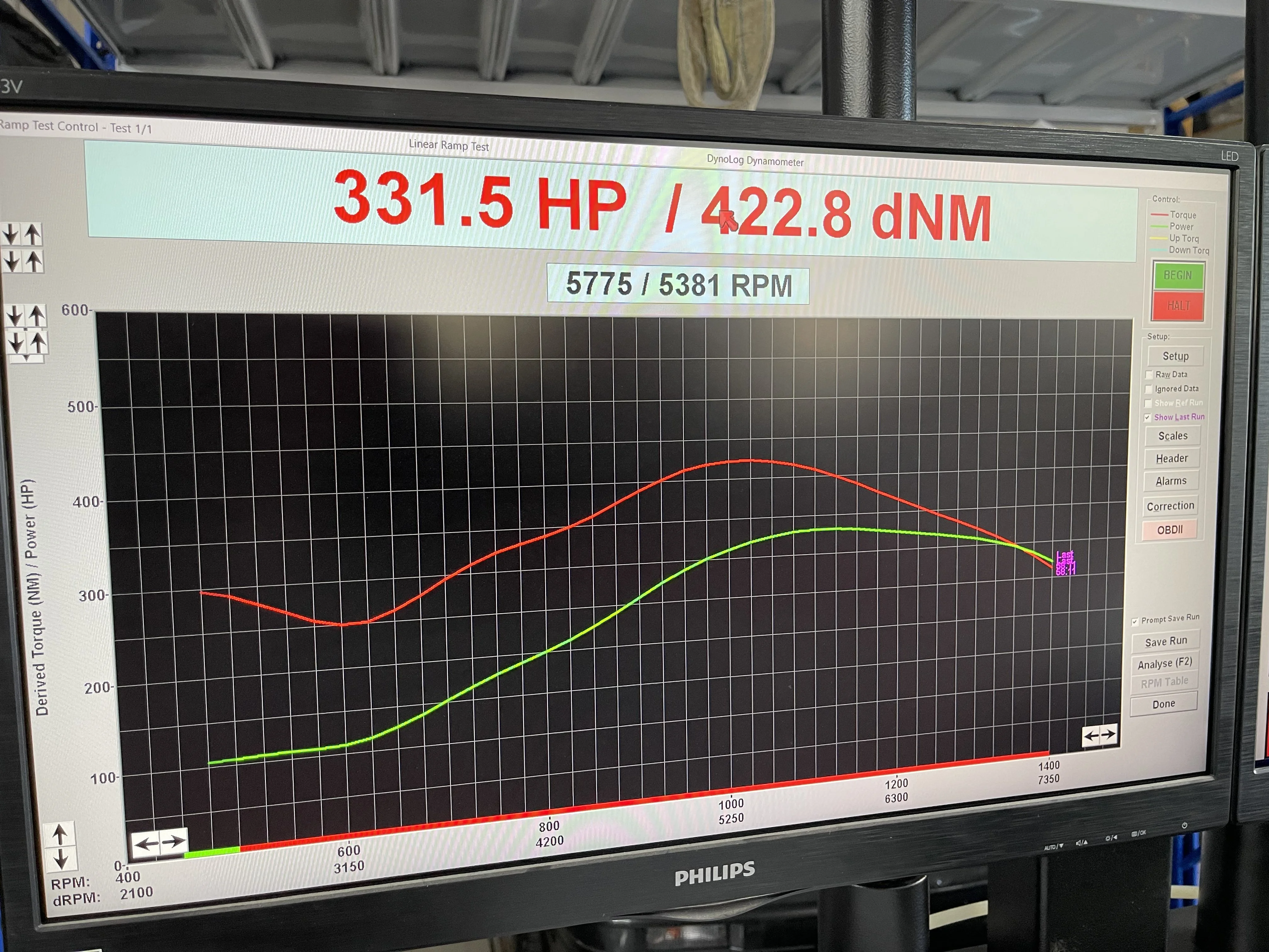

With flex tune E60 and lamspeed Big TB and Cnc intake manifold
Tuner can lower TQ output (460 VS408)but still can maintain similar HP
Comparing to old manifold set up ( pic on right)
U can clearly see lamspeed Cnc intake manifold and big TB shift whole power band upward
Which is more suitable for track use
E60 VS 50% race VP109
Of course with less TQ is less punching before
But aleast I don’t have to worry the transmission issue 😅
Will update it if any thing go south
More I look on it
More I wonder why steel clutch hub will failed
Before cooper Syncro
I am not professional engineers, can some one r lay to us ?
Some more road testing (300km) to one old oldest Taiwan car magazine 40 years anniversary
In my previous transmission experience, if Hub fail
It can fail at cruising too , make shit to gear or pop out gear impossible
To tell the true , even now my transmission shift nice and smooth , but I still pretty nervous about it
