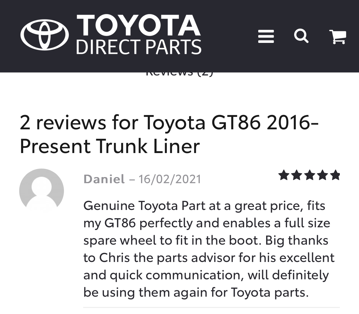

Hi Ritch
Do you think that would fit over the full-size wheel or is made for the space saver. GT 86 never had 18s or did they
Hi Ritch
From the reviews of the part.

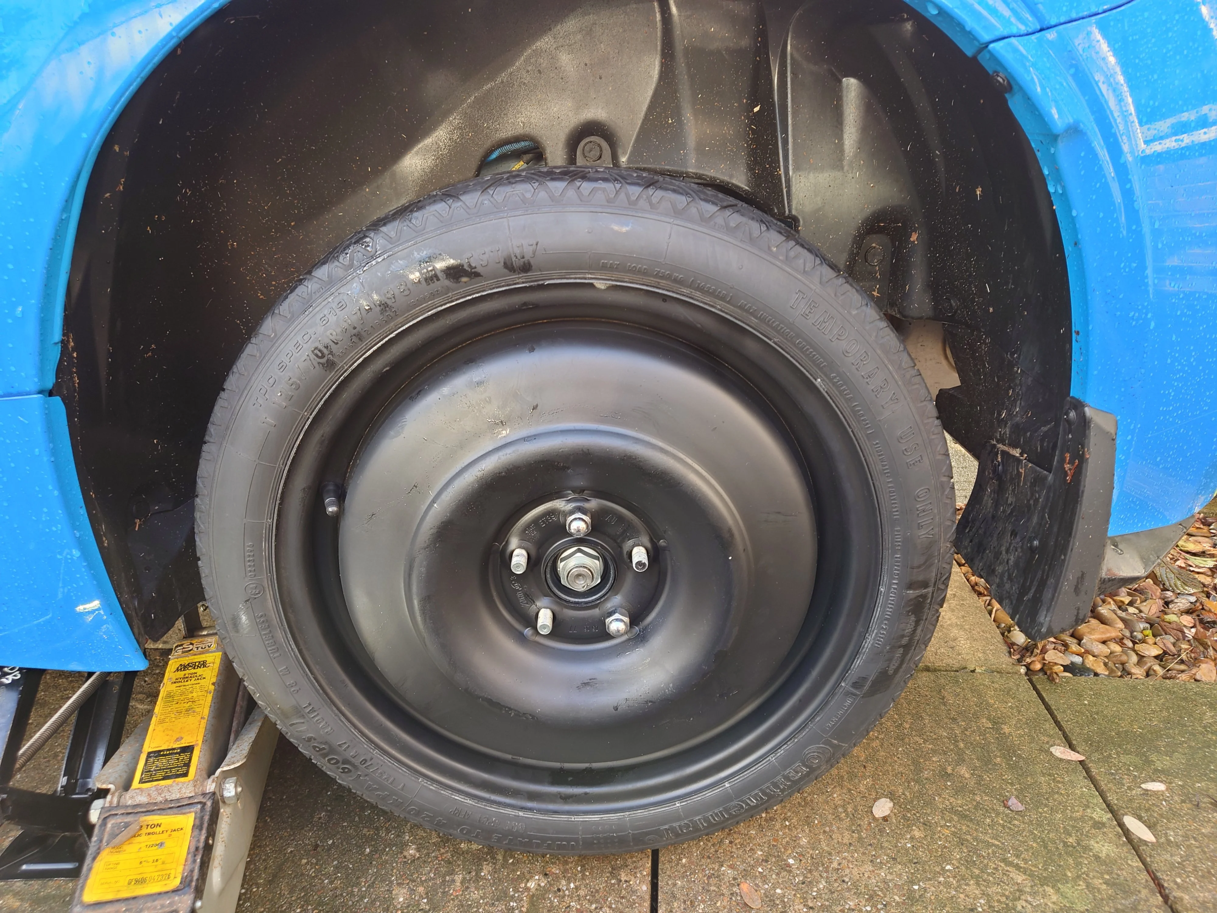

Double checked my spare from SpareWheelKing this morning. It fits!
I'll be looking for an 18" spacesaver soon as I don't really feel at ease travelling with just a can of deodorant in the boot.

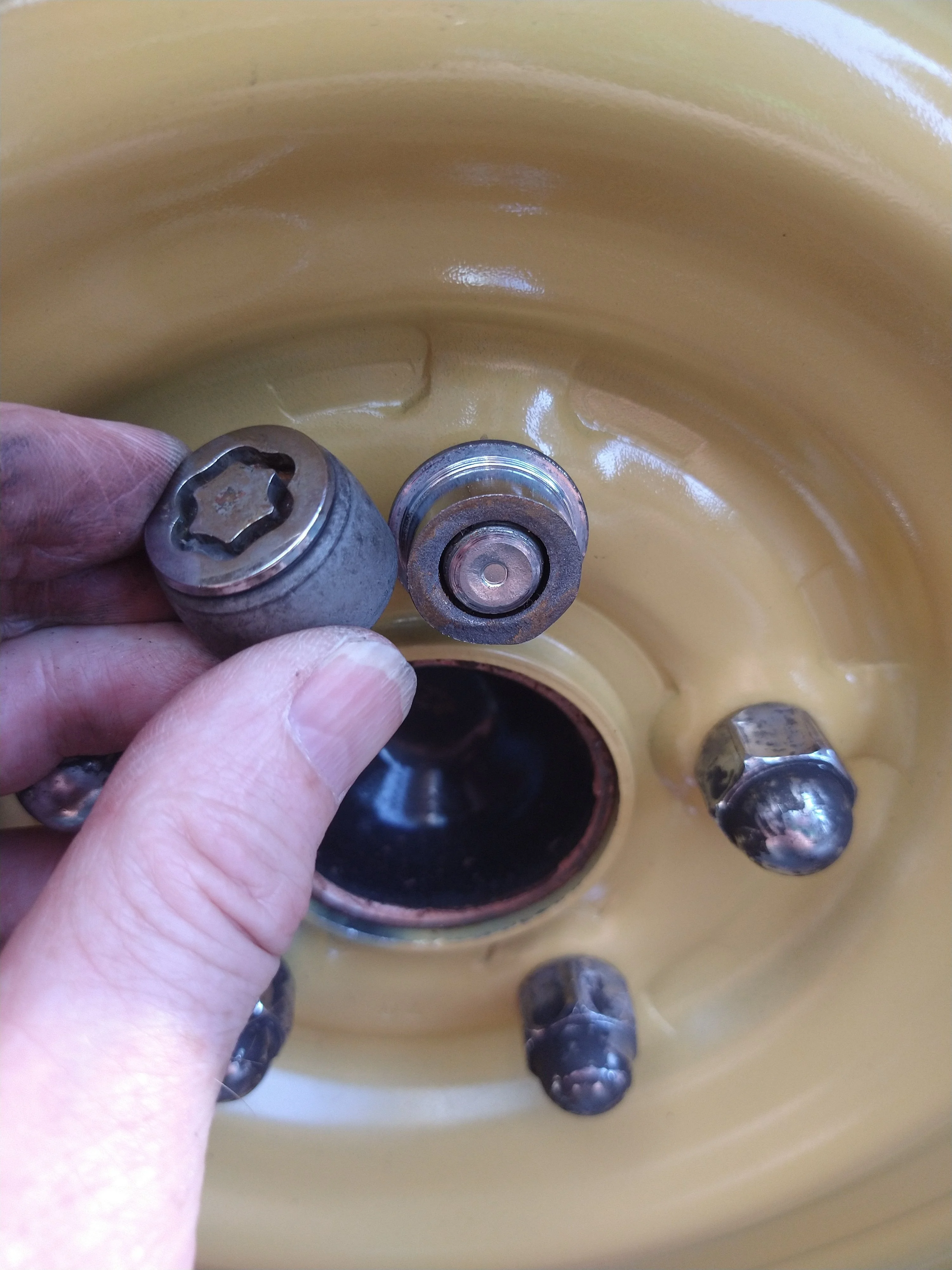

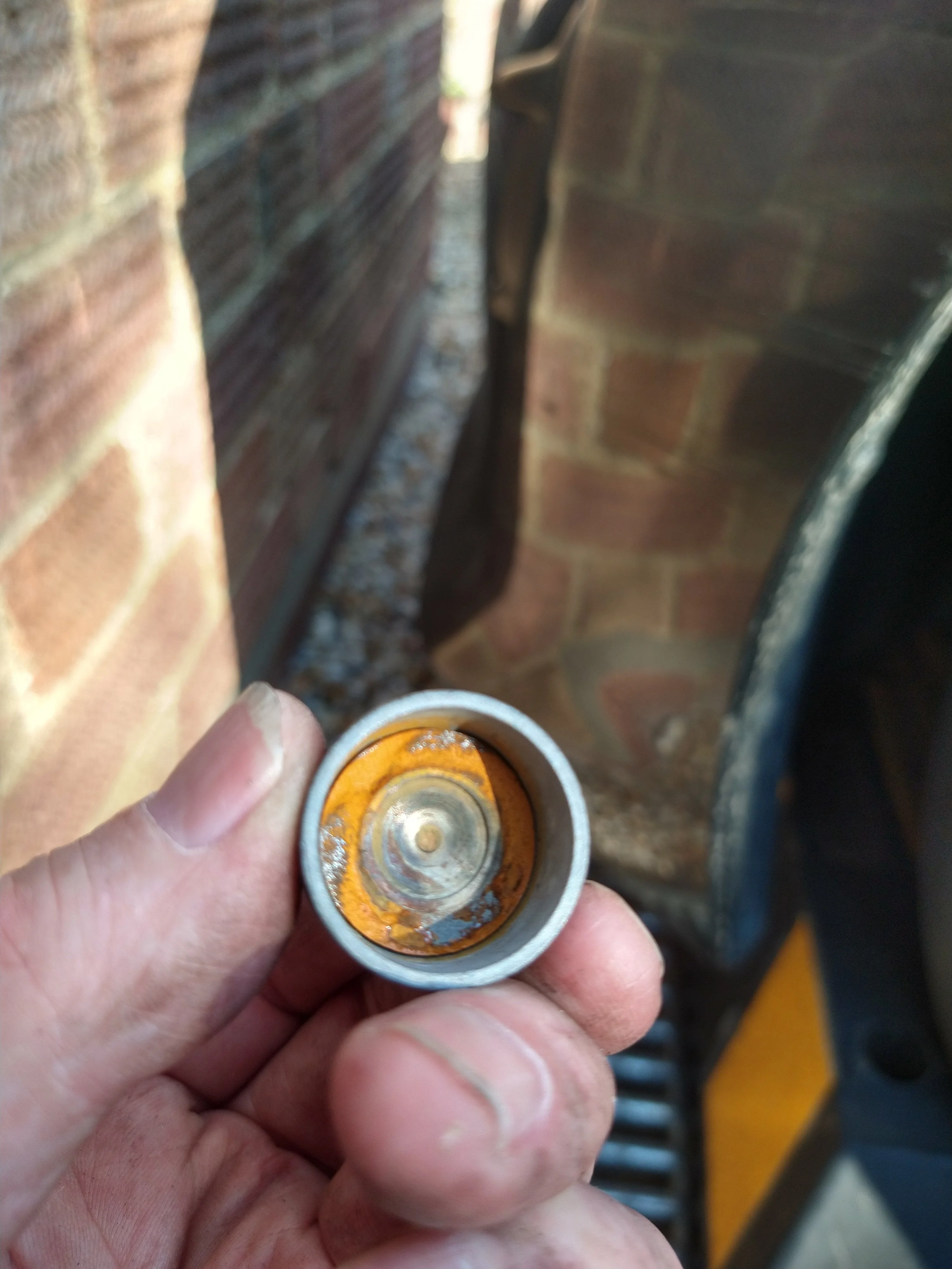

Did you use different nuts to attach the wheel? I put on the space-saver when I took a wheel off my former GT86 for refurb and the nuts only just reached the bottom of the bolt thread when tightened. The 5th nut I used was the locking wheel nut, but I didn't realise it had an even shorter thread and when I came to replace the original wheel after two very hot days, I found that the top of the locking nut had pinged off and landed a foot away!
Fortunately, I'd left the car on the drive and not driven it. I had to use an angle grinder and stilsons to get the remaining bit off. From the pics, it looks the weld had rusted.
One of the reasons that the first thing I remove from a new car are the locking wheel nuts. I’ve had many a stranding because they’ve either broken or the key way has stripped. I think the locking nuts nowadays really are made of cheese.
No, I used the same nuts. They tightened up ok. But, I didn't put the wheel on the ground to fully tighten them up. It felt like there was sufficient thread left to be able to do that without any problems.
And yes, I have had issues with locking wheel nuts breaking in the past. Had to get one drilled off on my last car!
