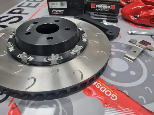

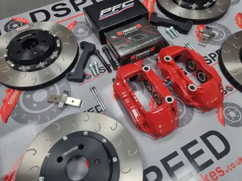

After some positive chats with Ian from Godspeed over the past day or two, there is now a new option on their website. A kit matching that available on Freaky Parts, as kindly shared by @Will300, but with a better standard disc and pad option, the option for changing caliper colour, and several other upgrades available.
You can find the kit via the following link:
The only real difference is, this kit comes with a 330mm discs, rather than the 325mm disc offered in the Freaky Parts kit. Still a simple disc to get hold of though, and Godspeed discs are of a really nice quality.
Pricing the two kits up:
  • Freaky Parts kit is £950 (less £80 without discs)
  • Godspeed discs are £150 extra
  • Upgraded pads are £150ish
To get the Freaky Parts kit up to the same standard as the Godspeed kit, the pricing is very similar.
I am personally going to be ordering this kit, partly because Ian has been extremely helpful getting the kit onto the site, sending me loads of information on it, finding out colour availability for my yellow preference etc., partly because it's less hassle to just get it all from one place.
You guys are obviously free to decide for yourselves, but at least there's now another good option!
Looks like a good value option and probably not wildly different to the Reyland kit in terms of outright performance/durability. Do the Godspeed disks have directional vanes?
Yes they do mate, at least as far as I can tell.
Ian has described them as "race vaned" discs, which I took to assume meant directional. From the photos of the discs on their website, they certainly appear to be also.

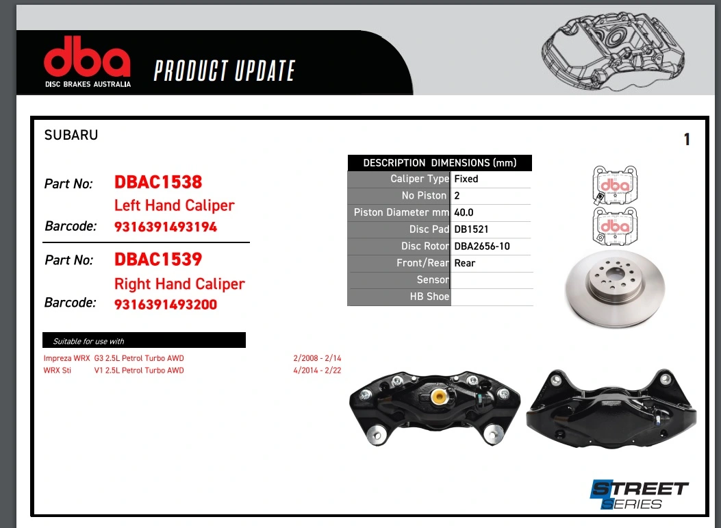

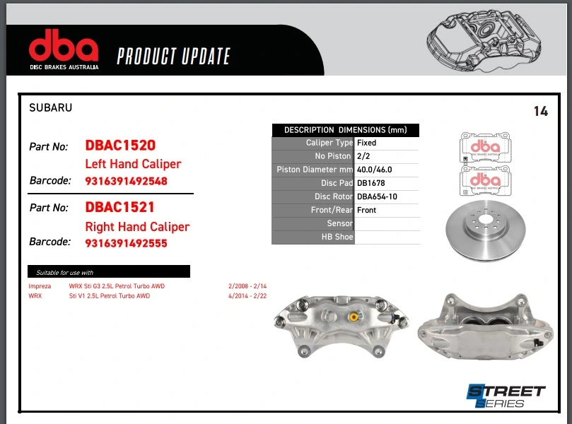

I have contacted the various eBay outlets of those cheap STi Brembo knock offs to see if they can source 40mm versions as the ones they list are the staggered pistons type for the Impreza. Most likely will say no but you never know.
There DBA calipers, they don't currently do a dual 40mm piston version.
Yeah they got back to me and said they do not do them. Maybe I will contact DBA direct. It shouldn't be hard for them considering the Impreza ones are exactly the same bar piston sizes.
I would expect they would get a lot of business their way.
