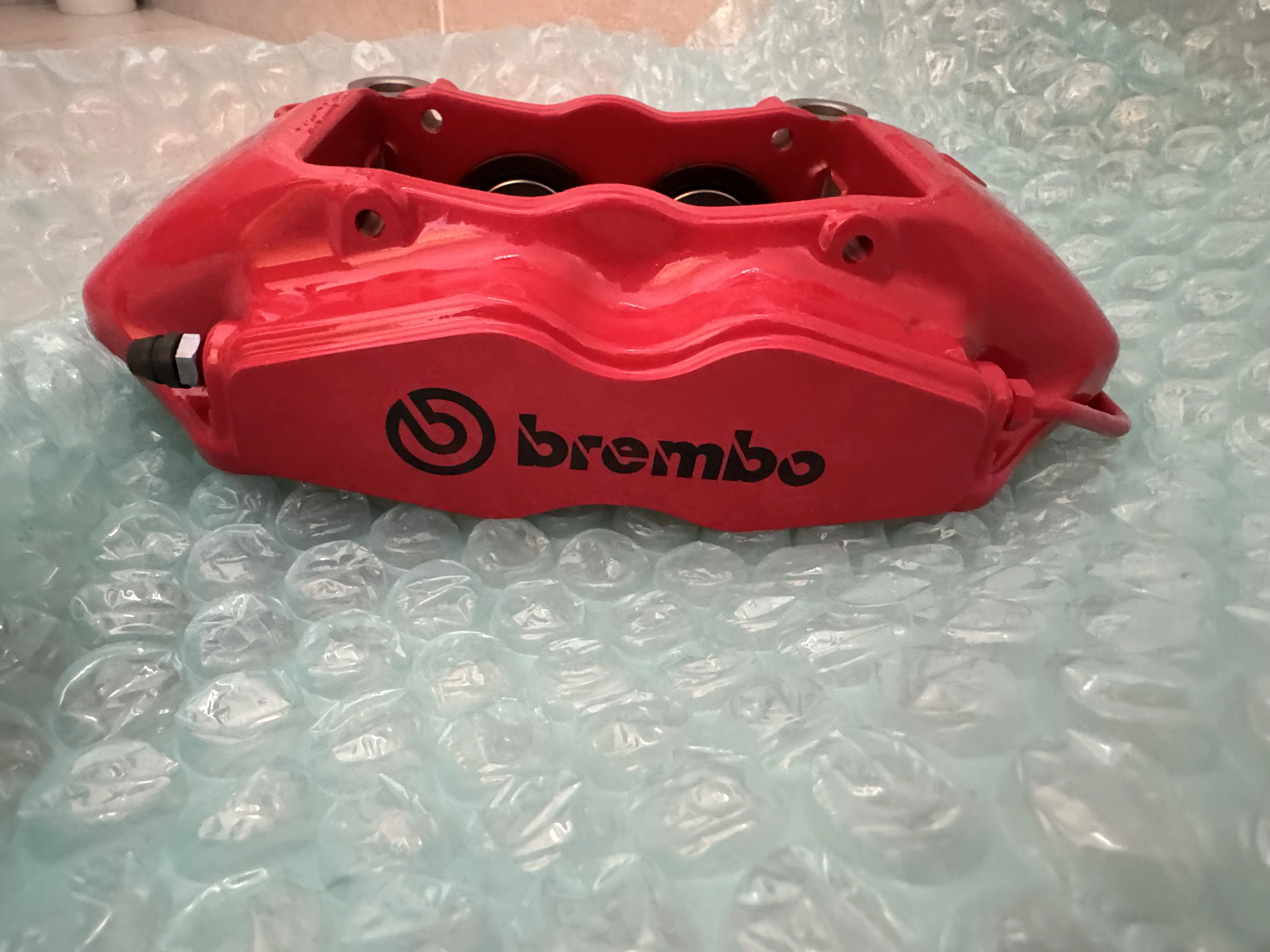

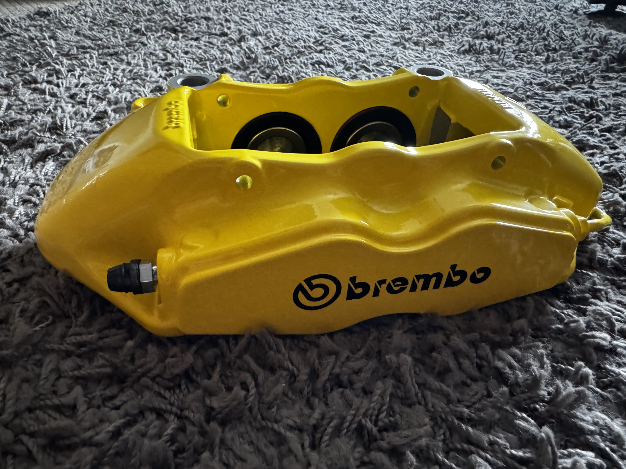

Just had an email from Ian at Godspeed. The rear kits are now in stock. This includes a set of new STI calipers (powdercoated in a colour of your choice), 316mm discs, pads and all necessary fitting equipment.
They bought in 5 sets of calipers as a trial to see how they sell. They're available to order now at £695.
Thanks to @Will300 and his continued work on this, we can see that doing this yourself would cost approx £672, so you're paying £23 more to have a full kit from one place. Pretty impressive value.
To order, email: [email protected] and don't forget to say you got referred from here. The more support he gets from here the more I can improve our terms of supply :)
Are they OEM disks and pads out of interest? Does "fitting equipment" include new hoses? Seems like a good option, especially if I can colour match the fronts.
