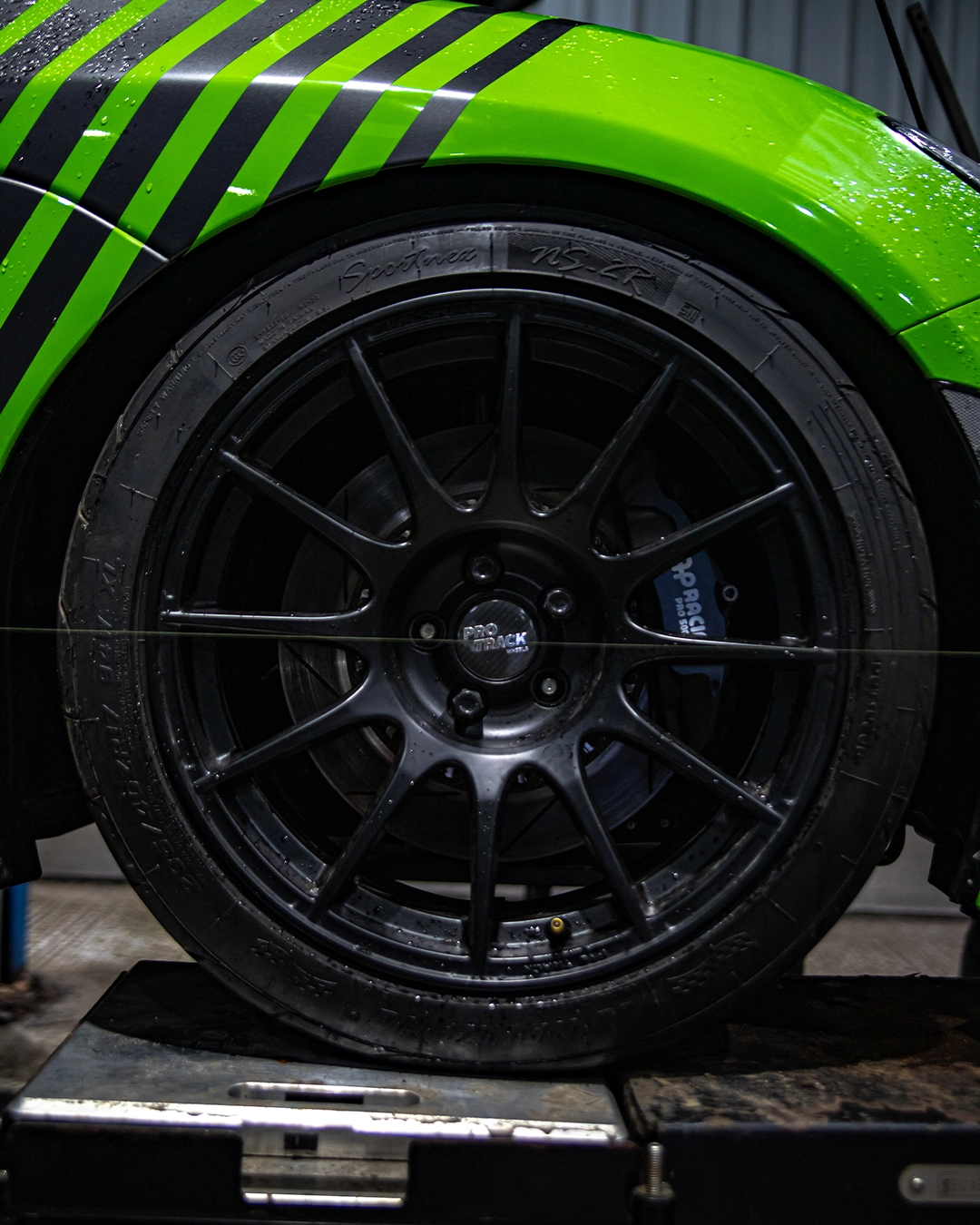

There is a trackday rental company called Hype Motorsport (https://www.facebook.com/hypemotorsportuk), who are running an AP Pro 5000 R caliper on their GR86.
Looking at the photos on their facebook page (below) and comparing them to the AP Racing catalogue (AP website) & Race and Rally (https://raceandrally.com/cp9440-pro-5000-r-4-piston-radi-caltm-caliper), the caliper definitely appears to be the CP9440. The car is also fitted with 17" wheels which would limit options of 6 pot calipers.

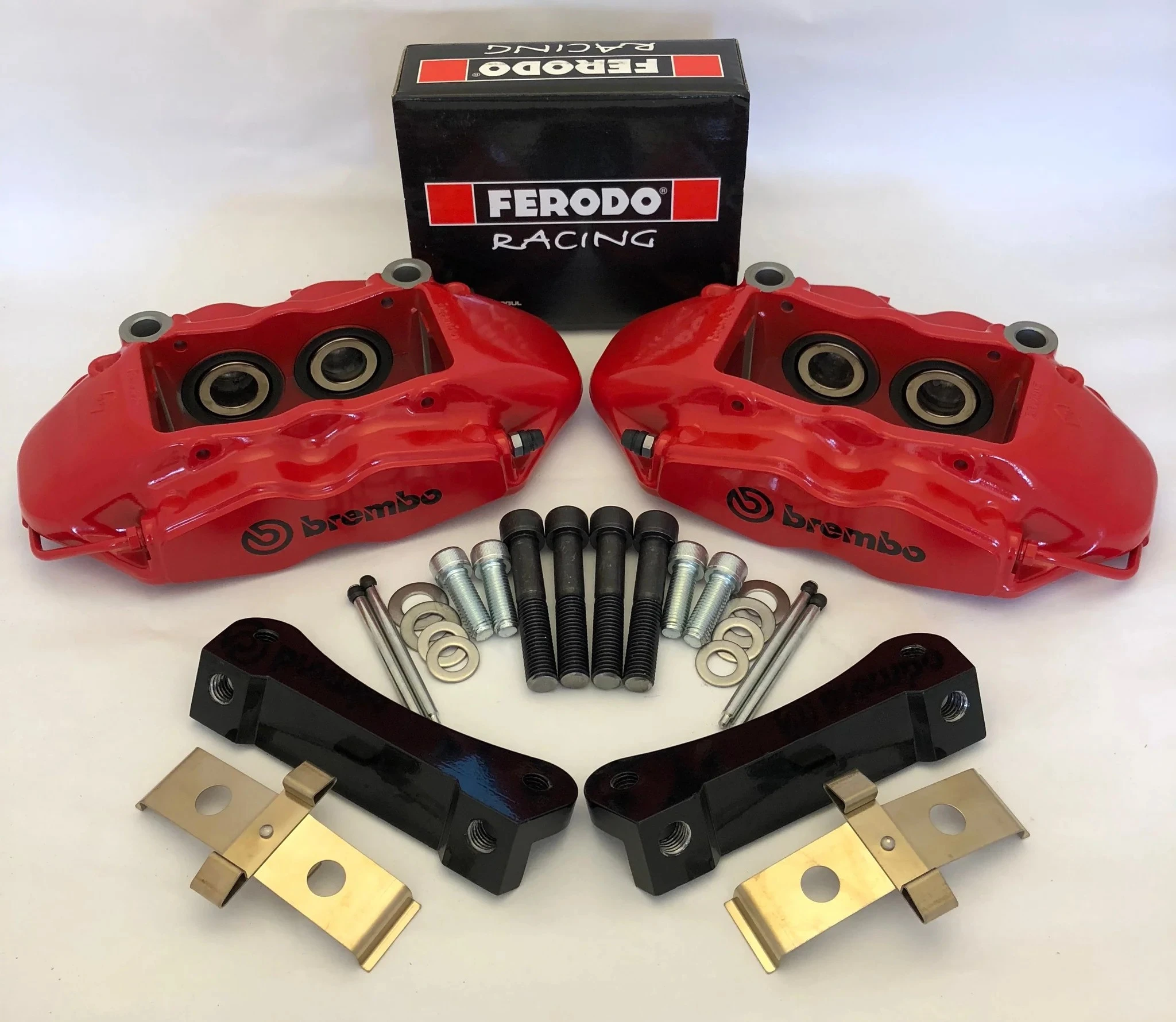

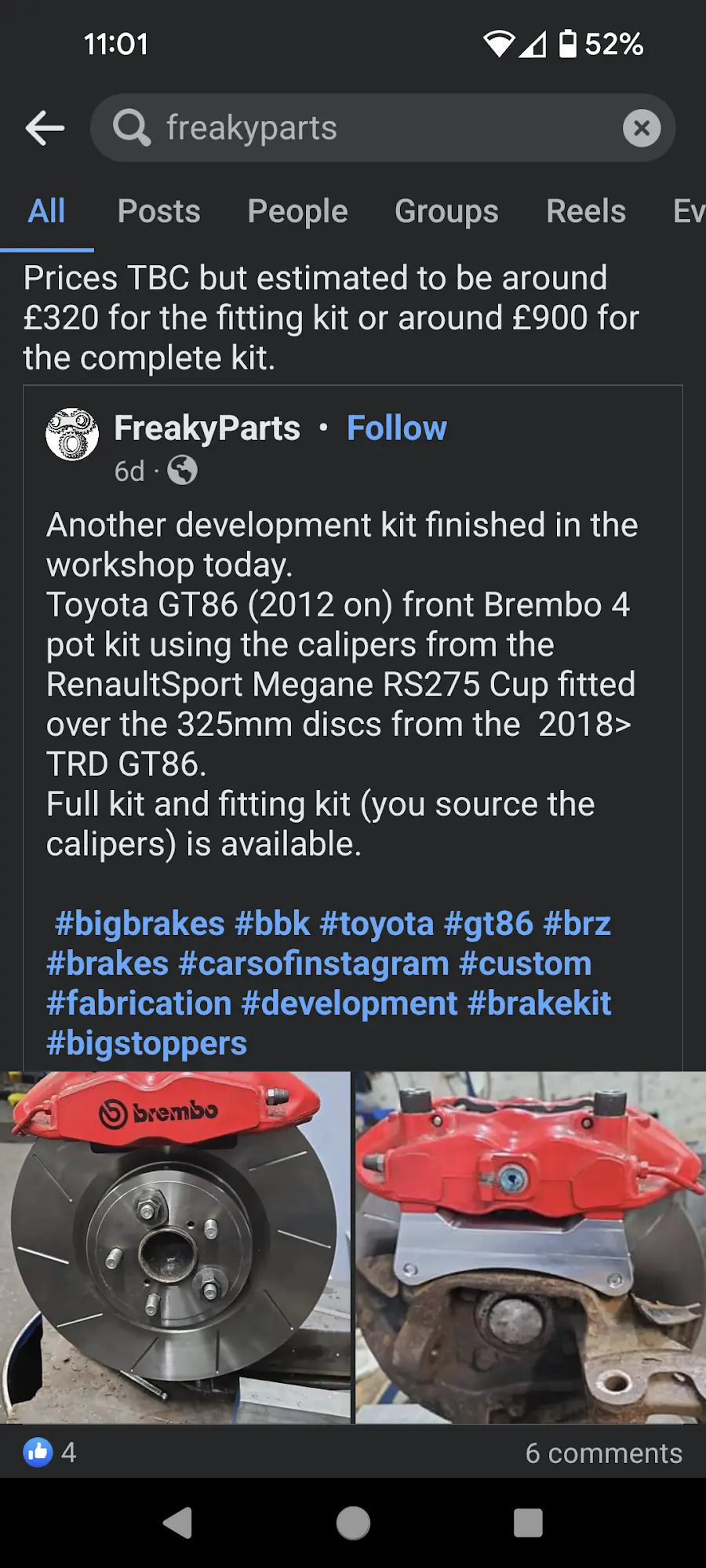

Those of you looking for a cheap option for BBK, then a company called FreakyParts have just developed a Brembo conversion kit, using the Megane 3RS calipers (not the STi brembos), which have a 40mm x2 piston size, 326x30mm MTEC grooved discs and Brembo pads, for around £900. They also offer a fitting kit, so if you've already got a set of the Brembo calipers you can just order this.
Full kit includes:
Calipers
Brembo pads
Adaptors
Bolts
Longer custom braided brake hoses
All brand new parts as well.
Fitting kit comes with:
Adaptors
Bolts
Longer custom braided brake hoses.
This is basically the same setup that Misha ran on his GR86.
My only recommendation would be to buy different discs, as the ones that the kit comes with are very basic/cheap options. And chose another pad option other than the Brembo, they offer Ferrodo PBS ProRace, Ferrodo DS2500, Pagid RS29, which are all much better choices.

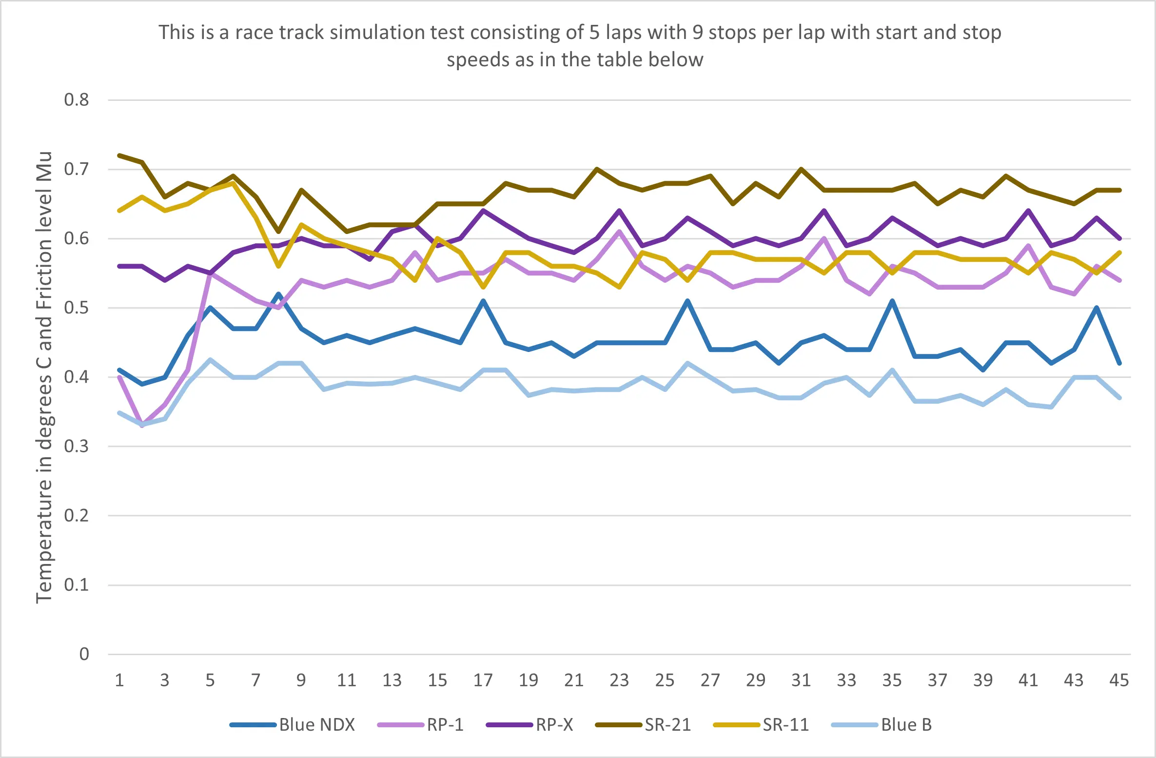

Ideally yes you want a similar coefficient front to rear, I'd say bluestuff as I know they stand up to track abuse fairly well. Although my main concern with Bluestuff would be cold use (road) / inital warm up (track) as they have a higher friction level than RP1 at lower temperatures.
Having the rear bite before the front is not ideal, as I've had that in the past with Ferrodo DS2500's (Front) and Cosworth StreetMasters/CS-Pro (Rear) and its very easy to upset the car under heavy braking. However the only way to know for sure would be to try them.
Here is a track simulation performed by EBC, that compares their track/race pads, you can see that blue stuff has higher friction than RP1 in the inital warmup phase.
As for RP1 vs RPX, I've used RP1 and they are an excellent pad with good modulation, decent bite at all temperatures and stand up to alot of abuse, and they are extremely cheap (£105.73). They do wear unevenly though, so require pad rotatation. I'm yet to try the RPX, however if I compare the RP1 to PFC 08, the PFC 08 have a better bite than the RP1, so I'd suspect the RPX to be similar to the PFC 08, maybe even more aggressive. I think the RP1's are perfect to use with a road tyre (PS5, ContiSport 7, etc) and the RPX would be better suited for a track tyre (AR1, CRS, AD09, A052, Bridgestone Potenza Race, etc).

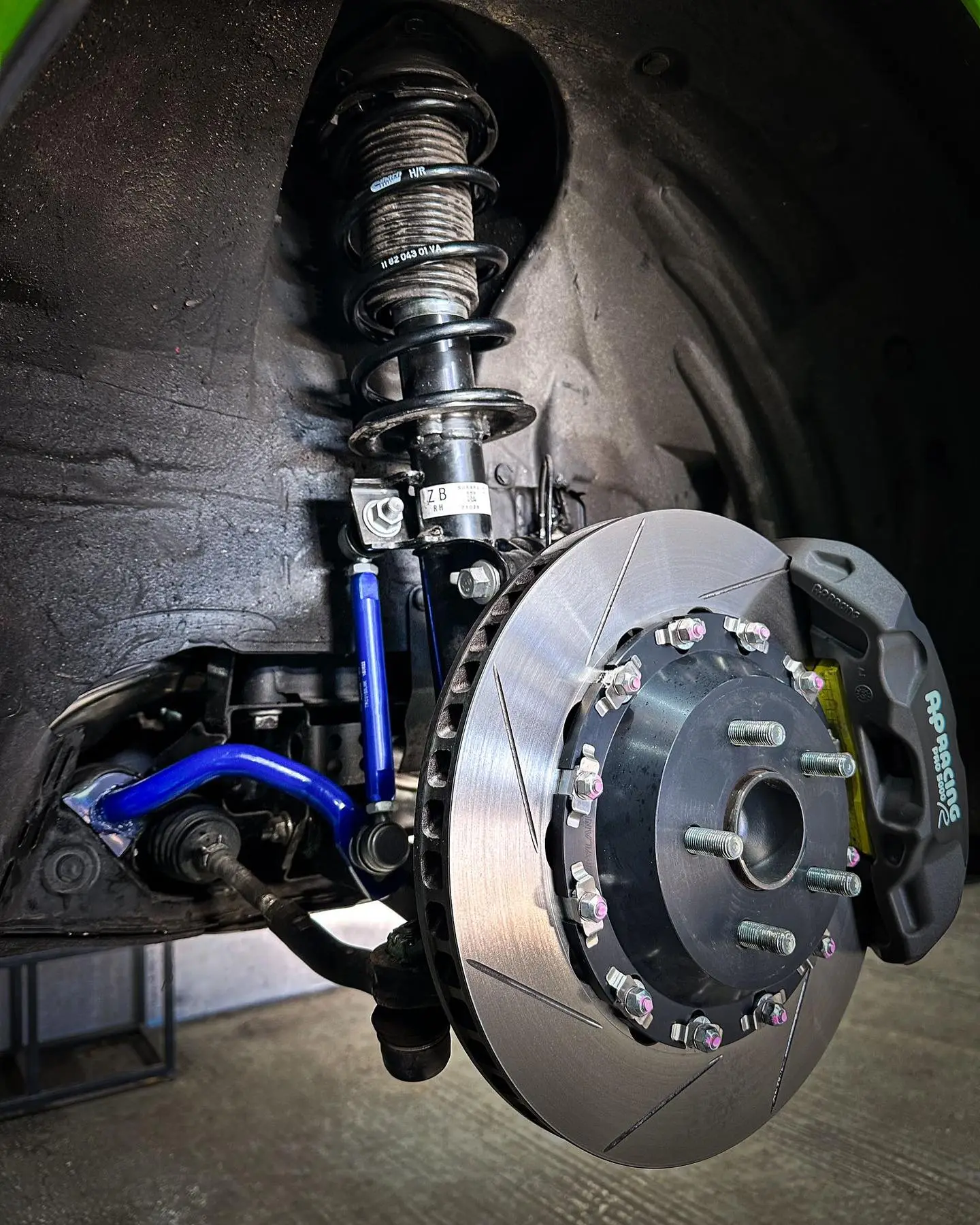

Started fitting the Reyland kit today but I’ve ended up having to source some 0.5mm shims to make the disc sit truly central.
It probably would have been fine but one of the pads was very snug as a result and if anything is worth being a perfectionist about it’s brakes.
