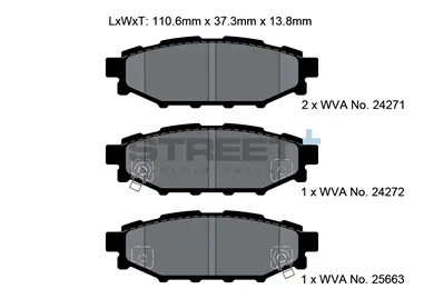

Hi all,
I'm no pro driver, but I love a track day. After testing a lot of different pads over the years I've been really impressed with Pagid pads, most recently the RS14 grade.
They're not as initially bitey as some track pads I've tried, but they're fine from cold, they have higher friction than regular road pads, they have superb longevity and they give superbly consistent pedal pressure through the temperature range.
I couldn't find Pagid options for GR86 so I contacted their technical line and got the following feedback, I thought might be helpful to add here:
"Thanks for your request. Unfortunately I cannot see the pictures you attached. The GR86 uses the same pads for front and rear like the GT86. These are the PAGID Racing shapes 8174 and 8175. We list them as on inquiry on our website but we have stock of RSL1 pads for the front which is a similar compound to RS14. The RSL1 has a longer pad life but is a little bit less progressive in friction level development over temperature. For the rear we also have RSL1 pads available.
The part number you need to request are:
S8175L01001 and S8174L01001
We also have pads for this car available in our Street Plus range which is our compound for street cars with a small amount of track use.
https://www.pagidracing.com/en/products/street-brake-pads.html
Here you can have a look at the article numbers:
T8047SP2001
T8065SP2001"
