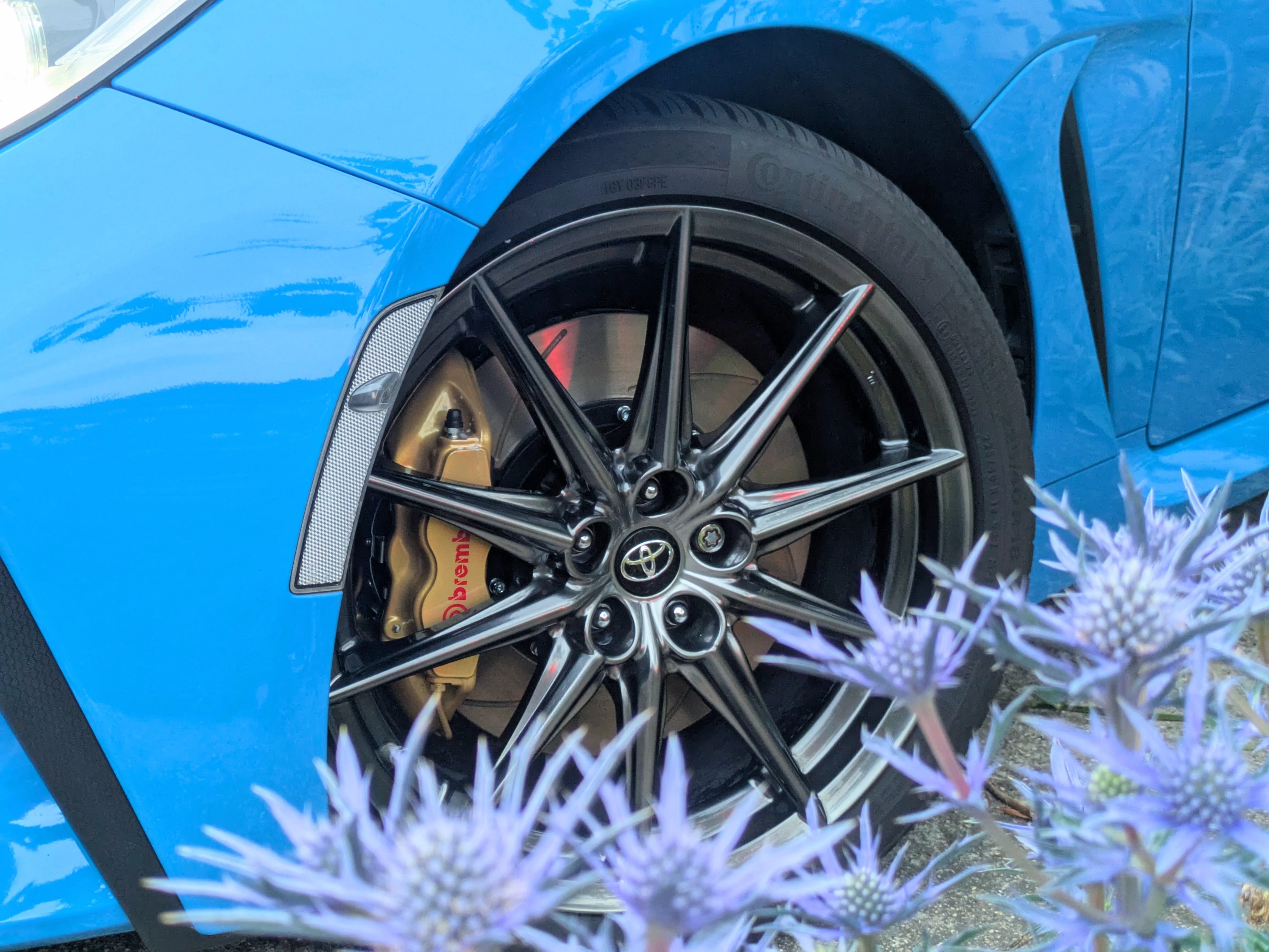

Big thanks to @Godspeed for customizing and supplying some RS 3 Megané Brembos, repainted in gold in a nod to the many gold brembo calipers of past JDM cars. Maybe not for everyone's tastes but they're right for me, also blue and gold together, come on.
How much were these fully fitted? Have you noticed improved brake performance?

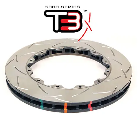

Just ordered DBA 330mm rings that are compatible with the Reyland bells.
It will be the first time changing them over DIY so wish me luck.
I had really bizarre corrosion issues with the original Pagid discs so I’m hoping these will be a lot better given they’re coated.
I did this a week or so ago, its fine but get a rubber mallet ready to separate the bells from the old discs. Also would suggest using a wire brush attachment on a drillbit to get each face as clean as possible (please dont use it on your own face) when reattaching. Mine had a teeny bit of pitting that was quickly sorted

I was wondering if any might know, having upgraded my brakes last year to the @Godspeed Mégane kit is it possible to fit 17's over them?
I wanna get some new wheels and given the current state of the roads which are liable to get worse, perhaps 17s with bigger tyre sidewalls would be prudent..
Love
Godspeed say it's does.
