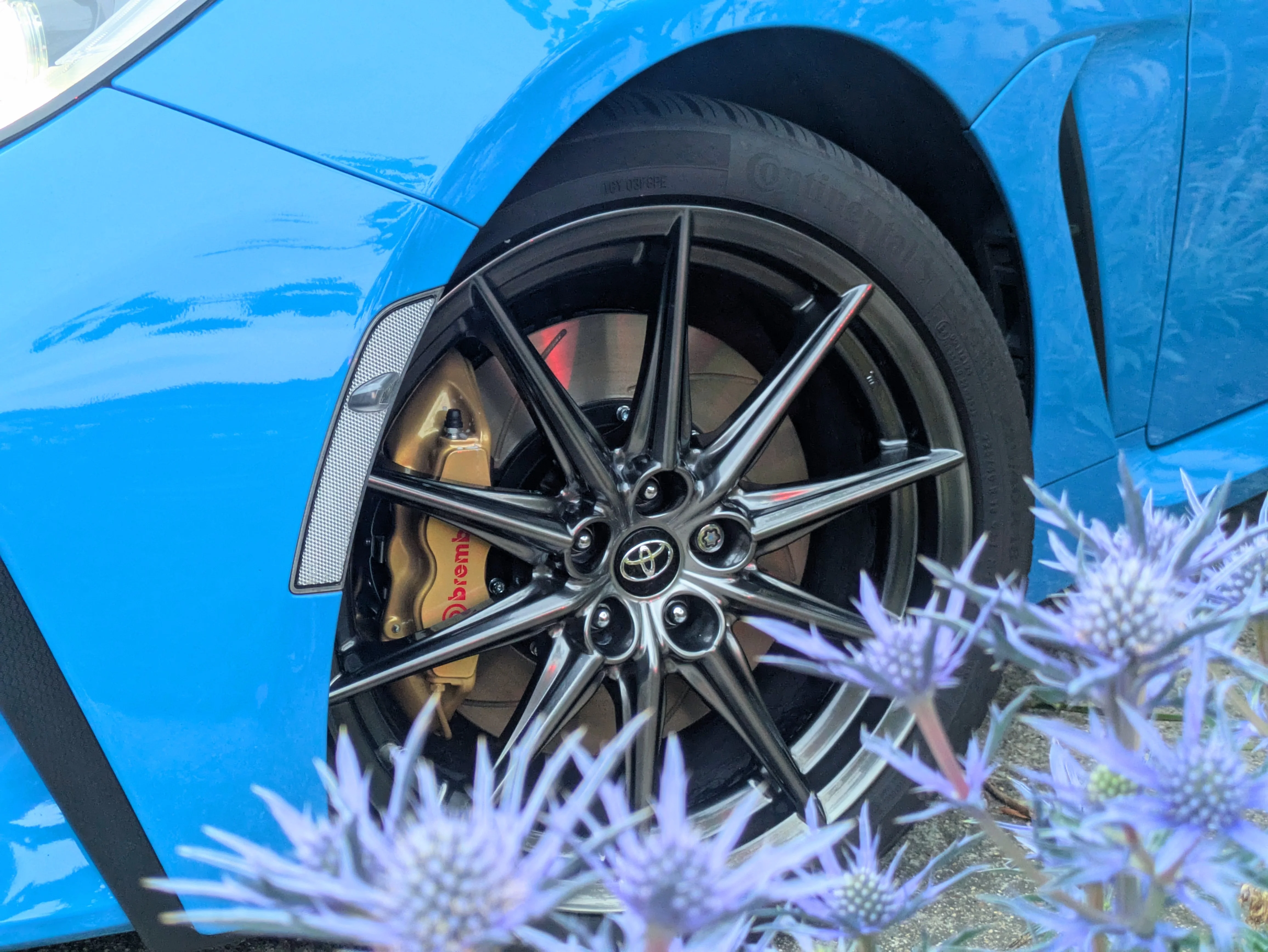

Big thanks to @Godspeed for customizing and supplying some RS 3 Megané Brembos, repainted in gold in a nod to the many gold brembo calipers of past JDM cars. Maybe not for everyone's tastes but they're right for me, also blue and gold together, come on.
That's nice. Was debating the standard Red or Blue but Gold would work well with my wheels too.
Nice choice. Did you have to hold a pot plant just out of frame for that second ‘arty’ photo? 😄
Hahaha it's definitely someone I'd do but on this occasion just shooting through my driveway flower bed 😁
You're very welcome , they look great in that colour
Thanks Ian
