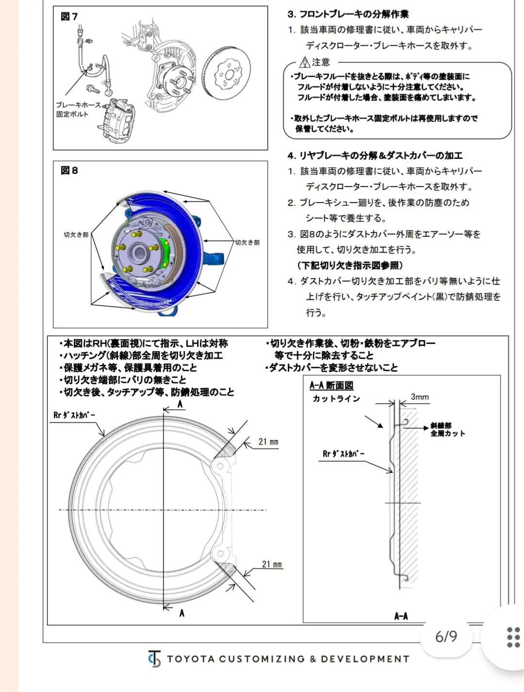

Me again. Has anyone installed the Godspeed kit themselves? I thought I could retain the front dust shield but the disc makes contact with it, no big deal to remove . Just trying to to see how best to deal with the rear dust shield now...

I finally got my Godspeed BBK on, bit of a faff with the rears, trimming the rear dust shield, but actually only took an hour including painting in cut edge.
Biggest issue was the rear discs stumping me somewhat as the holes were slightly too small to clear the shoulder on the studs, had to refit oem back on all four corners last weekend as I had a service appointment Monday. Anyway, quickly resolved by Godspeed and got them all on in a few hours the other day, just to bed them in now.

Why is there any faff with a BBK kit at this point? Had a kit from Wilwood for a MX5 previously and it was as simple as remove OEM and fit the new kit. I get when the GR was fresh out the box but after all this time why are owners having challenges fitting supplied kits?

I was lucky enough to purshase these second hand, Stainless steel lines were brand new, what a difference, night and day looks and performance, fitted myself, very easy install, cutting dust shields was a chore but not rocket science
