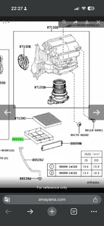

Has anyone replaced the pollen filter? Does anyone know why there should be a filter case but mine doesn't? Did they forget it in the shop? Or should it not be there? Does anyone care to look? It's simple.
