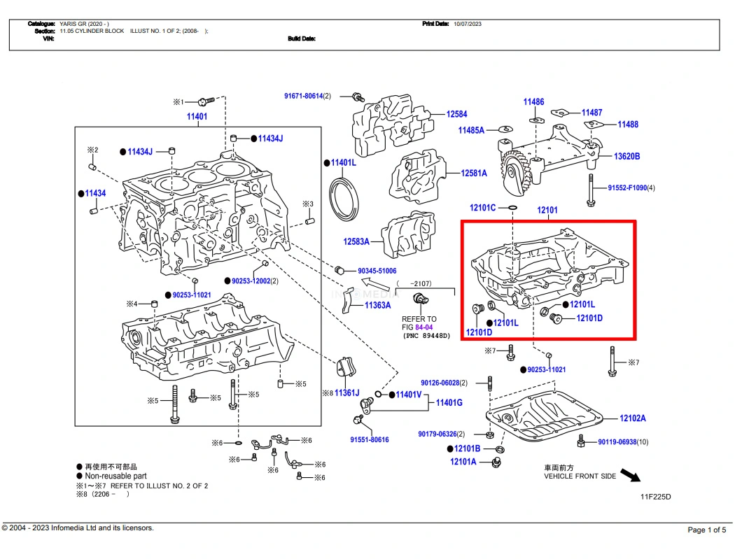

The baffled sump design from Lamspeed looks fine, not sure about the rubber trap doors ?
My thoughts are would it be possible to add a 10 or 15mm billet sump packer to gain oil capacity with longer bolts, obviously you then need extend the oil pick - up the same amount and the same with the baffles if that's possible .

assuming the pan is close to same form finding it quite difficult to believe it would make any difference. its the problem of oil pickup + actual oil chamber where the pan itself does little if the form is the same.

I didn't see similar pressure drops on track with baffles installed. my camera angle was not best so can do the retest next week thu once back on race track.
