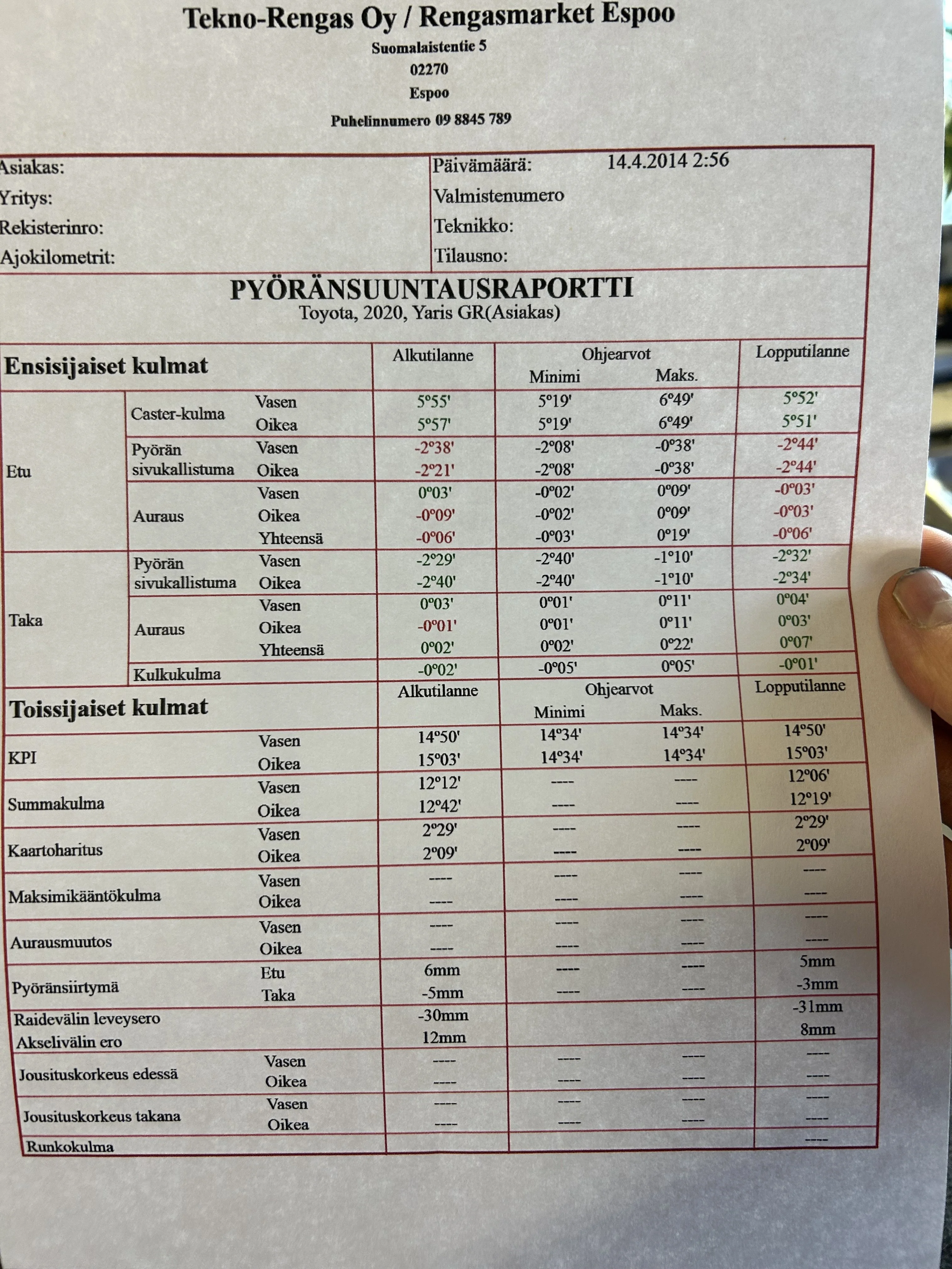

New setup.
Not sure if that toe is good (50%) what it used to be but lets see.
Front camber now -2 3/4 and rear -2 1/2

Can you / someone else tell how much more dynamic camber the 0.5 degrees are giving us in corners? Thanks!

I would be interested to know what caster setting Toyota set for the MK2. And the thinking behind it, if it's lower than for the MK1.
Will be surprised if someone can give a straight answer. On some alignment machines you can turn the wheel and read out the dynamic camber. It varies with the turning angle obviously.
You can see it as follows, if you were able to turn the front wheels 90 degrees, you will get the full caster increase in dynamic camber here 0,5 degree. So on a typical quarter turn higher speed turn in, we're ballpark 0,1 degree increase in dynamic camber. Not so much considering most can't tell that difference in static camber. Difference does increase in very tight turns where it can make a noticeable difference.
However, talking dynamic, there is also how the alignment changes under load, and here the relative soft stock bushing will move and reduce camber. Stiffer aftermarket bushing(s) will probably make a similar contribiton as the static angle changes, and compound they make it noticeable.
Fun part of this platform is that there are at least 3-4 bushing and similar amount of (fully adjustable) aftermarket lower arms available already, so you can optimise at infinitum if that's your thing....

as initial feel tend to agree with your opinion with toe out setup, before it felt nicer in steering.
So maybe need to redial it back, but checking the tyre wear first after this summer.
btw stock caster is -6 in GR Yaris. mine was half degree less initially, now back to stock reference more or less.
With camber I'm with -2.75' now front (or tyre shop guys prefer talking here 2 degrees and 45 minutes). Its always a matter of balance. Likely will not be able to dial all understeer off, but don't see that as a big issue. longer corners are though for gr and those just need to be managed somehow through, with patience. elsewhere I think the new setup will be fun.
