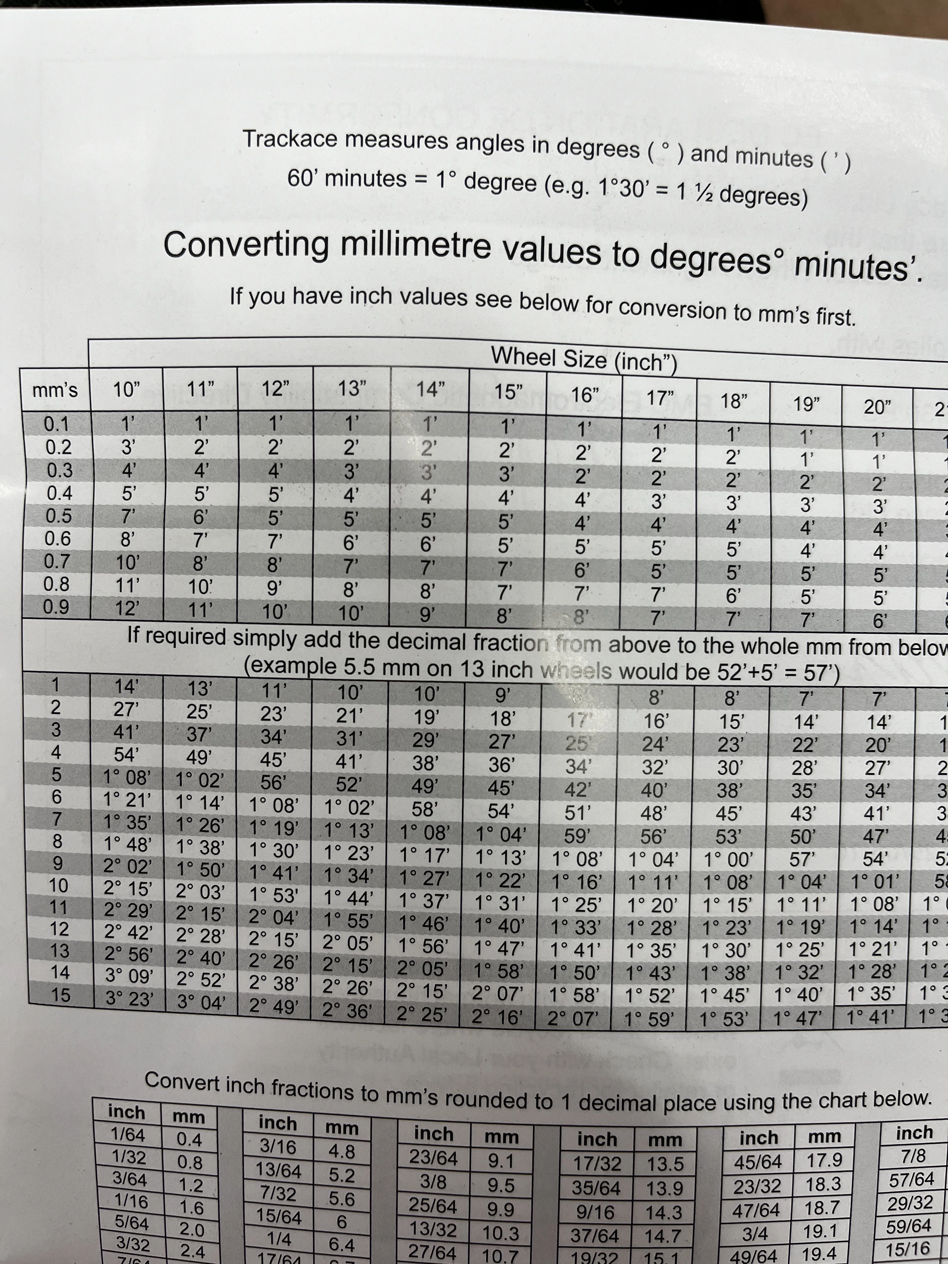

Then went back for an improved geo setting (-2.2° camber, slight Toe in but close to zero Front, -2° camber and +4' toe in Rear) and the PS4S was still very good.
Recently added some camber F, (-3°), and I do think it's a bit too much. Next will try -2.5° front camber should be the sweet spot with those toe values.
