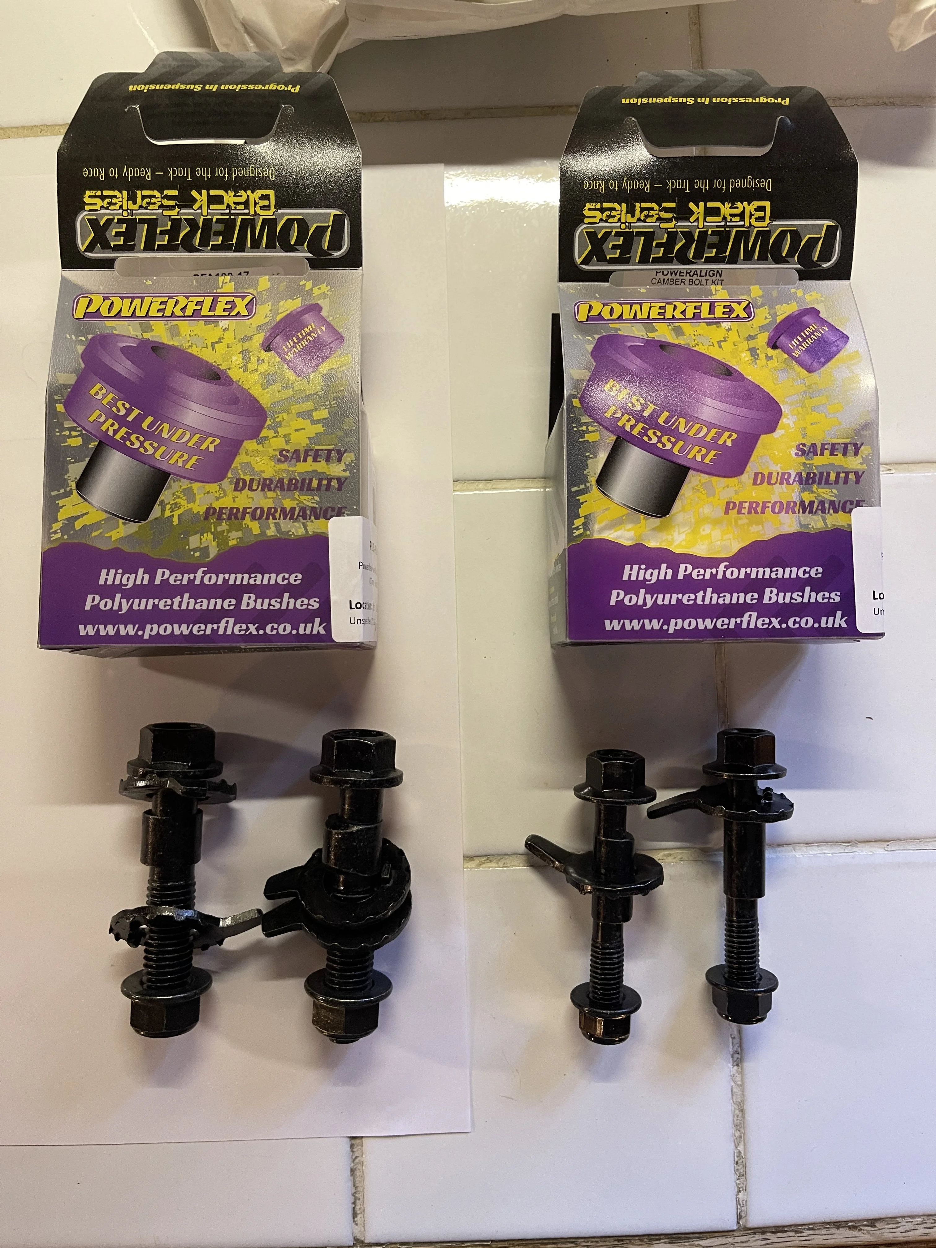

Caster is not going to wear the inside of your tyres and since it is not adjustable as standard, unless you have adjustable top mounts fitted it is most likely to still be as it was set by factory.Anybody got suggestions for caster settings? My inner front tyres have worn heavily compared to the rest of the tyre and have been told caster has the most effect on this. I have a caster kit ready to be installed. Currently running -2.5 camber on the front and have done for the past 2 years. I also have some rear camber bolts and -25mm whiteline springs so will be getting them all fitted together.

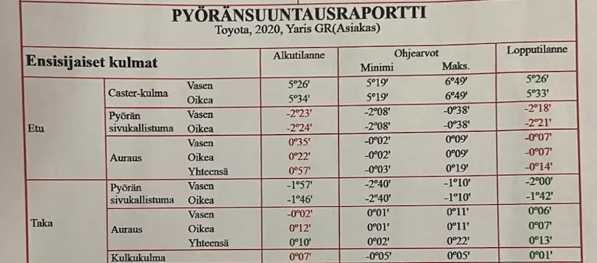

my current geo. Not sure about the "fast" part but try get a setup that works both road and track.I'm having currently following setup, and it is quite tossable (slides easily). Changed the car's characteristics much more lively and so far happy with it.
Though have only driven with Studdless winters in medium to low traction roads (winter conditions) so summer spec needs to be iterated if necessary.
I like to have my oversteer controlled, so that car does not have understeer but it turns in nicely. Have had few times little bigger oversteer due to lift off mid corner but this was mostly due to very slippery conditions (slush). Both my toe's front and rear were really off the spec so getting the car within the spec already makes it better..
as @Onehp says do small changes and check how it works.
Copied from @DeanoC from the other side
Front toe out 14minutes
rear toe in 14 minutes
front camber with one dot bolt maxxed out.
Stock suspension, mostly driven fast gravel road.
Lithium battery so car's rear is 16kg lighter than stock (making it more tail happy).
