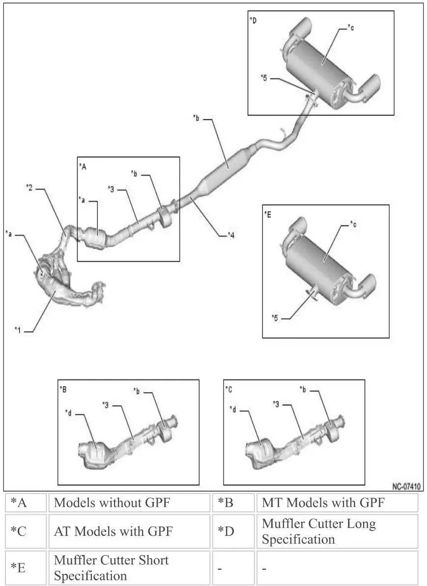

Official word is that the GR86's we are getting in UK will be fitted with a GPF. They were also kind enough to send me a pdf file showing all the parts of the exhaust system(s) used worldwide the for the GR86/BRZ. This shows GPF and non-GPF systems and also the shorter US spec muffler pipes due to their laws.
Given that the centre and rear sections (4 & 5) are identical between GPF and non-GPF exhausts I am hoping the "international exhausts" we've all been looking at on YouTube will fit. Whether they perform the same with a GPF ahead of them may be another question...?
I have also attached the full PDF I was sent.
