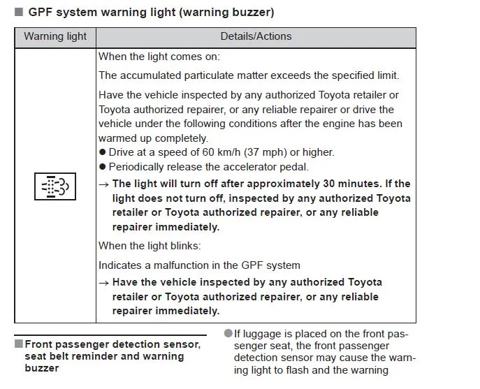

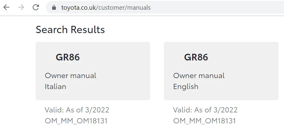

I am not sure if I am looking in the correct user manual (OM_MM_OM18131E_v1-1.pdf) but that manual does reference GPF on page 342:
GPF system warning light (warning buzzer)
Oh good spot! looks like i'll eat my hat. That is surprising. I wonder where this is fitted. Despite this we still have the full power (more than the US which doesn't have a GPF)
That must also mean Mazda will have to make changes in the future as their MX5 does not have a GPF.
Not clear again. In page 255 of the same owners manual * if equipped :unsure:
And thats the issue we (german whatsapp group of orderers) are struggeling with. Technically with D-4S injection combining both techniques, it should be possible that a GPF is not needed. GPF is a must for direct injections(only) cars.. and diesels, which neither of those is the GR86.
