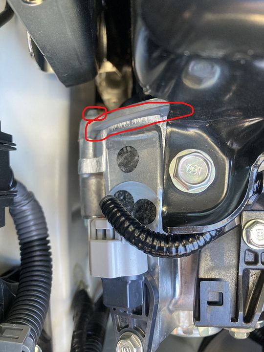

IF is the key word , didn’t engines on the GT86 fail after techs didn’t reseal things correctly , IF they had 🤷‍♂️ How do you know if You have applied the sealant properly without a borescope to check🤷‍♂️
This is very true. Personally, I think the solution is a nice old traditional gasket, you eliminate the human error aspect of too much/too little/too wet/too dry.
Not really, if they applied sealant properly there would be no need to inspect for debris.
Seems like a waste of time, you remove the sump to fit this one, if it's off you might as well just apply sealant properly and refitted the standard sump.
The RTV doesn't just come from around the sump, have a look at this drivers side cam cover on my GR86
Will be interesting to see how much is in the pick ups if they are inspected for a second & third time
This guy didn't find much the second time after re-sealing it a couple of months ago:
