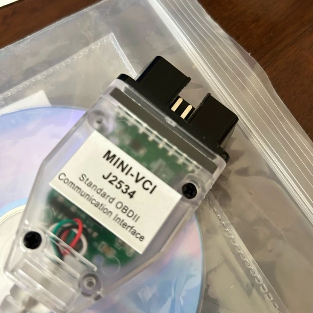

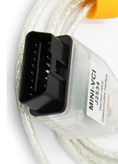

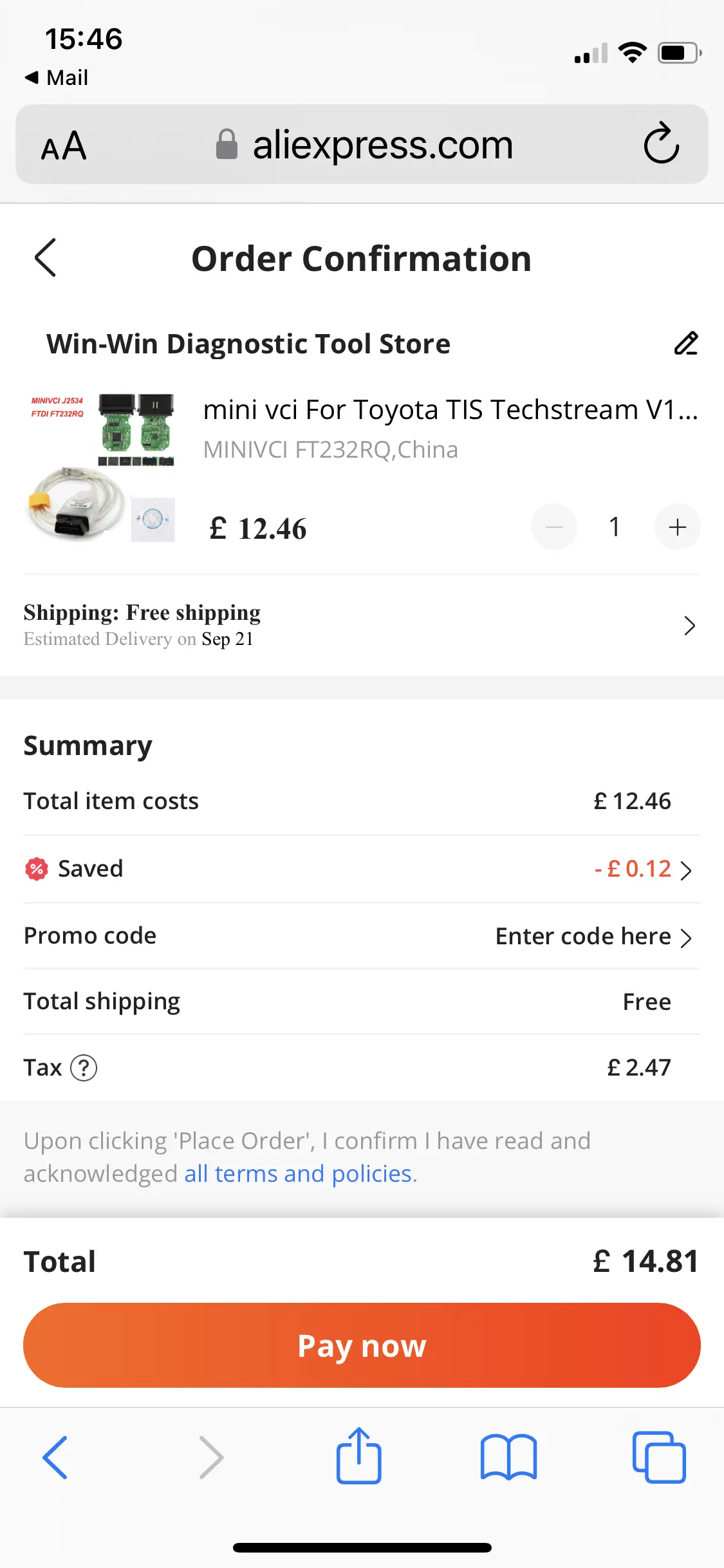

What option did you select on AliExpress? I ordered what I thought was the correct cable and got something completely different, and no software!
Does this look right?
This is the one I ordered.
I wasn't expecting it to come with the cd. Before it arrived I messaged and asked for the link to the download and they sent it through.
