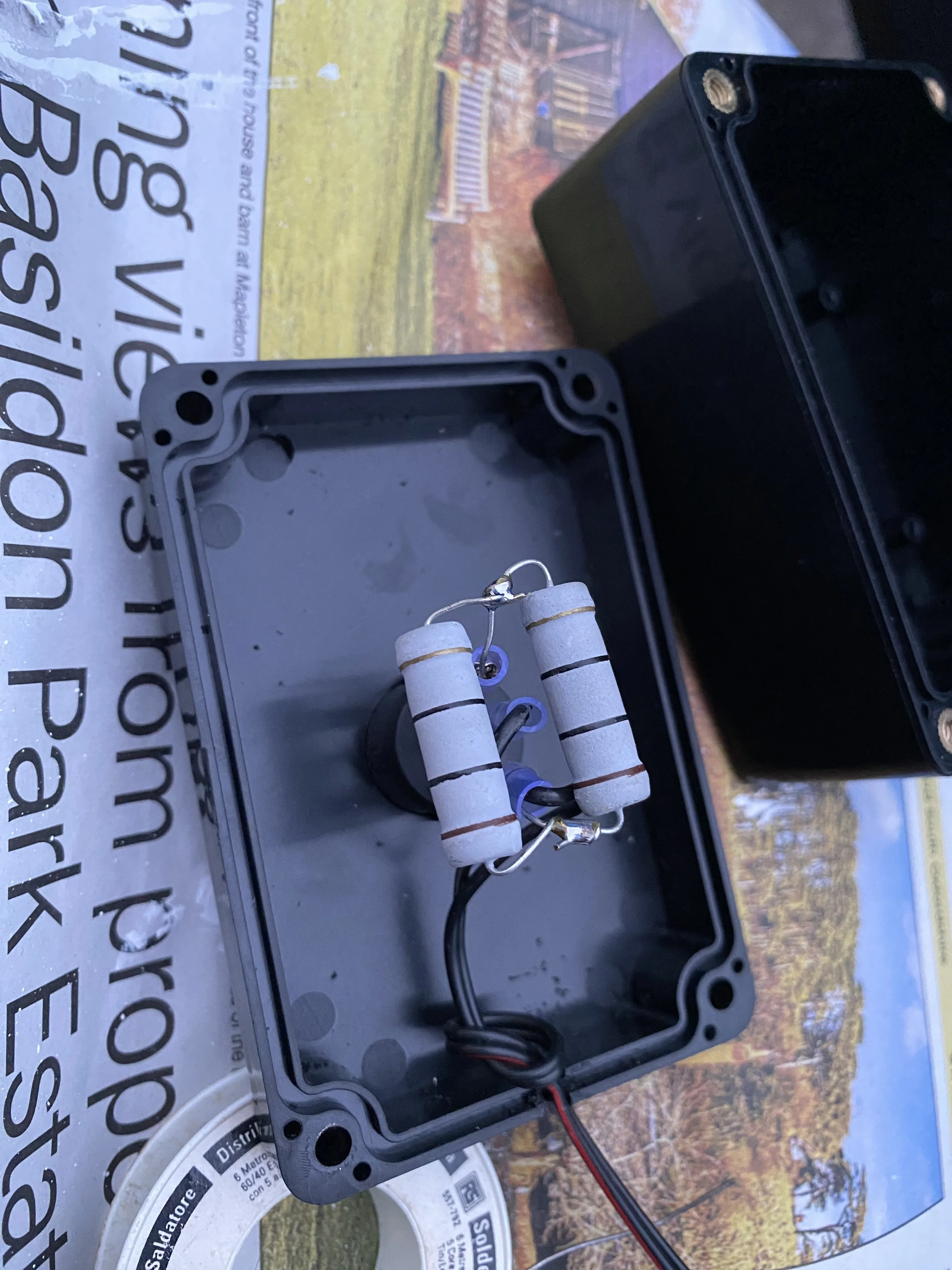

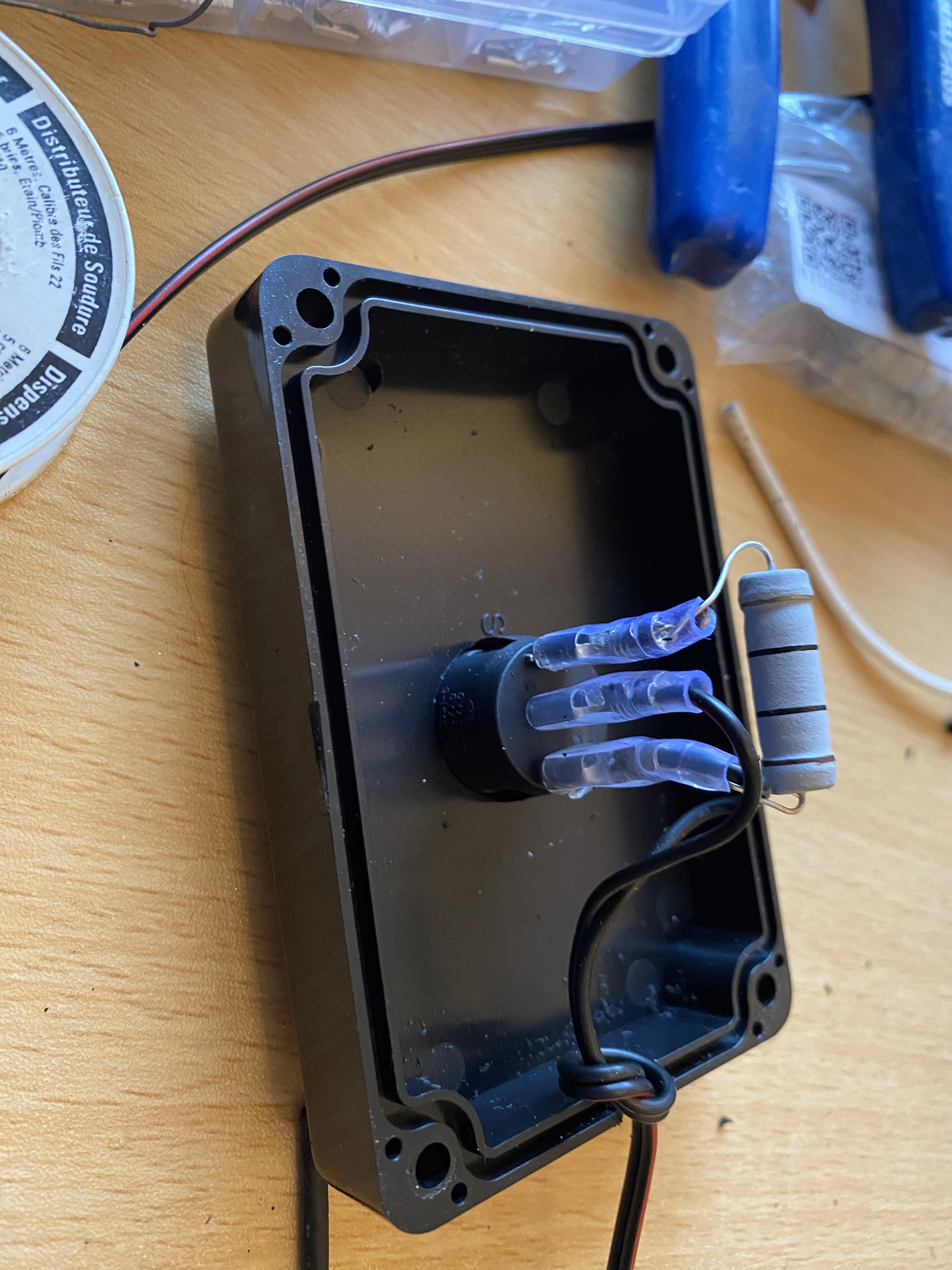

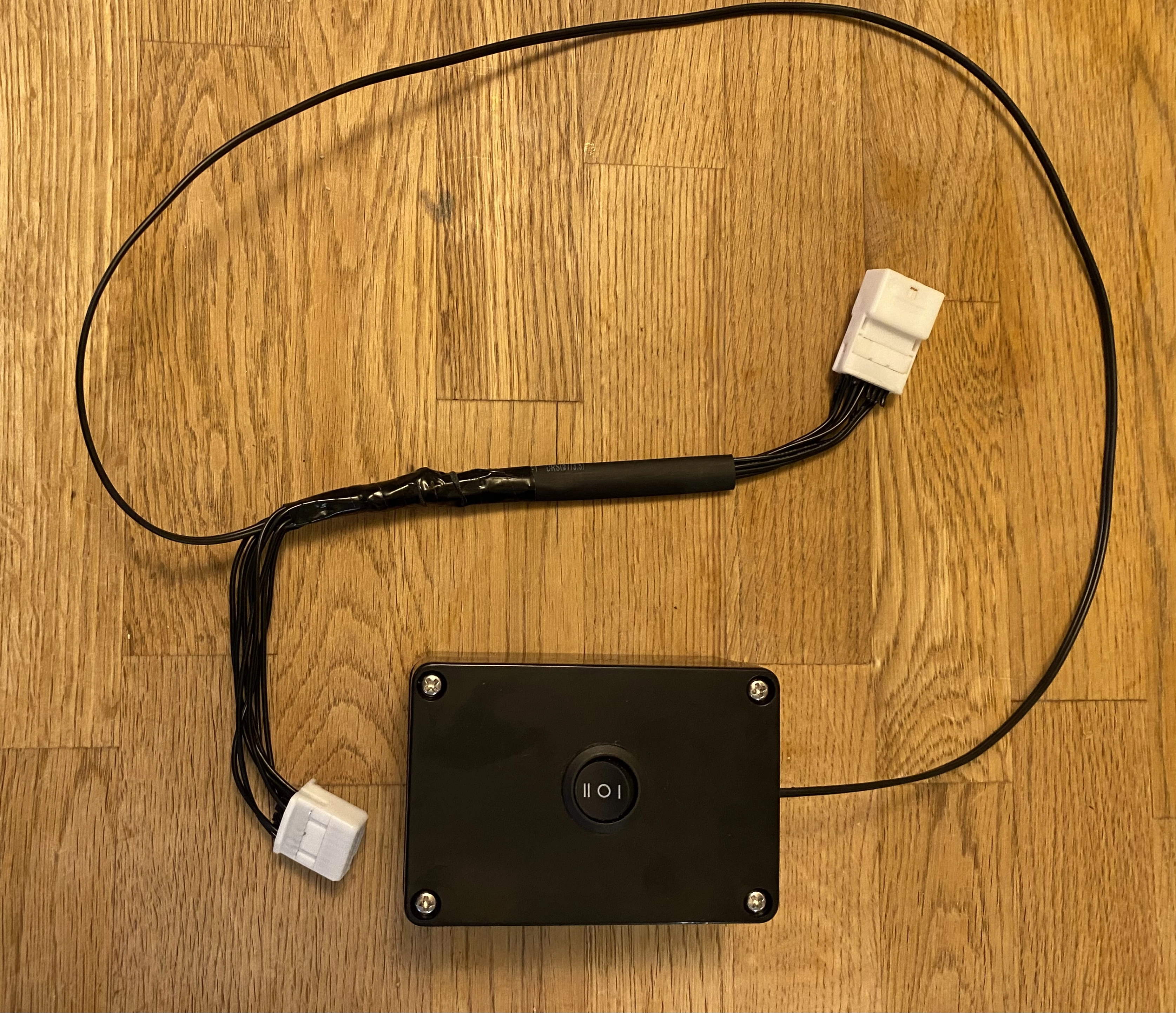

Managed to get my soldering iron out this afternoon. Can confirm the connectors are the correct ones. Very interesting to switch the asc on and off while driving and hear what is real and what is fake. I also had a switch position for a volume reduced asc using some series resistors to attenuate the signal. I started at 10 ohms, but that was barely audible, so put another 10 ohms in parallel (5 ohms) and that sounded pretty good - it took away some of the harsh boominess at higher revs and didn’t sound quite so fake. I might even try another in parallel (3.3 ohms).

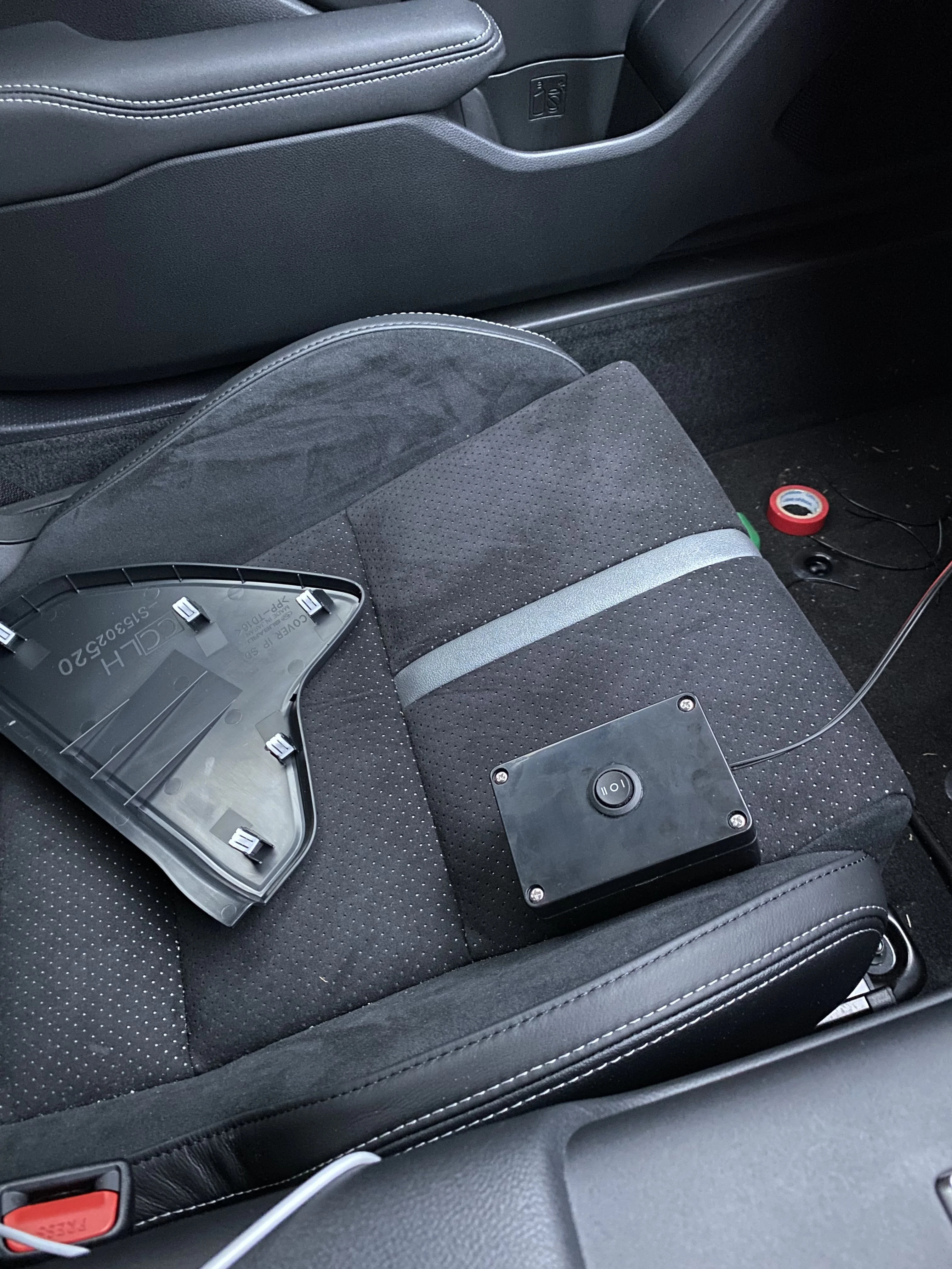

I can keep the little box in the glove compartment and have it on the passenger seat for switching the sound on/off. I might just fit the switch to the the small panel between the gear stick and the AC controls providing they are fairly cheap to buy in case I screw it up or want to put it back to stock.
Here are some pics…

There are 8 wires on the 16 pin connector that you have to pass from the female to male connector - you can cut the other 8 off. The wires are
12V
5V
CAN_H
CAN_L
2x Ground
Speaker +
Speaker -
The yellow and green wires are for the speaker. You need to use one of these (doesn’t matter which) to go the the switch box which you wire to the switch to either close the circuit (asc on), open the circuit (asc off) or switch in a 5 ohm resistor (asc lower volume)
I used 2x 5W 10 ohm resistors in parallel to give a resistance of 5 Ohms and a power handling of 10W, probably way more than needed, but you definitely shouldn’t use standard 1/8 watt ones.

Just mount it in a little box on a long lead like I did, easy to switch when driving then you can put it back in the glove box out of site
I just had another go and managed to disconnect it.
If you open the glove box there is a small gap at the top, you can get your fingers through and with a screwdriver reach the tab on the connector to push it in, while at the same time pulling down from the other side. A bit fiddly but got it free in less than a minute.
