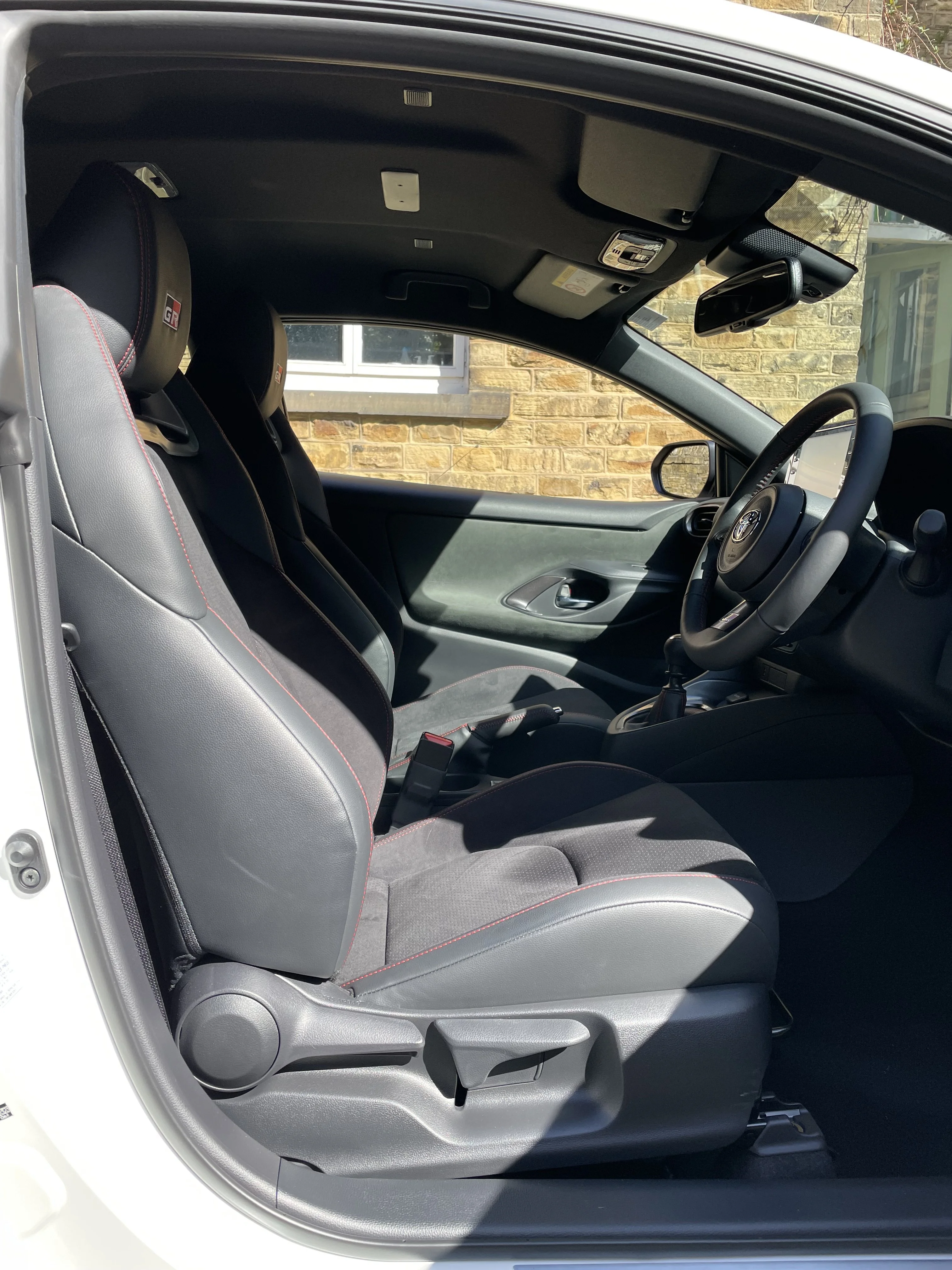

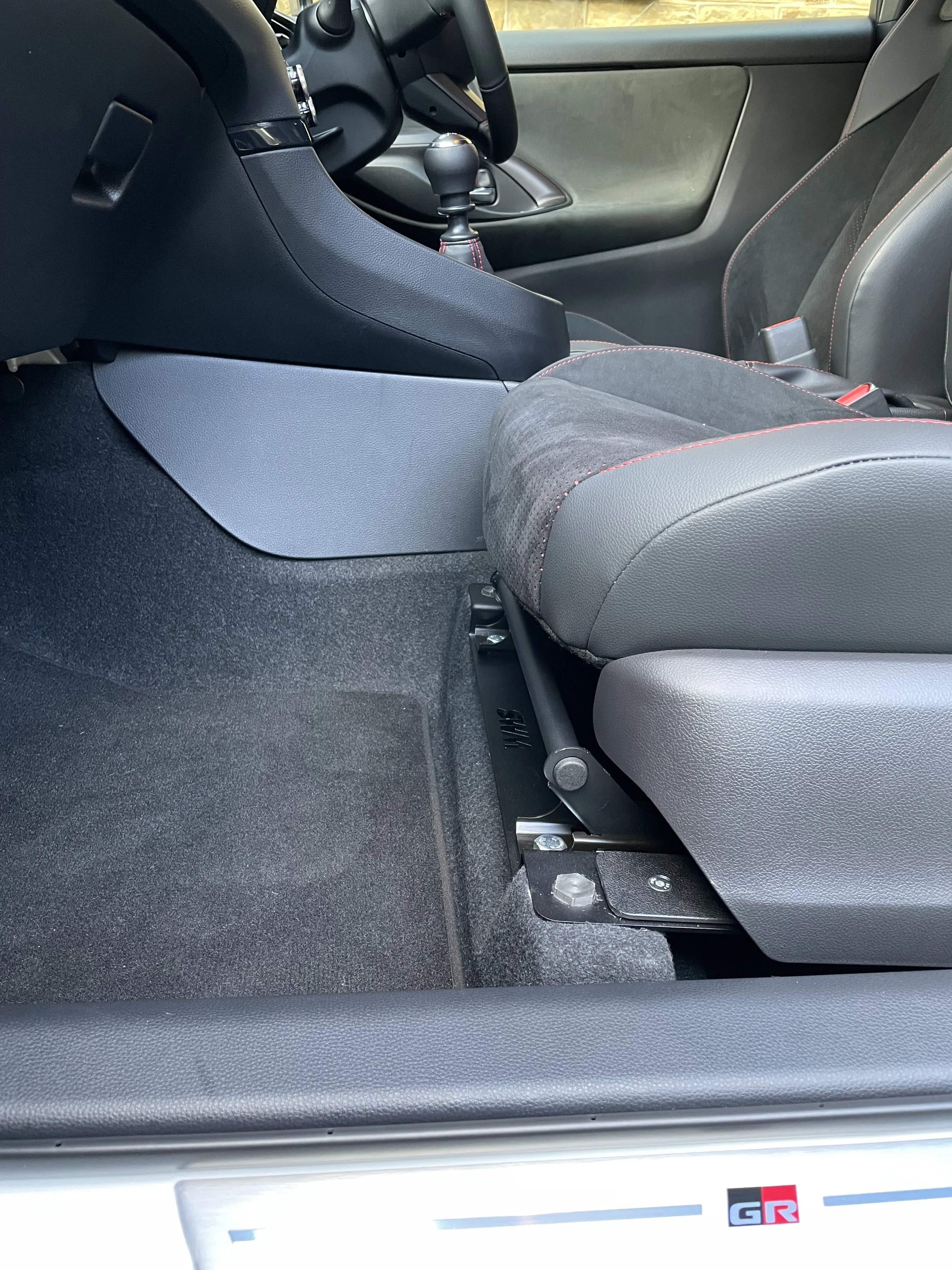

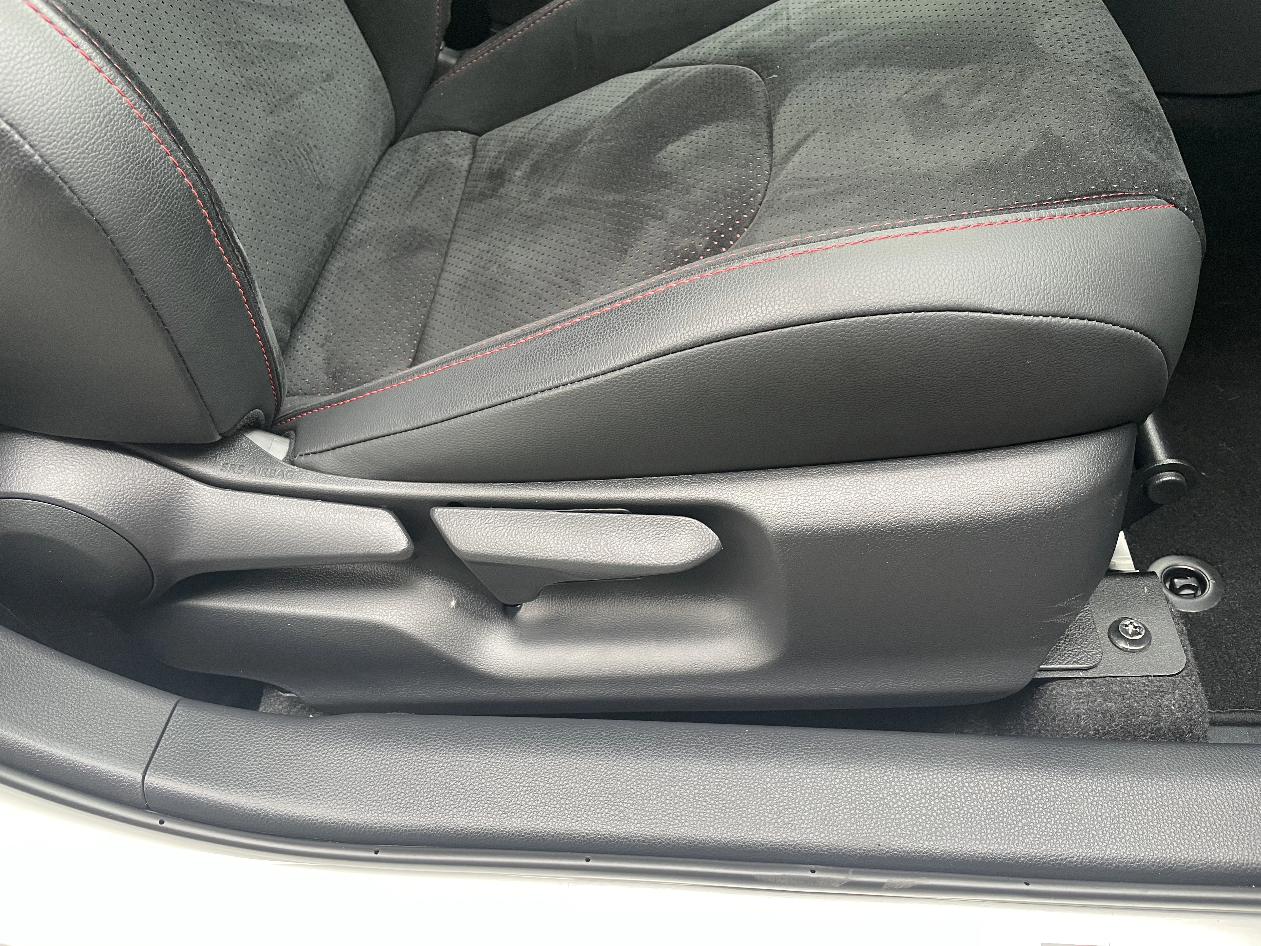

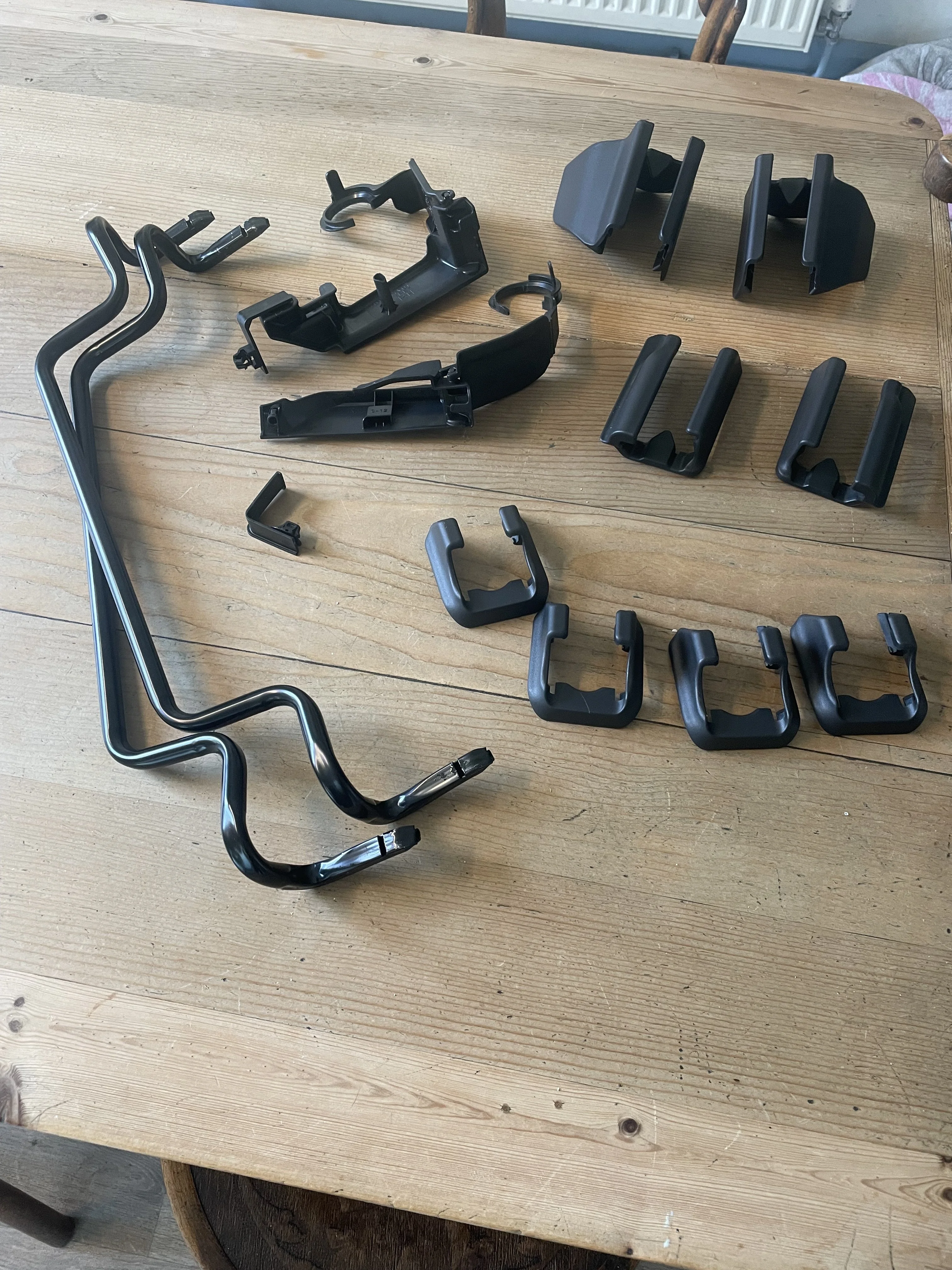

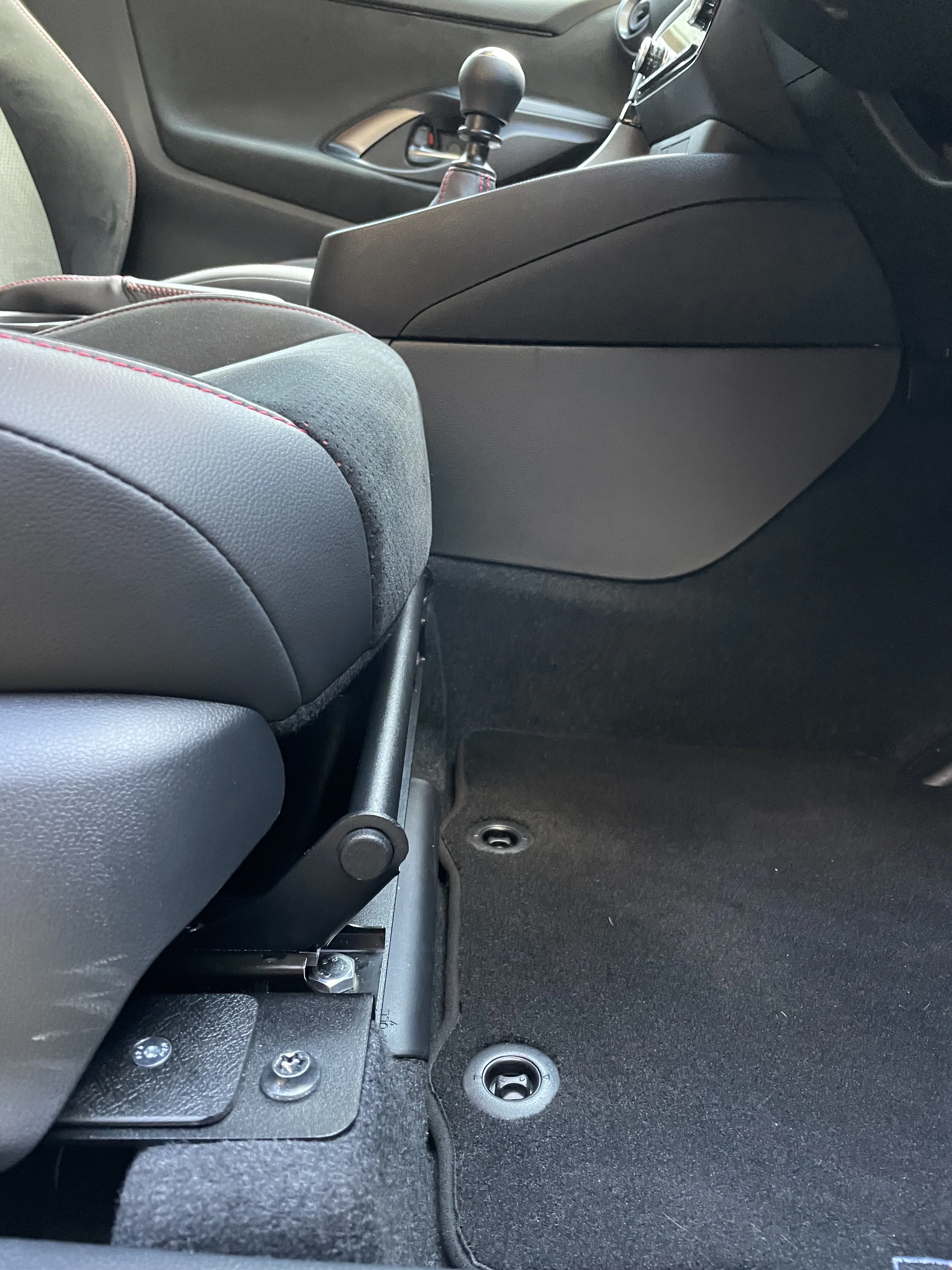

I fitted my SWM front and passenger kits today. Took about 4 hours in all.
Overall I'm chuffed. I wouldn't say it's game changing - it's only about 3cm after all - but definitely a noticeable improvement in driving position for me. Much better for passengers too - puts the passenger seat about where the driver's used to be at its lowest.
Driver's side went really smoothly, no problems at all.
The passenger side was much more fiddly owing to the tilt-slide mechanism. I also had a small tolerance problem on the front left of the upper mounting plate and had to cut a little notch out of it with a hack saw.
No biggie though and overall the kit does what it says on the tin. As others have said, there's superfluous trim afterwards but nothing damaged or cut so can easily go back to OEM.
According to my bathroom scales (that I've always assumed over-read :), 8kg a side excluding the handles and nuts & bolts.

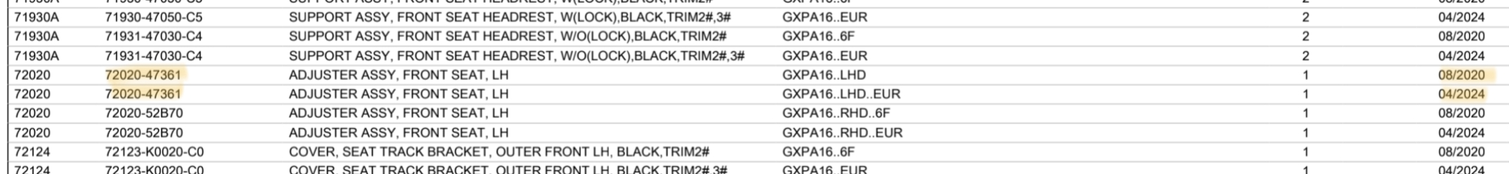

I will call bullshit on that, looking in Microcat it is a seperate part with a seperate code, and before dealer discounts the part costs 558 EUR
part code 72020-47361
it is also same but also different available for some variation

Part Number 72020-47361 seems to be the same for both MK1/MK2 in Microcat.
