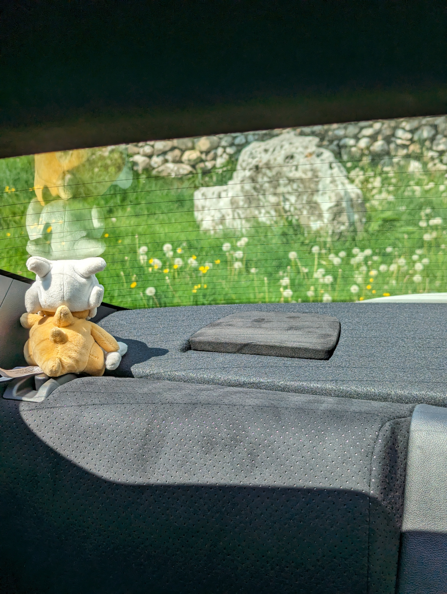

I copied @White_TiGRR today (https://www.gr-zoo.com/threads/pearl-white-grr.8182/post-125395) by getting hold of a roll of the self adhesive suede material from Aliexpress, and covering the plastic covers of the Isofix tethers on the rear parcel shelf. I didn't really notice the reflections on the rear screen until I happened to be without my polarised sunglasses one day, and realised they are quite bad. Covering them should hopefully reduce that.
Bit of a pain to wrap it around the contours, so it's bunched up a bit on the front corners, but it will do for now. I purposefully bought a longer roll knowing I would probably **** it up.
But that meant I could go a bit further; I already had a pre-cut piece that I bought ages ago, fitted around the heated switch surround. Decided I'd have a go at wrapping the little plastic panel under the AC controls, and the bit surrounding the gearstick.....
Quite proud of that. A little less grey, scratchy plastic on show. I am now looking around the interior with narrow eyes, for any other small parts I can wrap. Would quite like to do the A-pillar trim, but they are massive pieces with quite a lot of contours, so maybe that's a job for another day.

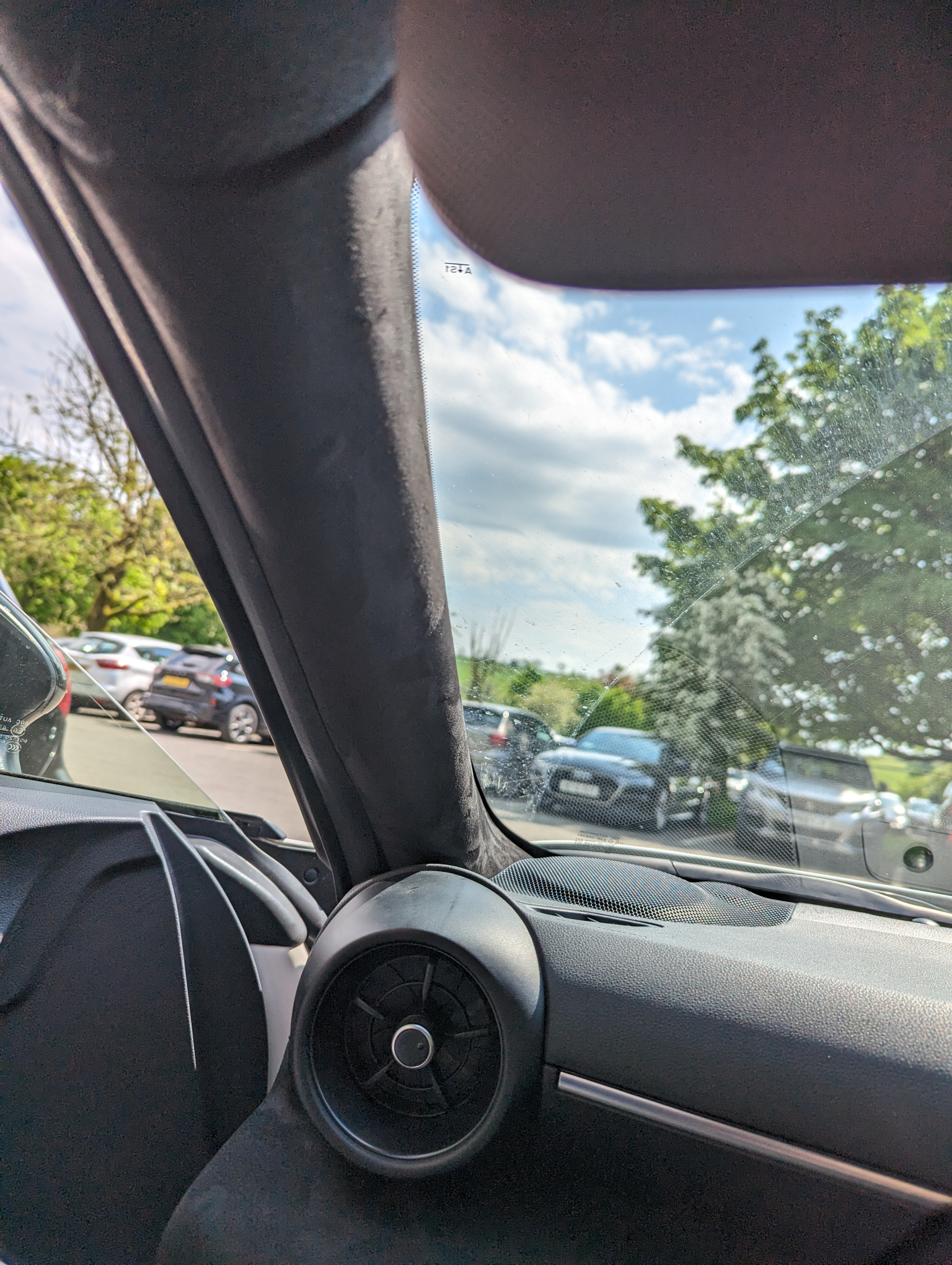

The A pillars are available from AliExpress: https://www.aliexpress.com/item/1005005720088761.html
They definitely help to "lift" the interior IMO.
Reactions: Conscript
Nice, thanks! I need to have one of the A-pillars off again at some point (still searching for that elusive rattle when the car is cold), maybe wrapping them will help alleviate it.

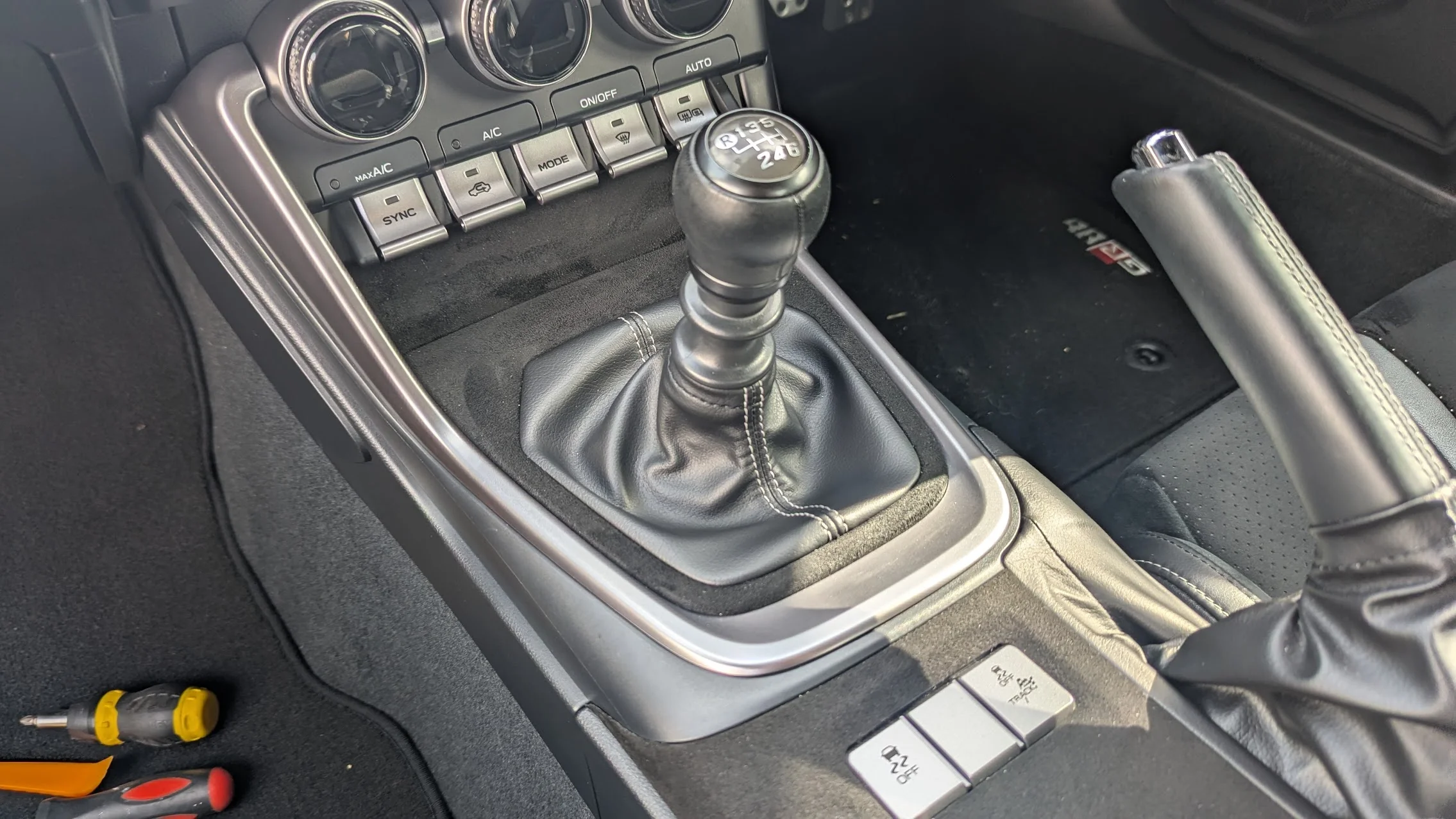

Looks great - I haven't attempted the bit around the gear stick - how did you do it without a template - did you remove the panel, or just cut an approximate size and poke the edges down into the gaps ?
I removed it, it's pretty easy:
1. Prise out the little panel under the HVAC controls and undo the 2 securing screws.
2. Unscrew gearknob.
3. Pull up the handbrake gaiter (no need to remove entirely, just pull it up so it unclips to give you some clearance).
4. Pull the silver bit of trim up and back and it will unclip.
5. You're left with the plastic panel holding the gearstick gaiter. Just pull it up firmly to remove it from the car.
6. Turn it over and there's 4 screws you can undo to remove the leather gaiter.
The roll of material I had was just wide enough (20cm) for the piece, so I just cut off a length long enough for the whole lot and draped it over the panel, sticking it down. Then I just cut around the edges, leaving just enough to tuck it down a bit. Used a Stanley knife to cut out the big middle hole.
Bit fiddly, and it was a bit rough around the edges, but once it's back in the car, the gaiter and surrounding silver trim covers all the edges nicely.

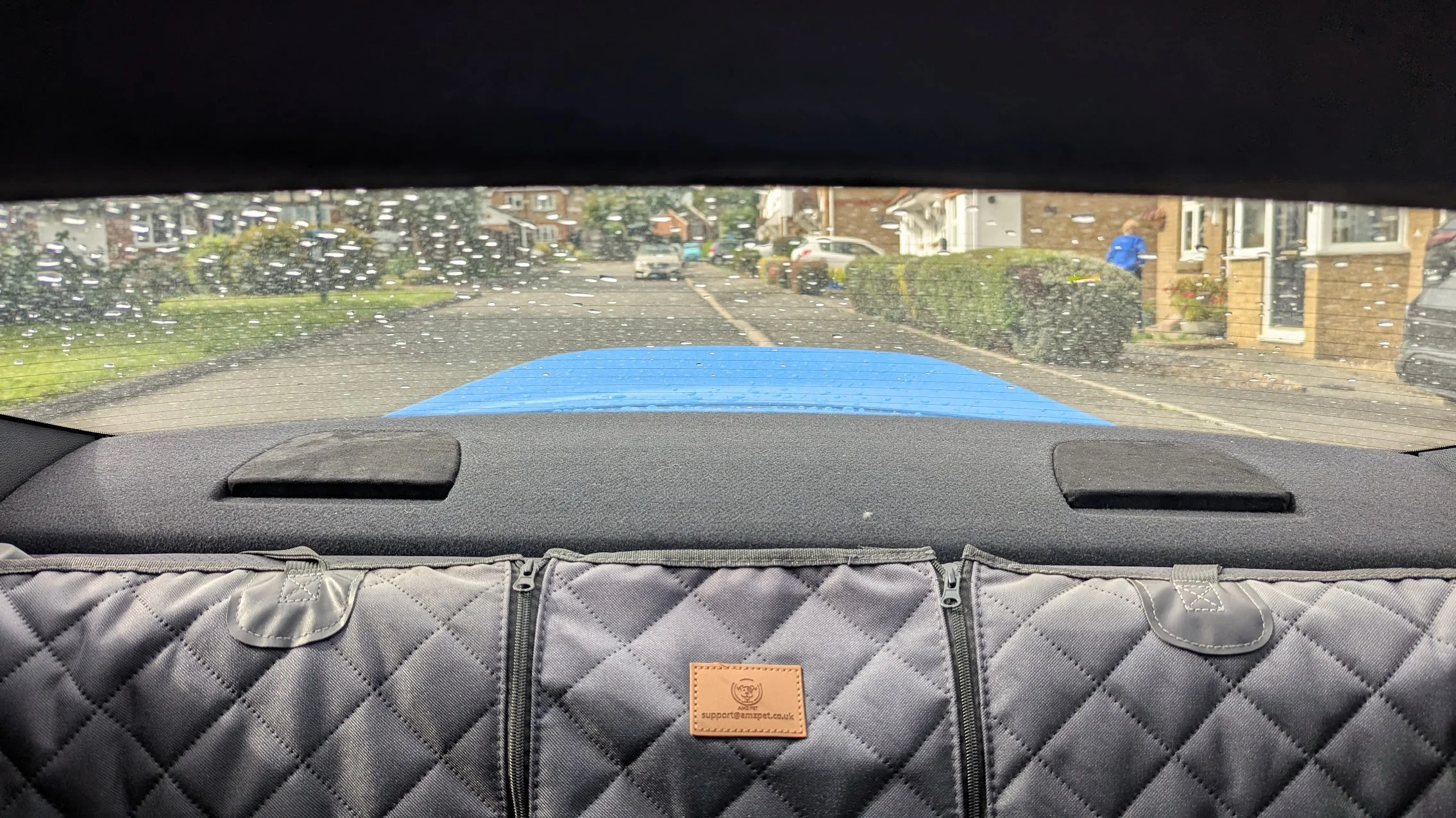

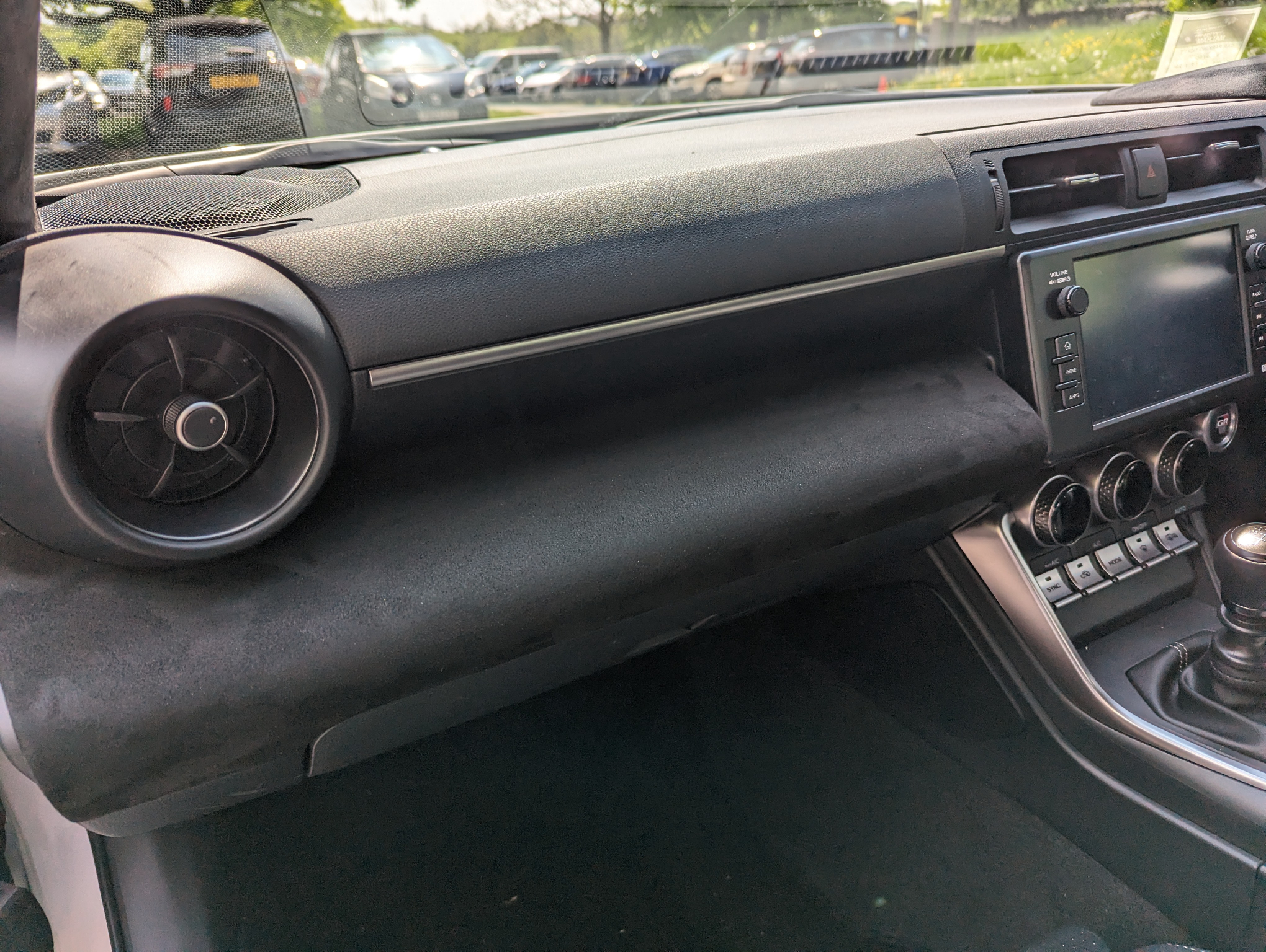

I did the centre console bits, plus the trim above the glove box to mirror the trim you can buy from Toyota in the fake forged carbon effect and I'm pleased with how it came out. Possibly not to everyone's taste, however.
