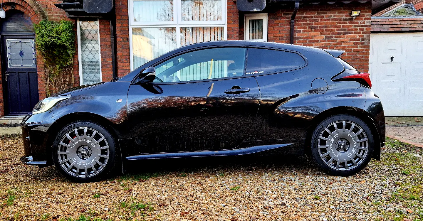

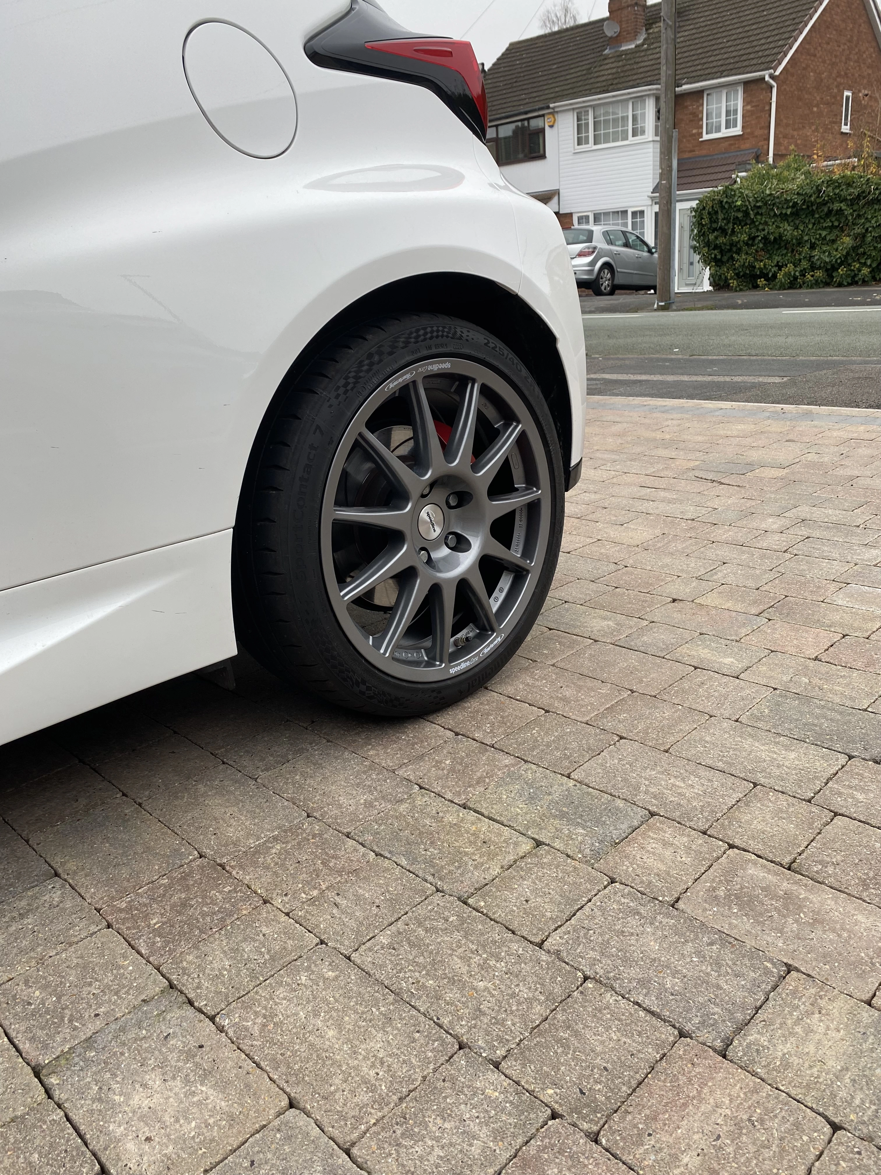

Love TurinisSpeedline Turini deep dish in Anthracite.
18x8 ET35 with 60.1 pre installed metal spigot rings and centre caps.
Worth mentioning that the Speedline supplied nuts have a 6mm extended shank that sit perfectly inside the wheel stud holes.
Also the Toyota TPMS sensors fit and work perfectly.
Big thanks to Simon for his advice and also a big shout out to Matthew at Speedline uk 01952-582825.

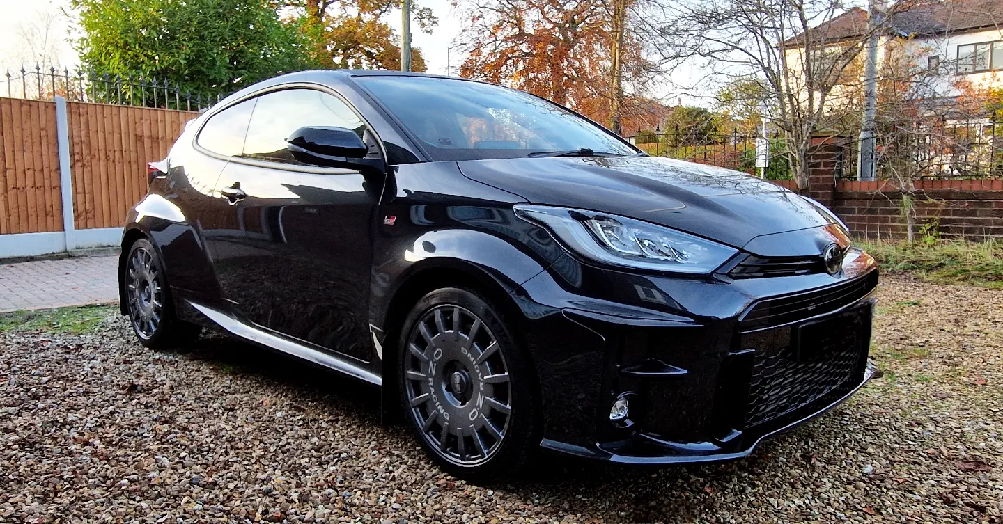

you need to change the value/ id to the new tpms sensors.Hi all, I've bought a used set of OZ rally racing wheels, complete with winter tyres & TPMS. I've fitted to the car today & can't get the TPMS to register, which I was expecting. The TPMS are Aliexpress ones as per the link. Has anyone has any success with them? Ali express TPMS
I'll post a pic of the wheels tomorrow in the daylight as it was getting dark by the time I got them on.

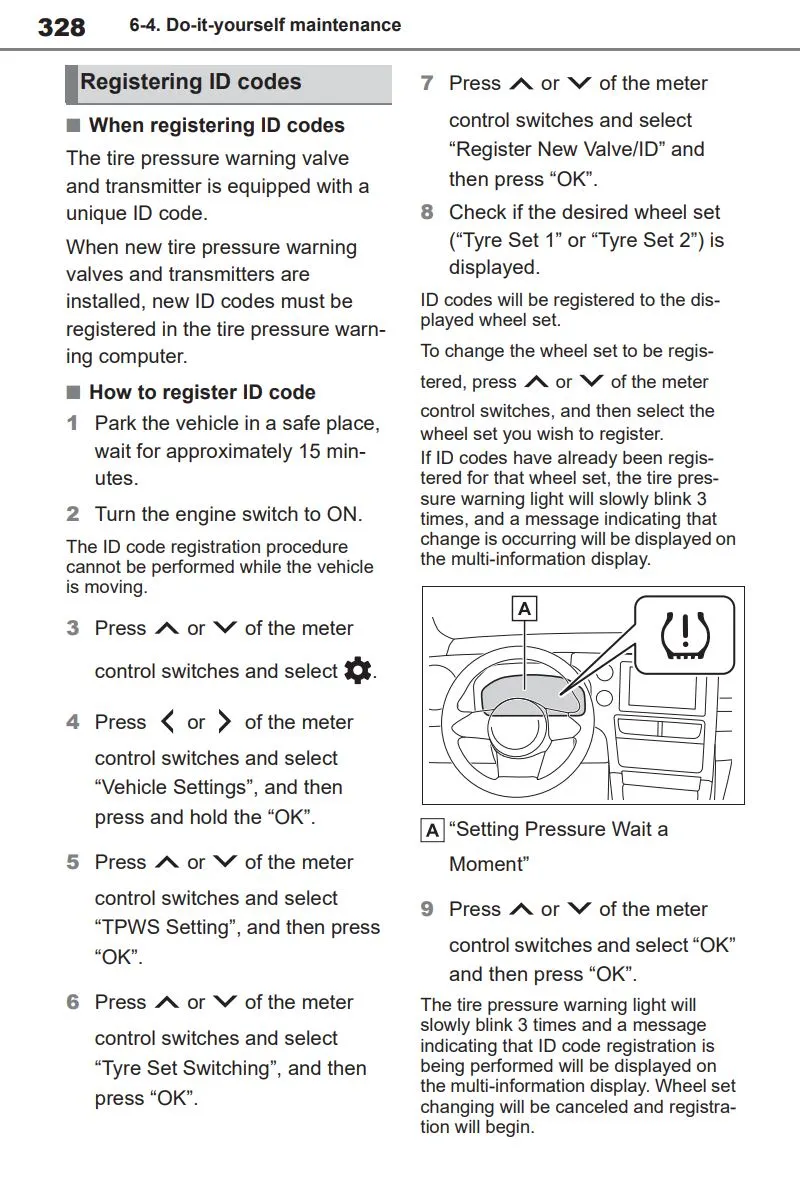

Have you tried to register ID codes via settings menu? I'm using same sensors on my MK1 and it took 10-15 minutes of driving after I initiated "Identifying Each Wheel & Position".Hi all, I've bought a used set of OZ rally racing wheels, complete with winter tyres & TPMS. I've fitted to the car today & can't get the TPMS to register, which I was expecting. The TPMS are Aliexpress ones as per the link. Has anyone has any success with them? Ali express TPMS
I’m having the same issue with Autec valves. The TPMS will need waking from a garage.Have you tried to register ID codes via settings menu? I'm using same sensors on my MK1 and it took 10-15 minutes of driving after I initiated "Identifying Each Wheel & Position".
edit: seems it's called “Register New Valve/ID” on MK2.
Doesn’t really help you, but I have these exact ones and one day they just decided to pair. It was about 2-3 drives after fitting them and trying to go through the options that they did it. So possibly need waking up from a deep sleep mode or something like that.Hi all, I've bought a used set of OZ rally racing wheels, complete with winter tyres & TPMS. I've fitted to the car today & can't get the TPMS to register, which I was expecting. The TPMS are Aliexpress ones as per the link. Has anyone has any success with them? Ali express TPMS

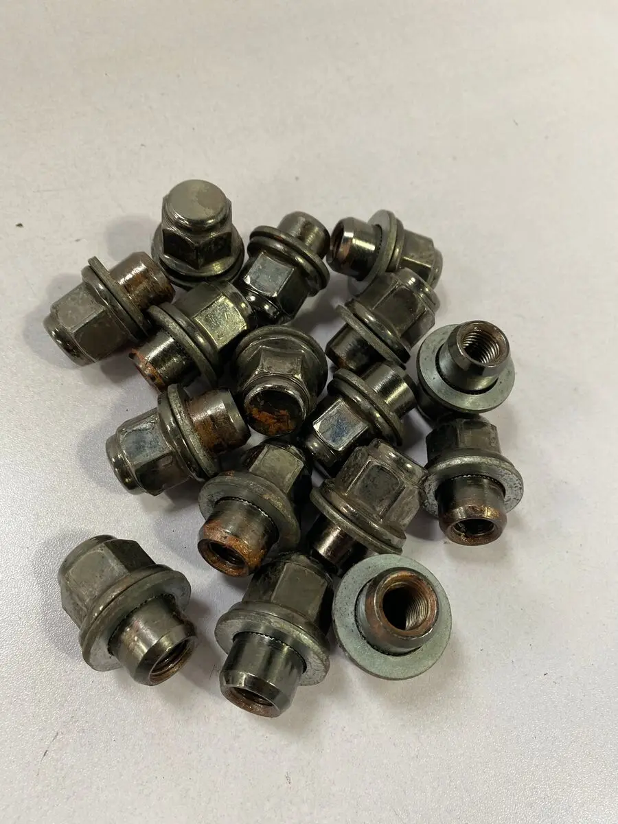

From what I could find after some small research, this is what the original ones look like:Aftermarket wheels almost always have 60° taper, do the GRY ones come with a taper or ball seat?
You've reminded me that I need to advertise and shift on my wheel nut stock at a heavily discounted rate to free up room, doesn't matter how attractive the pricing is, nobody seems to be interested.
Ordered a set of nuts at Giva Wheels (NL) who also sell the OZ Rally set like I have, as I don't think the original ones fit the OZ
Just a note on that. This can be a REAL PAIN IN THE ASS.Have you tried to register ID codes via settings menu? I'm using same sensors on my MK1 and it took 10-15 minutes of driving after I initiated "Identifying Each Wheel & Position".
