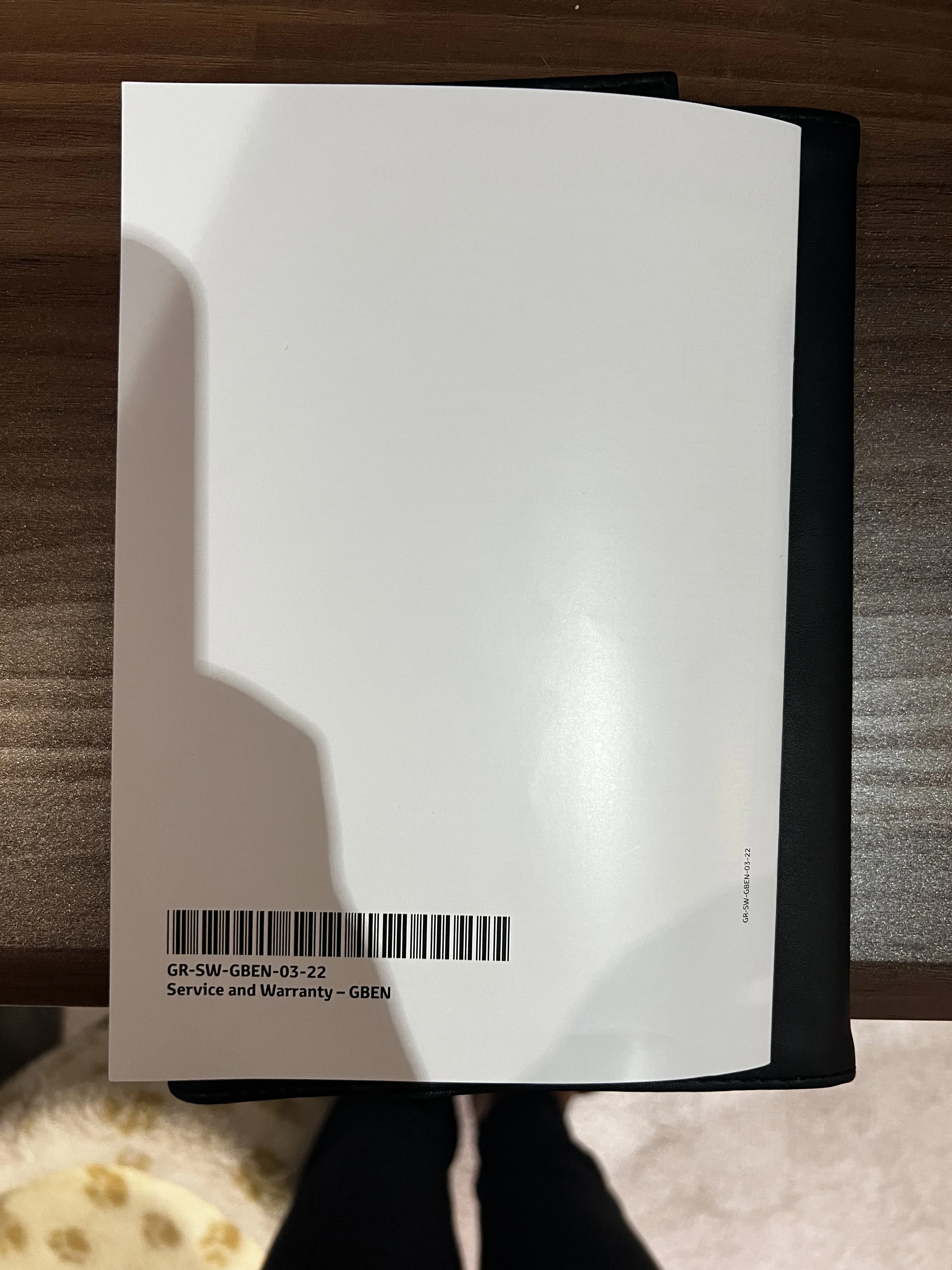

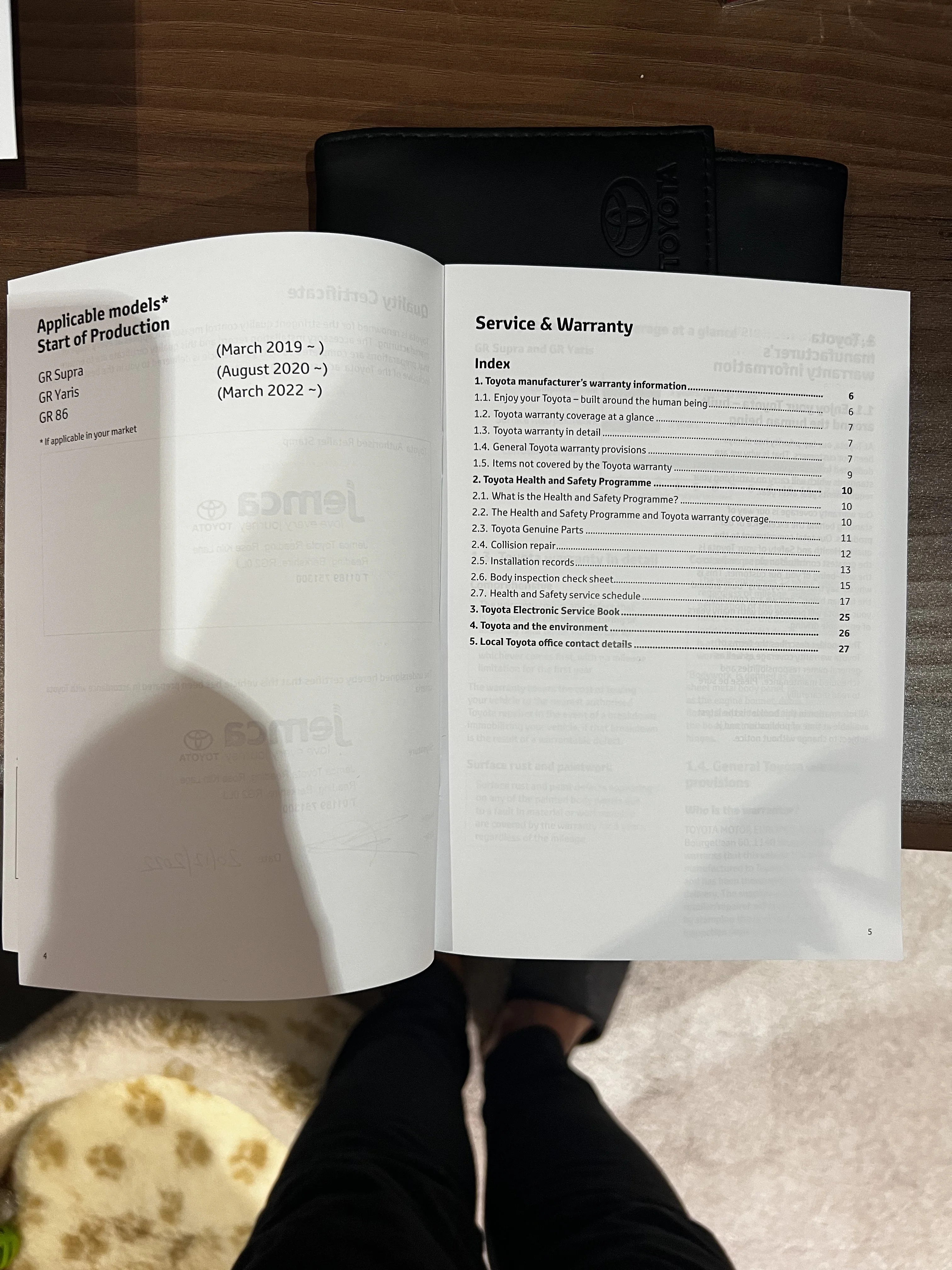

I got a service book - pics attached. I think it is specific for the GR models as it has the information for the Supra and Yaris as well as the GR86. There is information about additional replacement intervals.
There is a part number on the back of the book so hopefully people can get them.
Spark plugs every 6 years
Air filter 3 years
Fuel filter 8 years
Air filter 3 years
Fuel filter 8 yearsView attachment 11919View attachment 11920View attachment 11921View attachment 11923View attachment 11924View attachment 11925

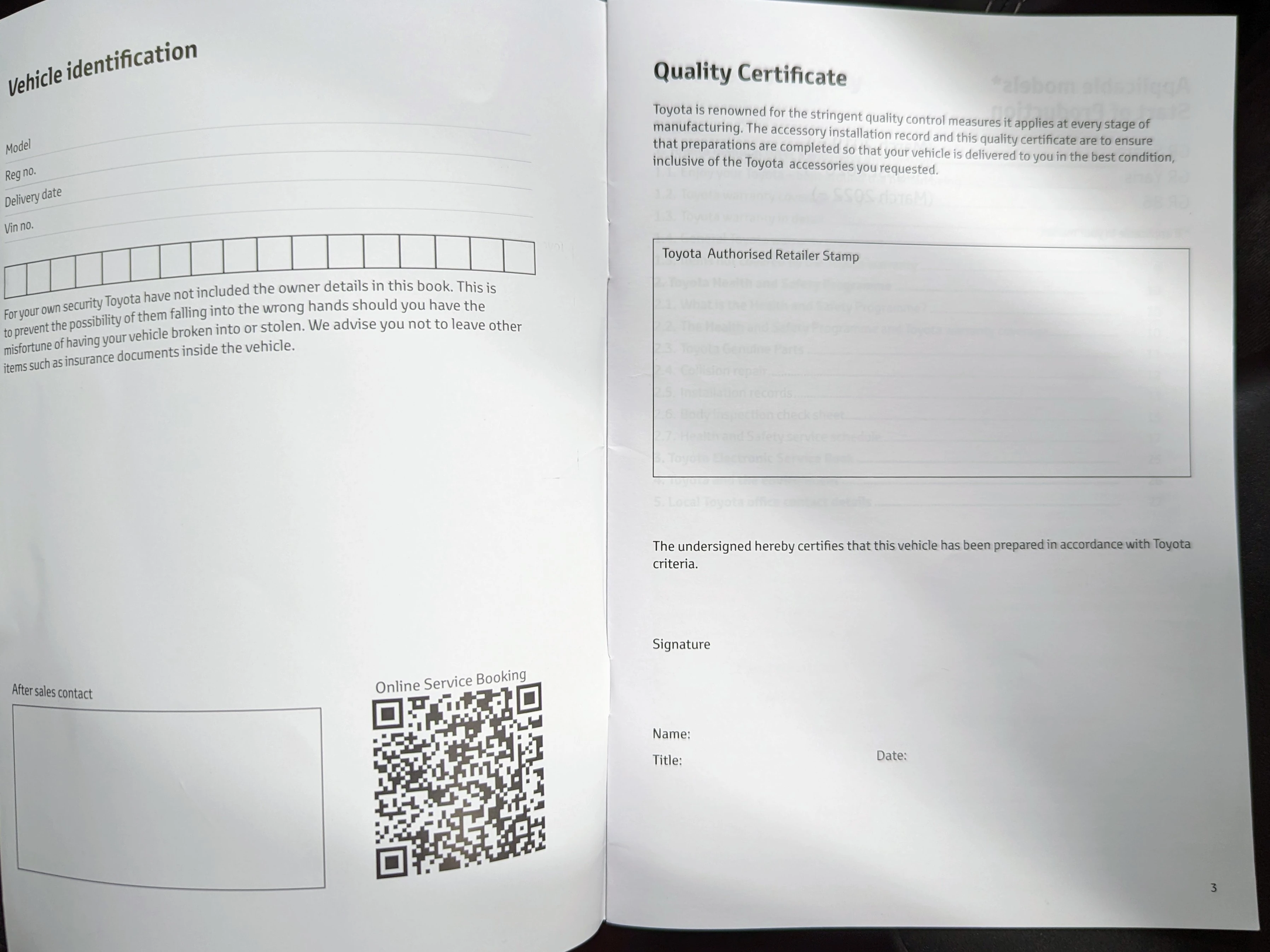

...checks glovebox... well there's another thing they couldn't be bothered to do properly! Mine is totally blank 🤦‍♂️
So was mine. Book was still in the wrapper so I filled out the info myself when I got home.
To be fair, I did rush the handover due to all the delays. Probably why I didn't get the toy and key box either, I just took the keys, signed the digital form thing and drove off :D
