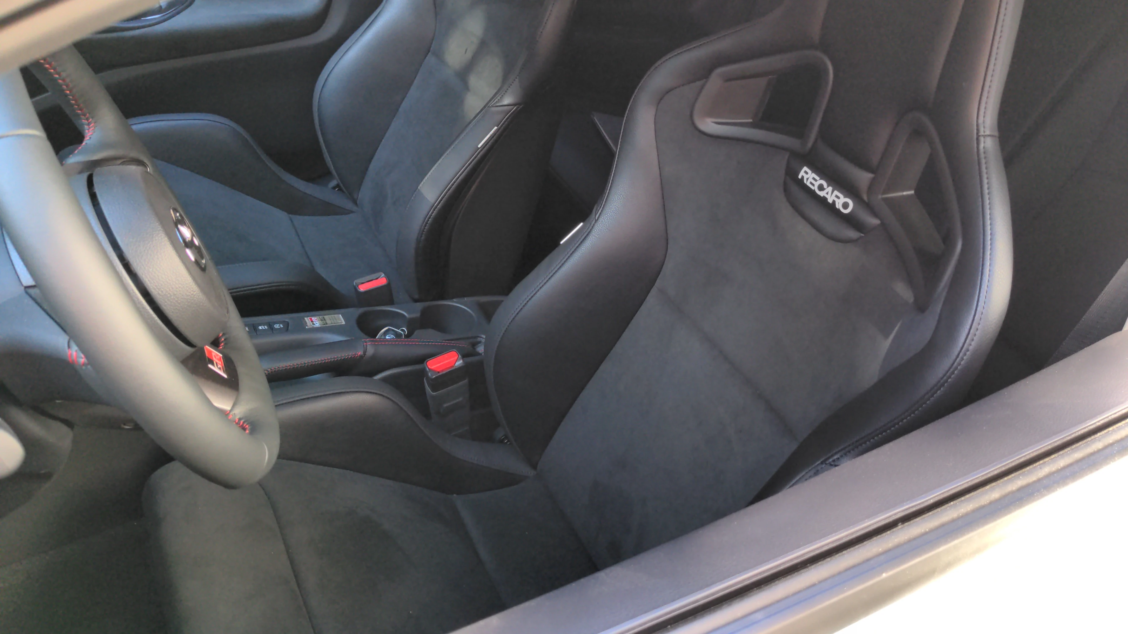

finally. Airbag, seat heating, rails...close to stock...and a huge gain of around 6,5 cm
I used original Recaro rails on the Schläppi console.

if one could live without rails, you could gain another 3 cm.

The seating position was an issue before I tested the GRY, based on reviews. I did, however, find it to be really good and with good visability (after I got the mirror raisor) on Norwegian narrow and twisty B-roads. During the winter I did a number of icetrack-days and had to compromise the seating position to make room for the helmet. So I’ve just ordered the DNA seat lowering kit. 3 cm down should be just right.
Having fitted the DNA kit for the drivers side (I thought I bought both sides…) I’m really pleased. The seating position is now pretty much perfect. Still high enough for great vision, and low enough for feeling «right». And having gotten much better vision between MM-unit and mirror, which no longer is an issue. I am 6.0 / 184 cm and now have a bit over 3 inches / 8.5 cm head clearance, and 1.5 / 4 cm clearance with the helmet on. Without having to tilt the seat a bit to far, as I’ved had to do previously. The mounting eas a bit fiddly due to poor instruction, but with the help from JBCTRs video it went fairly well after a few trail and errors. Probably the best 300+ Euros you can spend on the car (apart from a few tanks of fuel).
