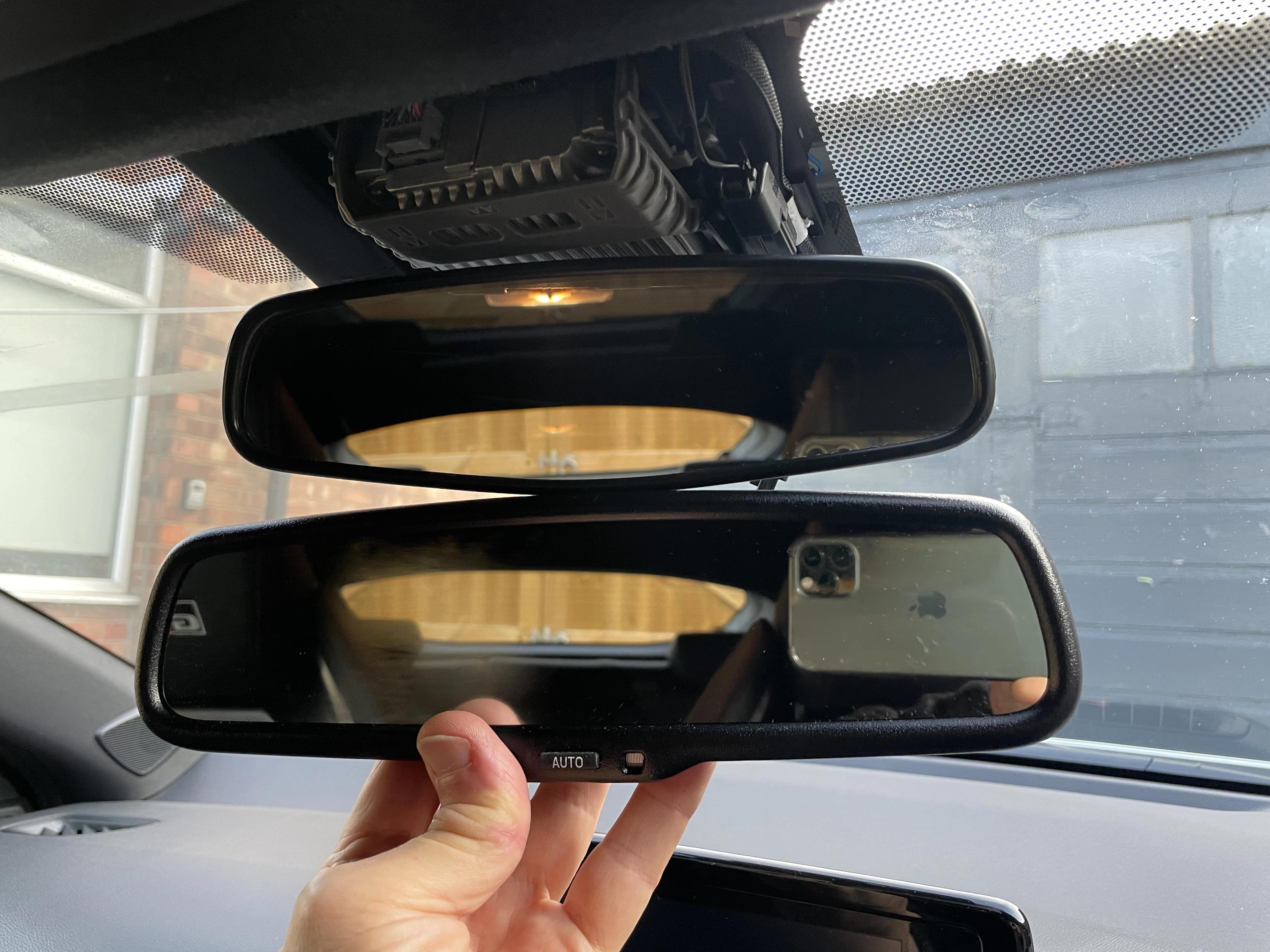

Got this off Marketplace, £8. Astra model ‘J’ manually dipping, 22 x 6cm. Works great, opens up the windscreen but does restrict the rear distance view a bit. Blame the rear roofline for that, the reason for the massive low original in the first place!
Can touch the camera case without filing anything. Not tried to put the trim on and maybe won’t fit? But visibility is more important to me than cosmetics.
Not a fan of Auto dipping after my first and only migraine last year (In another car) driving at night. I’m blaming those ‘flipping’ SUV xenons!
Good work, I managed to find a manual one from a Toyota Aygo.
Works well and opens the screen up nicely but there’s no way the trim will go back on unless you cut a slot in it 🤷‍♂️.
View attachment 9986View attachment 9987View attachment 9988
I looked at many different options but thought all the Toyota mirrors although narrower had too much depth. The Astra ‘J’ has less depth and tapering ends which increases visibility too.
But anything is better than the ‘barn door’ original!

I fitted an Astra J this morning literally a 5 minute job, original trim all back in place I must say it's a big improvement, interestingly the mirror blind spot using the OEM mirror caused me to miss a mobile police finance van the other day, just sat in that spot a ways up the road - hopefully saw it in time but not optimistic :rolleyes:

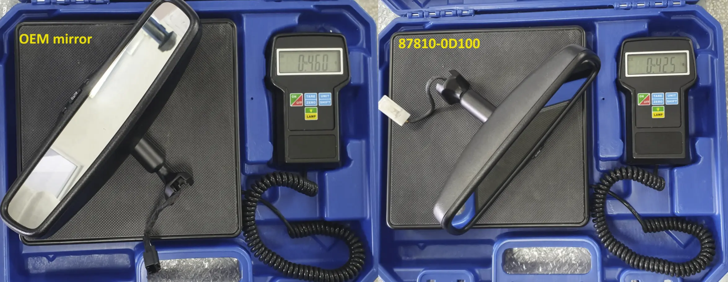

This page ( https://www.toyodiy.com/parts/p_E_201801_TOYOTA_YARIS (HYBRID)_NHP130L-CHXNBW_8701.2.html ) gives a little different info :
87810MIRROR ASSY, INNER REAR VIEW
87810-0D080PRE-COLLISION SYSTEM-WITHOUT&LIGHT CONTROL SYSTEM-WITH(*ALC & AUTO OFF & FOLLOW ME HOME)1
87810-0D100LIGHT CONTROL SYSTEM-WITH(*ALC & AUTO OFF & FOLLOW ME HOME)1
Can anyone confirm D100 is with pre-collision support ?
Thank you for highlighting this, I guess the implication here is that installing a mirror other than stock (or the D080 potentially) above means loosing the Pre-Collision System functionality...
