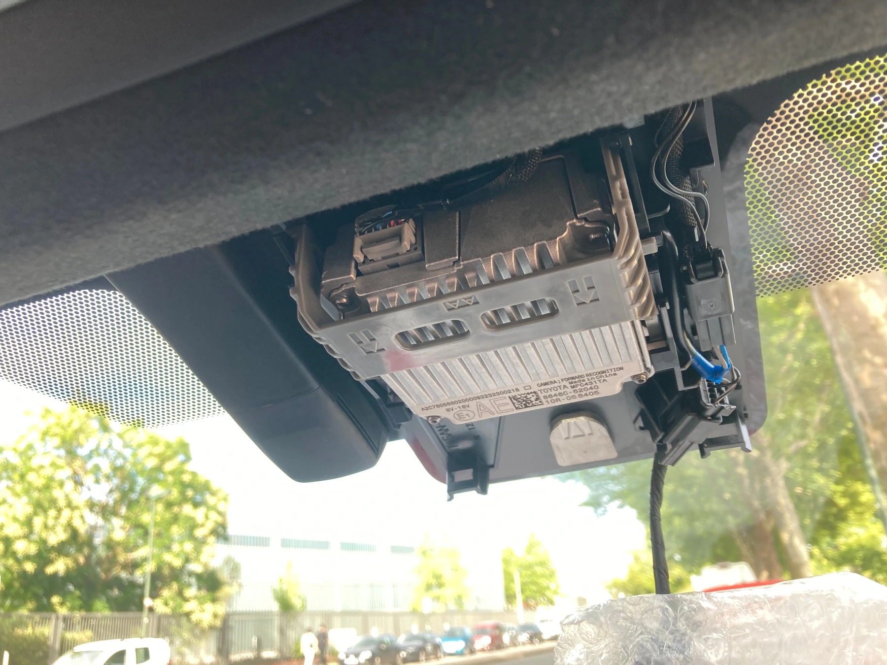

The two part numbers are interesting BUT I'm running an AstraJ mirror basic manual dimmer version no electronics and my pre-collision system is working fine, no warning messages or codes. I assume those part numbers are for the bits installed in the roof?
Those part numbers are for the rear view mirror unit that plugs in the box in the room. I guess it means that in the GR Yaris the pre collision system is in the box mounted in the windscreen, while on older Yarises the function was potentially in the mirror.
