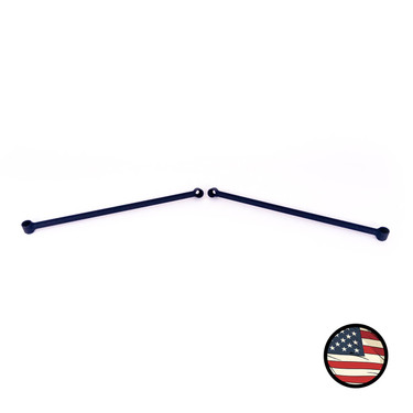

Has anyone tried these?

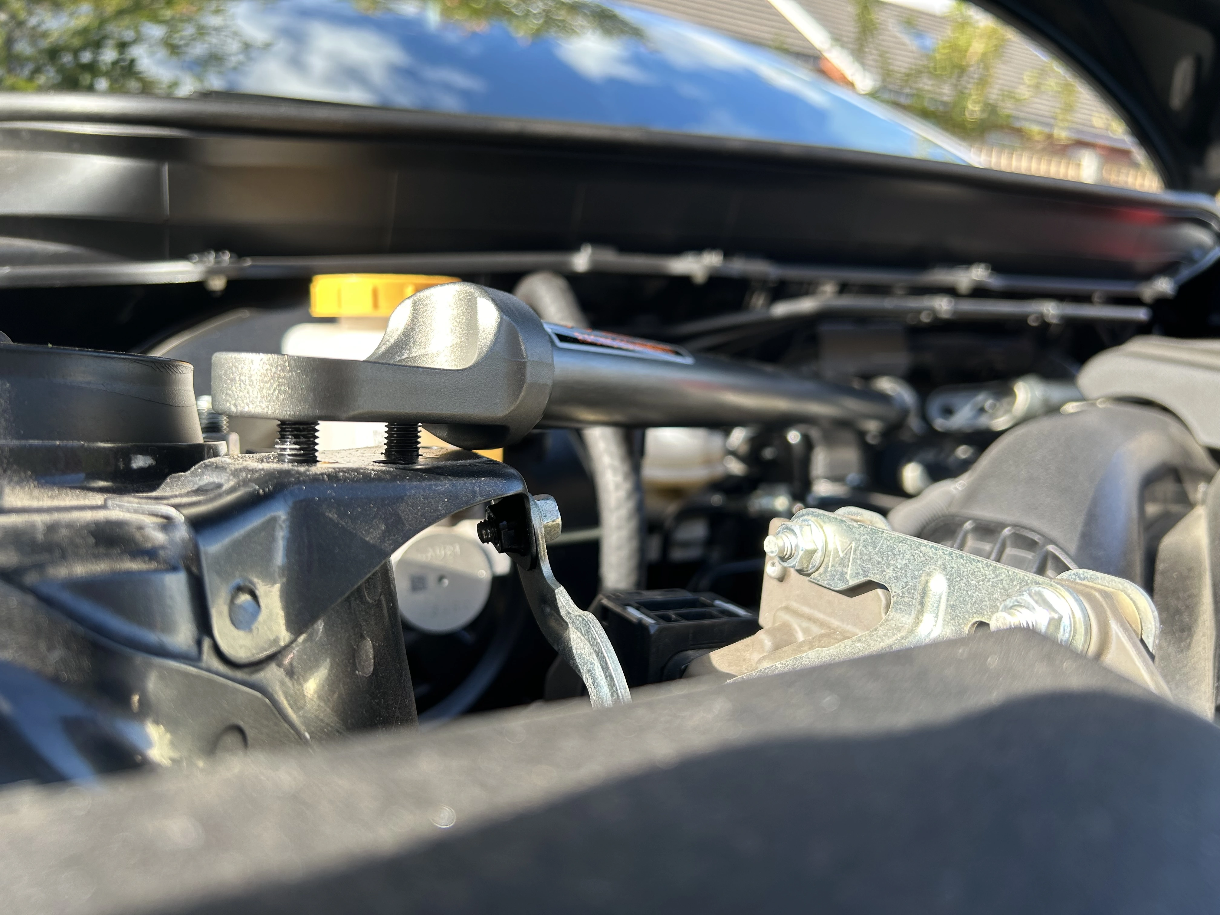

Just received a pair of the summit braces, and they don't fit.
I suspect the GR86 was added to the fitment list because the mounting holes are the same as the GT, but the "collars" interfere with the larger mounting plate on the GR and prevent them from sitting flush. Sent an email to fensport to see if they have any ideas, but I suspect I'll have to return them, or grind the collars flat.
That's not good 😠
Fensport are usually brilliant, I'm sure they'll take them back and refund you no questions asked, given that they've listed them as compatible.
