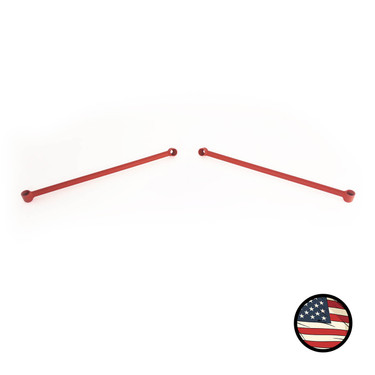

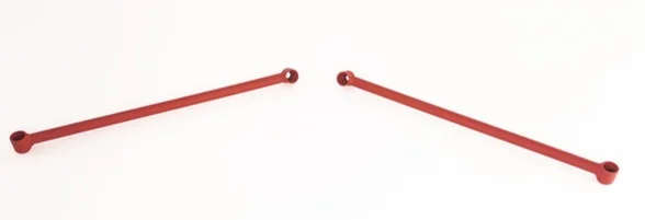

There's a couple of new products to keep an eye on.
'Nameless' v bars,
Eliminate road noise and stiffen up your '22+ BRZ/GR86 with these red firewall V-braces. Reduce flex and increase grip and hear your engine, not the road.
shop.namelessperformance.com
YouTuber, Mike Roadway has been reviewing these and other things he's tried, also posting on GR86.org
He says the noise is similar to having no v bars fitted, but the handling restored to stock.
-post 556 onwards.

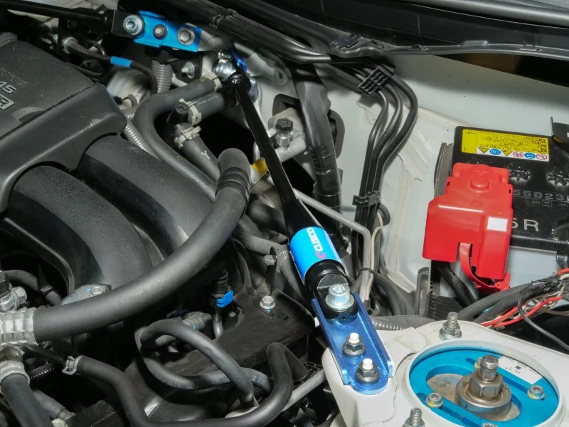

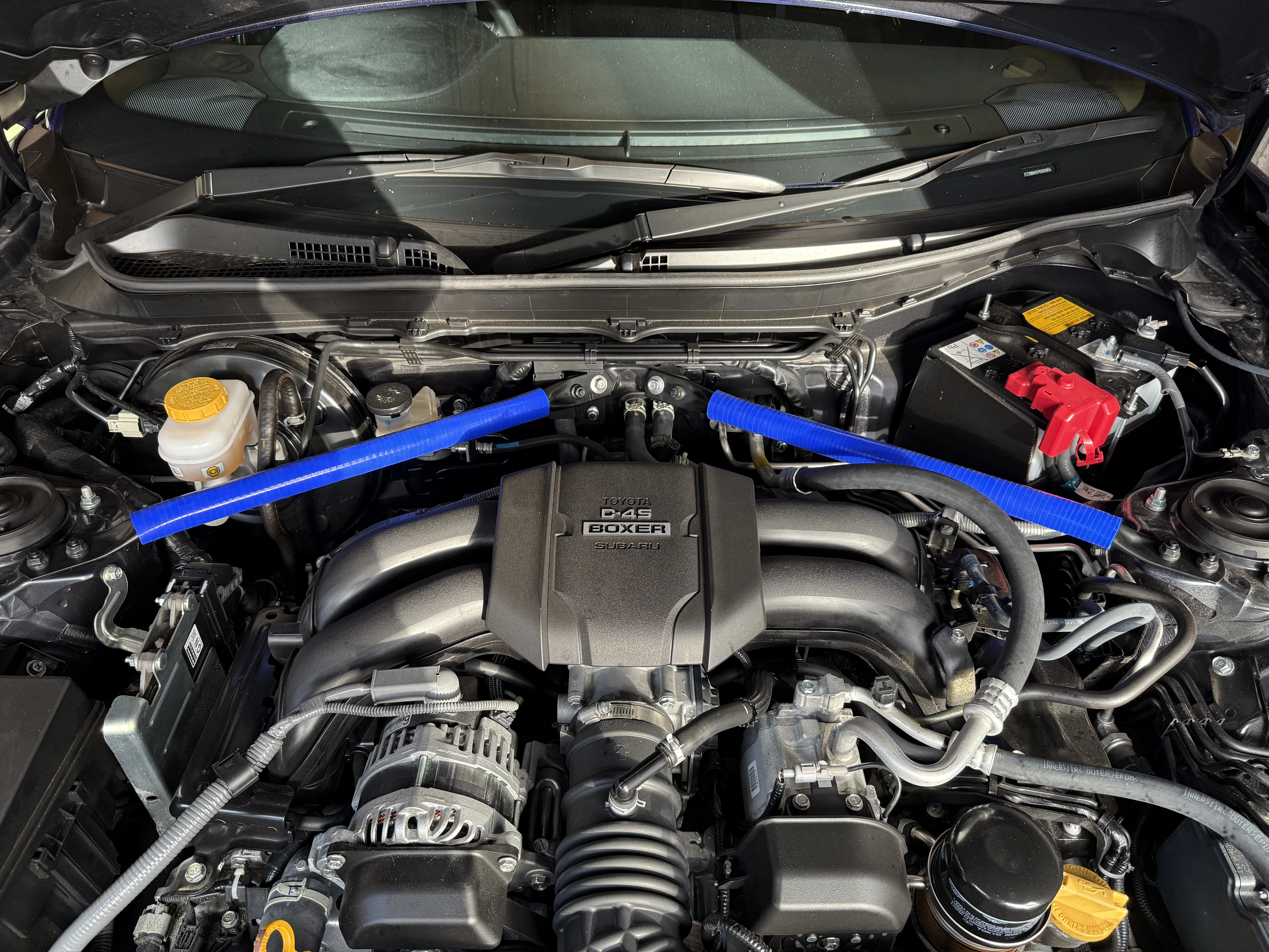

Cusco have some new products, including damped v bars.
Whether they are any more effective than the TRD/GR/Yamaha dampers or the STi 'pillow ball' bars remains to be seen.

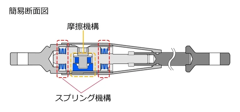

The Cusco damper is disc springs in a tube, with a nylon friction damper.

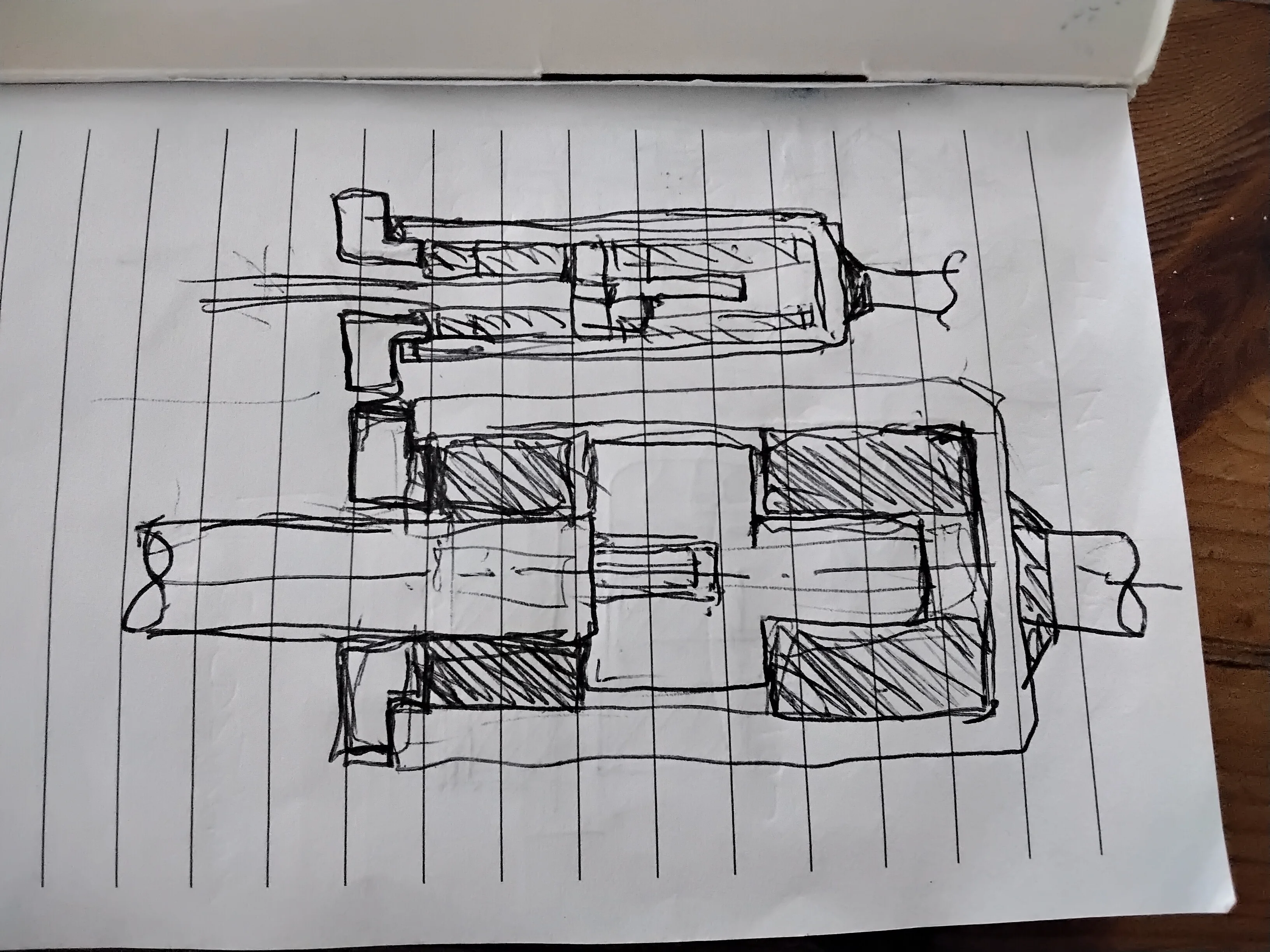

It looks similar to something I sketched up a year ago, but never made a prototype. Preloaded polyurethane bushes in a tube providing the spring and damper action.
