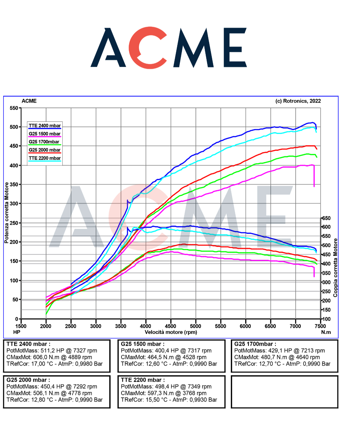

Just in case you missed the dyno sheet from our trip to @acme_racing_official.
Over 500hp and 600Nm with the @theturboengineers new TTE570+ Turbokit on our built engine from @7mod.official
As you can see the response is MUCH better. It delivers more power, much earlier than our previous G25 Kit.
Yes, it doesn‘t have the top end potential of the G25 Kit, but 500hp will be plenty enough to test the durability of our parts and especially the OEM differentials. 😅
It is an absolute amazing Engine and Turbokit. Revs like hell and runs absolutely perfect.
Plus the @kotoucgearboxes 7-speed gearbox delivers as always…

Nice figures! do you know if there's big difference in back pressures with each system?
Some hybrids have had this issue, but as they're custom systems its hard to generalize.
Not bad. Just at 2.2 bar you reacht the sweet spot and 2.4 bar is the limit of the exhaust housing.
